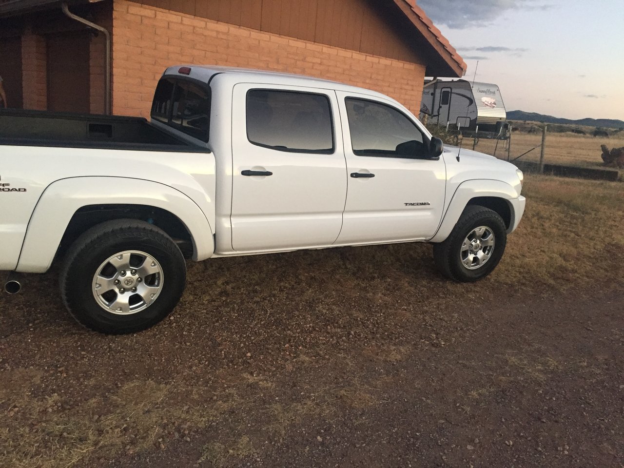

    So I'm a complete newbie to adding things to trucks, and I've been asking around and it seems that a lift is a good first mod, as well as tires.
    What is a good lift for a reasonable price? I'm looking for 2-3 inches, nothing major as it's my daily driver but I wanna do off roading. The lift is gonna be installed by either a shop or someone who has done it before so I'm not asking for mechanical advice, just what parts would be a good buy.
    Thanks in advance!
    Here is my current ride height (I'm assuming it's stock TRD OR suspension but I bought it used at 170k miles so who knows):
    P.s. I've heard good things about old man emu?

    What kind of budget are you working with? Are we talking less than $500 or could you employ a little wiggle room for some good components?

    Less than 500$ would be preferable, but I would spend extra since it's what's keeping my truck off of the ground.

    Well I can get into all kinds of options on here, but I highly recommend that you give Marie @HeadStrong Off-Road a call and go through the options with her. Has out what you will actually be using the truck for, etc. Also, I have Old Man Emu and I cannot recommend it. It is decent, but my truck rides like a brick on a skateboard. If you are going cheaper I say get Bilsteins. If you are going higher quality just go Fox,King, etc.

    The “standard” tw approved lift seems to be ome coils (either 884,885,886, or 887’s) on bilstein 5100’s for the front, and either an add a leaf/leaf pack or Dakar springs with 5100’s in the rear. Depending on the tire size you choose, you may need aftermarket upper control arms. With 265/75-16’s you should be fine but with 255/85-16’s or 285/75-16’s you will likely need them. Spc light racing arms are the most economical/most popular ones you will find. With 285/75-16 tires you will need to trim some plastic/remove front mud flaps and possibly do a cab mount chop. You will get driveline vibrations, there is much debate on this but no end all solution that I have found. You do not need a carrier bearing drop kit nor do you need a front diff drop kit. Headstrong off road can help you with everything you will need. If you are new to suspension and new to Tacomas you are in for a wild ride, but take your time and pick what suits your needs :thumbsup:
