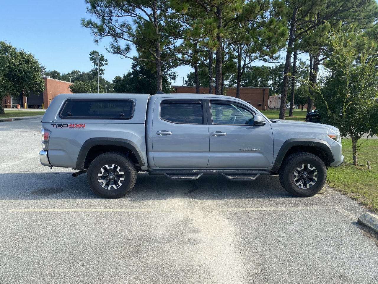

    I have a 2020 TRD Off Road with a camper shell - all stock. It squats a little in the rear with just the camper. When I'm pulling my small boat or utility trailer it squats several inches. Both are about 2000lbs with less than 200lbs of tongue weight.
    What would you suggest to keep the ride closer to level or slightly raked under normal conditions and while pulling a load? I will keep stock tires and rims for now. I'm not looking for a lift but a small lift would be acceptable.
    Thanks ahead for any info.
