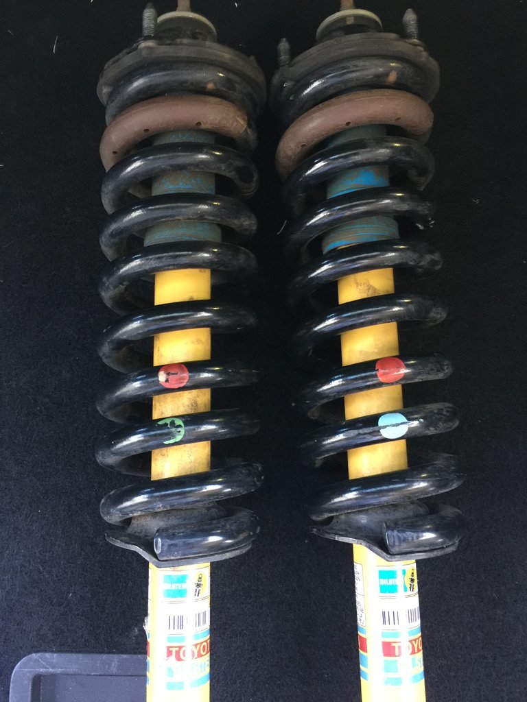

    I was looking at the Bilsteins coilovers and shocks off of a 2016 ORDC i just picked up but it isnt marked which one is the driver or pass side. I dont think the rears make a difference, but i think the fronts may. One has red and blue dots the other has red and green dots on the coils. I have attached a photo of the fronts. Does anyone know which is which? Thanks.IMG_4466.jpg
