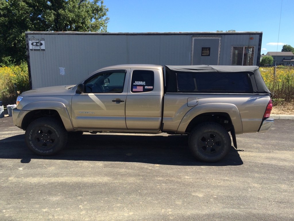

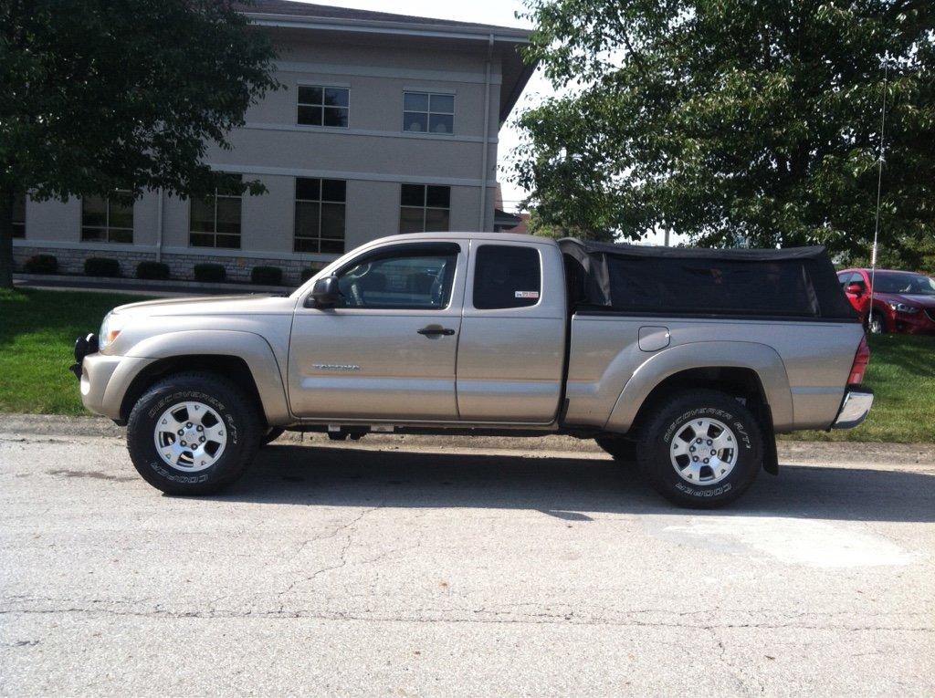

    I put a 1/4 in spacer on the front drivers side to fix my "taco" lean. Other than that you shouldn't need any top spacers. As far as wheel spacers or new rims that is up to you..you shouldn't need any unless you want to put your wheels put of the wheel well and give your truck some stance
    Before lift:
    After lift:
