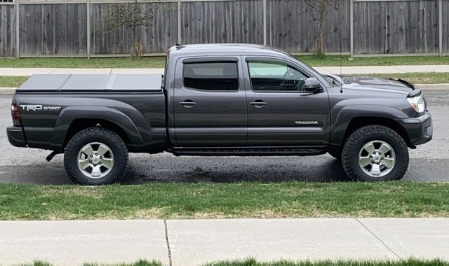

    So I ended up using the Billy’s up front set at 1.75” and picked up some 285/70R17’s Load Range C BFG’s as they were on sale instead of the Falken’s. The truck now sits nice and level and it is roughly 1/4” higher at the rear. Love the look, and only minimal rubbing with the mud flaps removed. I don’t do much off road, just cottage roads and hauling a seadoo. I’m also running 1.25” spidertrax spacers to accommodate the stock wheels for now.

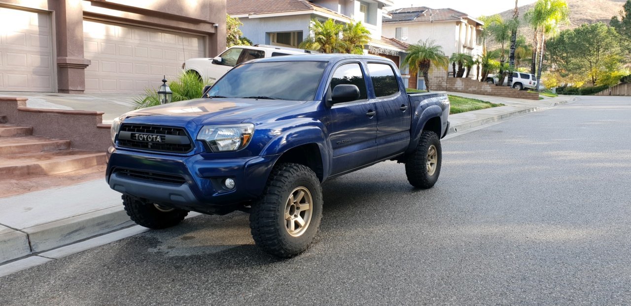

    Nice set up! i have 5100s all around, toytec coils and aal on the rear. I dont really take it to the trails as much as id like, but its been pretty good daily driving it:thumbsup:145.jpg

    love the rims, that gold/bronze looks great on a blue truck :thumbsup:

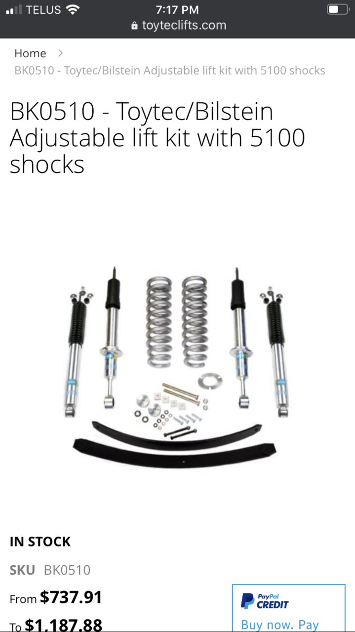

    Jeff
    2009 DCLB
    Hey @J_llera95 that is the same left I’ve been hunting for! Any idea if this is the package u went with? Thanks!96BB70B8-54AE-4FCF-B5BA-B0B995AE725C.jpg
