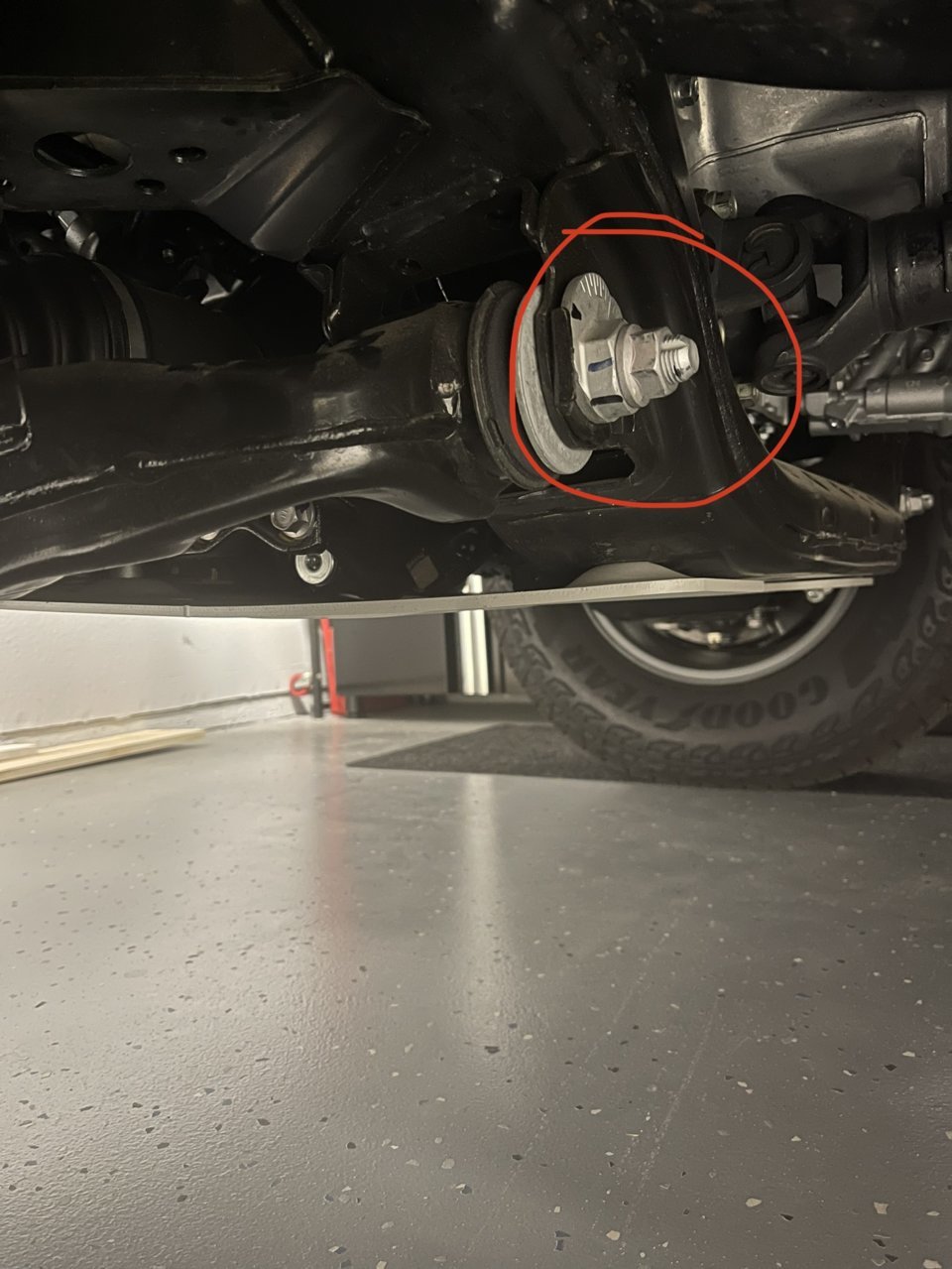

    I keep finding contradicting information of the torque specs for the lower control arm bolts. Can someone confirm. Is it 100 or 155 ft lbs for a 3rd gen Tacoma 4x4? See pic for clarification on the bolt I’m talking about. 155 ft lbs seems like overkill to me.

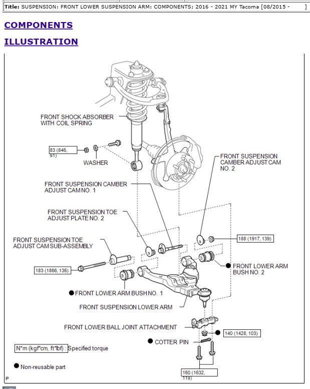

    Thank you! Crazy how I saw 155 then 100 now 135 for the front and 139 for the back. I must have been looking at the second gen specs.
