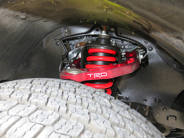

    2022 Pro with the forged UCA and longer Fox shocks may have more travel. (It's basically Toyota's OEM attempt at replicating the "mid-travel" setup the aftermarket has been doing for the past 17 years.)

    Yeah this is what I have but there’s no info anywhere that I can find about travel
    Well, the 2022 has a new UCA and it’s 1.5” up front and 0.5” in back so I’m just asking if there’s more travel on my truck
