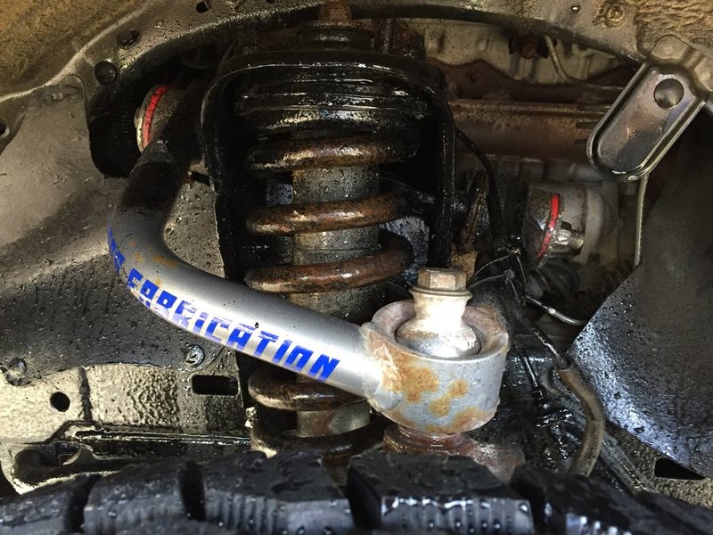

    My expertise is very limited, therefore I'm looking to the all-knowing and all-powerful gods of the TW forums for a little bit of direction here.
    Ive had this incredibly annoying squeak in the front end at even the slightest hint of a bump. I did some research and found that the total chaos UCA are often squeaky, and people suggested hitting the uni-balls with dry lube. so I did. Then when it didn't go away I hit the bushings with dry lube (i know people suggest greasing them but i don't have any grease/not sure how to take it apart and put it back together to grease up the bushings).
    So tonight I jumped on the running boards to compare sides, the drivers side is quiet, the passengers side is SUPER squeaky and annoying. To be fair, I don't have any way to tell whether it was the passenger side the entire time, or whether the drivers side was fixed with dry lube.... but the squeak has been there throughout
    video of the sound (louder in real life)
    https://youtu.be/syfD8goCl2s
    Ive done some research and I have seen tons of people say there UCA are squeaky and thats the way it is. But this squeak is beyond something I can live with. you can here it from blocks away, and it happens at any bump. Is there something I can do or should i take it in to get it looked at/ get the UCA taken apart and cleaned and re-greased?
    EDIT - it is the uniballs, i just thought it wasn't because the squeak would come back within 24 hours
    If it matters at all, heres my setup:

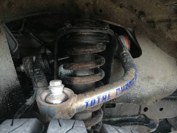

    After a lot of trial and error, it seems to be the uniballs in the TC UCA's, on both sides. I have some dry lube that i spray quite liberally / try to get it into the uniballs, and it seems to buy me about 24 hours of no squeak (maybe an hour or so of driving). Which is a little bit ridiculous imo. Same goes for rain / washing the truck - buys me a day of no squeaking.
    Probably going to take them in to a shop and get them taken apart / cleaned / diagnosed. The balls don't look too bad or pitted, so I don't know if they need to be replaced or if its an issue of just needing to be cleaned. Either way its annoying as hell. I know a lot of people claim to get months out of their UCA's without squeaking after they lube them so i don't know whats going on with mine.

    Also, is that rust on the TC arms?

    The UCA are about 4 years old with around 45-50k on them. And ya, theres some rust on the UCA. Not super happy about that. It seems to be very surface rust though. that pic is partly mud too, this is the left front cleaned:

    Do some googling on this.
    Most people never service their uni's until they squeak. It really helps to stay on top of the service before they go dry. Total Chaos recommends dry teflon lube like Tri-Flow or DuPont for servicing the uniballs.
    The WD-40 might give some temporary relief from already worn or pitted uni's but they should be replaced.
    Wheelers Offroad carries parts and press tools and with a little patience and very few dollars, it's an easy job.
    Also the bushings require silicone grease and there's a process to lube those correctly that requires loosening of the pivot bolt to allow grease penetration. I have seen pictures of bushings blown out of the arms from not doing it correctly or using the wrong grease.
