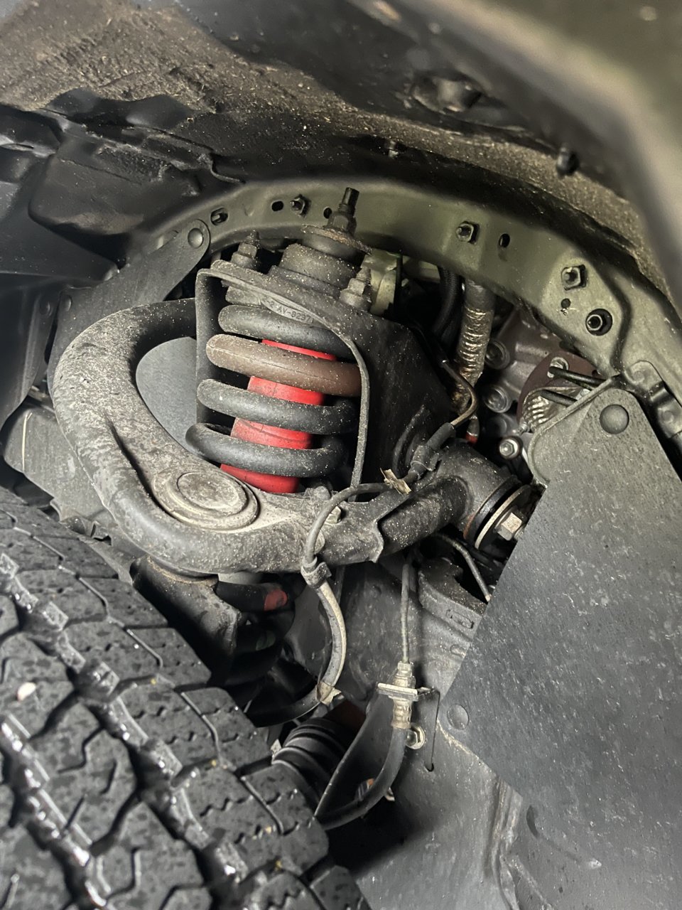

    Post pictures of the lift. Not sure what a TRD lift is. Regardless my truck wallowed in the turns after I added a winch & mount up front ~100 lbs. Much better after upgraded the coilovers (& springs) up front.

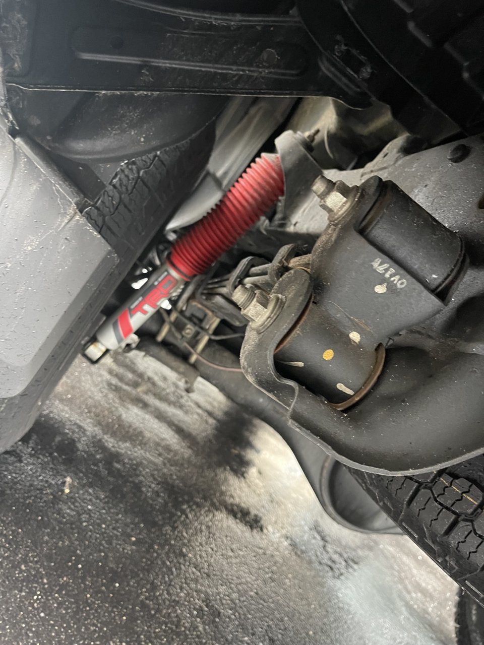

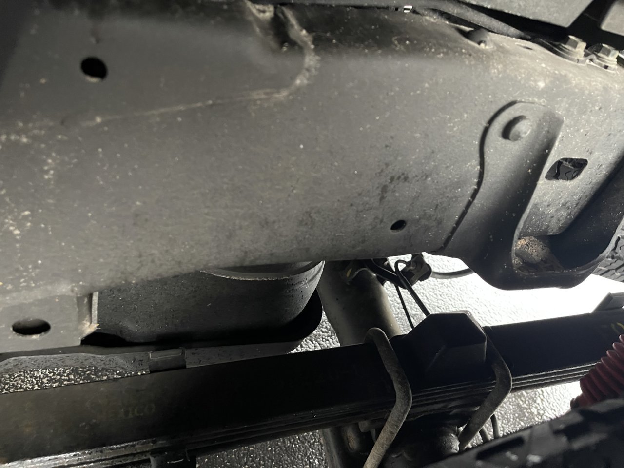

    Would be great if I didn't have to do anything lol. Here's a few I grabbed between the downpour. IMG_2913.jpg IMG_2911.jpg

    The "TRD lift" also comes with a pro grill and UCA's.
    The lift kit includes:
    • TRD-tuned Bilstein
    • Monotube shocks optimized for body control and ride comfort
    • Heritage-inspired TRD Pro-style front grille
    • Millimeter wave radar sensor for TSS (Toyota Safety Sense) integration
    • Wire harness and cable spacers
    You have a good start though. Fox are good shocks.
