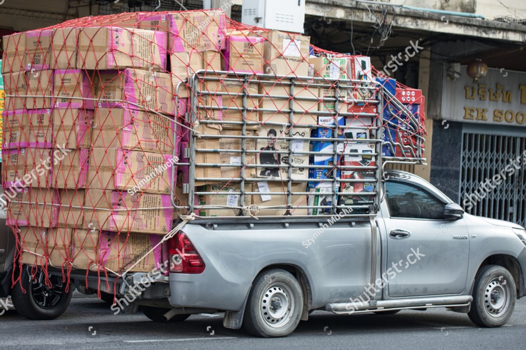

    If you really want to overload your truck you need a Hilux. Toyota knows their customers and builds them accordingly.
