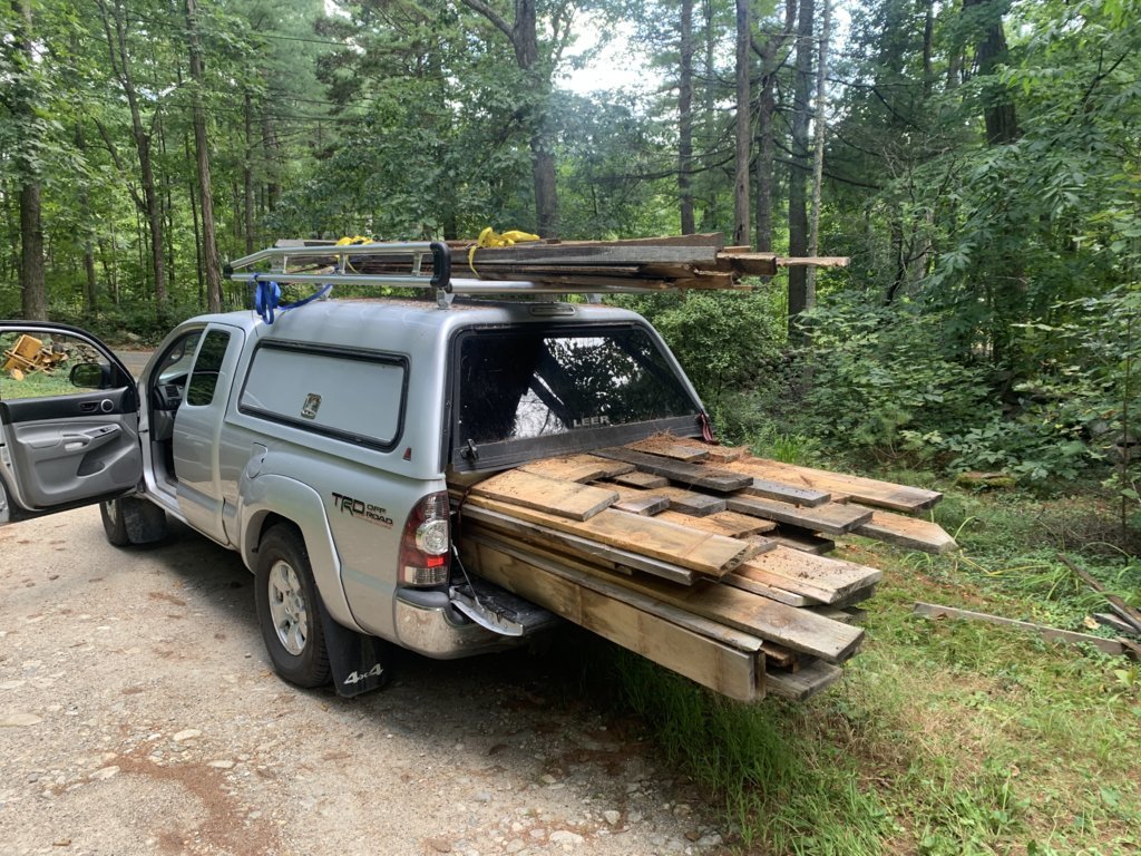

    I'm thinking of upgrading my suspension. My truck is pretty much stock. 2012 AC TRD OR I recently added a contractor cap that's heavy as hell. Every once in a while I way overload it as shown in photo below. I am a carpenter so the truck always has the cap on it + often another ~200 lbs in tools and materials.
    I live and work in rural areas, often on bumpy roads. I also like to explore deep wilderness (within reason, Im looking for extreme terrain, just trying to get to where other people aren't).
    Right now I am thinking that doing Bilsteins 5100 on the front with ~1.5" lift and airbags in the bag. I am also weighing the cost/gain on a new leaf pack.
    Let me know you think. Ive been doing some googling and talking to some people but Im curious what other people with similar set ups have to say about ride quality etc.

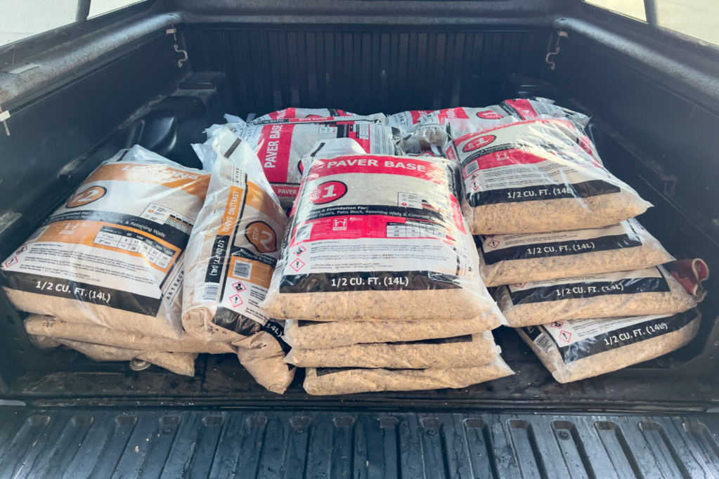

    Here's what the Deaver U402 stage 2 look like with 1,200 pounds of stone in the bed and a camper shell. The leafs sagged about 1/2" from where they normally sit. They aren't rated for that much but stage 2 are plenty beefy, and then when you ride empty (but still with the camper shell) it won't be harsh.
    Stage 3, in my opinion based on how stage 2 has performed, is overkill and should only be used for the fattest of overland piggies.
