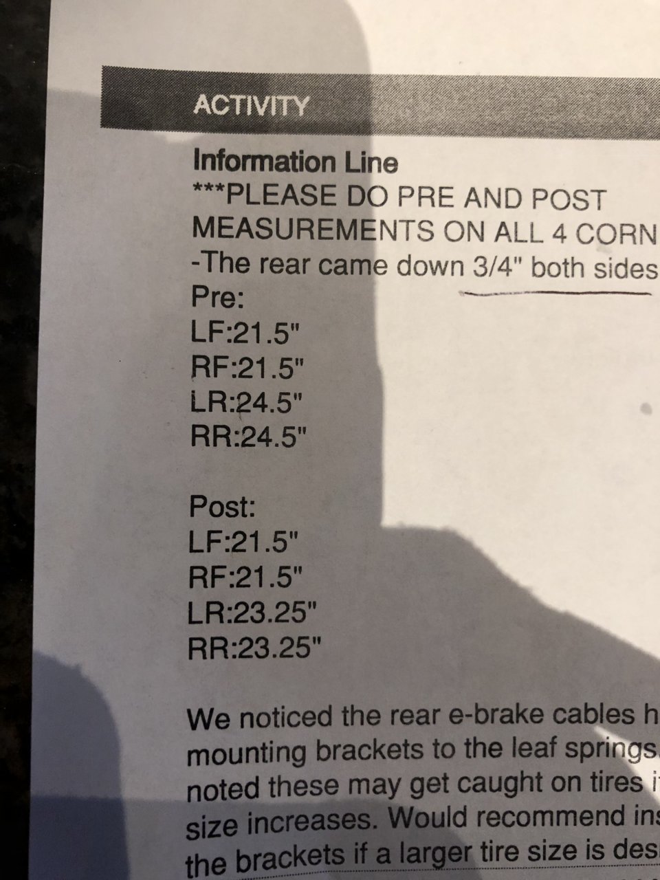

    Im getting evem less on 888s. 21.5”
    To center hub. I got 1.5 progressive aal in back. 5100 all around

    Here are my numbers after

    Zero as recommended

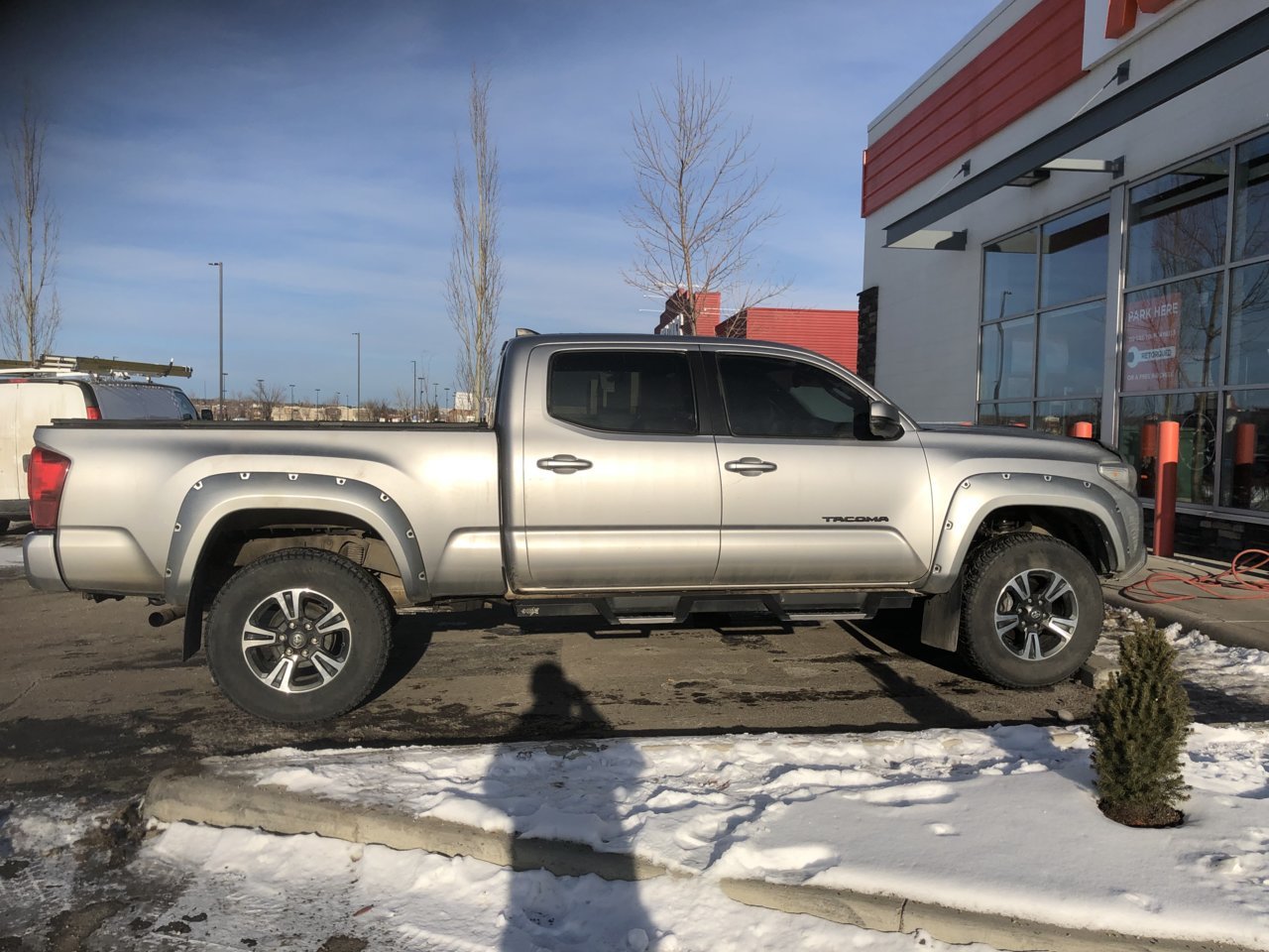

    I think it maxes at 2.75 under best circumstances but alot of people report 2”
