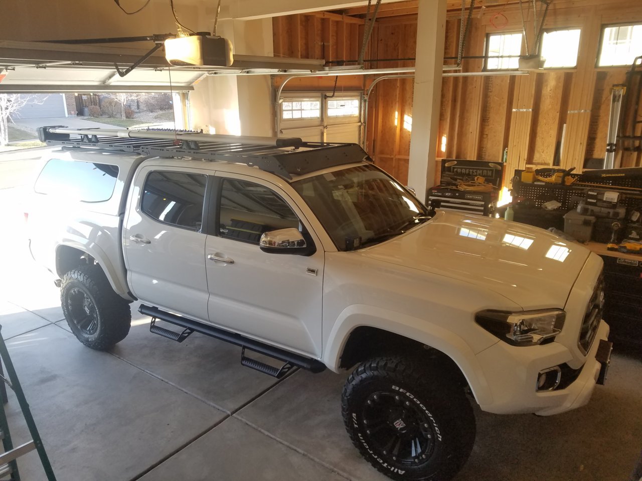

  10. Dec 24, 2018 at 4:37 PM
    #30
    tjpratt
    tjpratt Well-Known Member
    Oct 27, 2015
    #167820
    782
    Travis
    Aurora, Colorado
    2016 Limited 4X4 Tacoma
    3.75" Lift / OME OVTuned
    Bilstien 5100's
    After market UCA's
    OME 888's
    Full medium dakar leafs
    1" spacer under drivetrain and front diff
