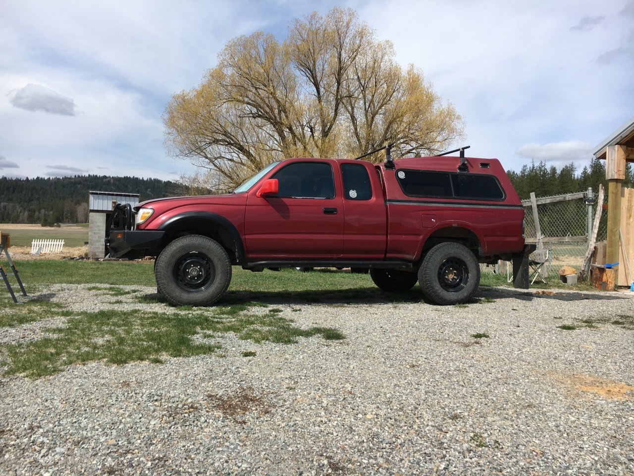

    I am currently running an OME exp pack with a their AAL. I carry a fair bit of weight topper, gear and tools, say about 400-500 continuously currently my truck is basically level:83CDC895-1A7C-451F-9A0D-E6B76179A29F.jpg
    So with that said, everything I am reading about setting up for a Drifter points to custom or Deavers/AlCans- etc. check out this TW thread link: https://www.tacomaworld.com/threads/vagabond-drifter-camper-buildout-and-mods.540940/
    Lots of good info there. Taco47 has the right idea I think, get your build sorted out, then go for springs, you will have good baseline requirements at that point and the fog will clear somewhat.

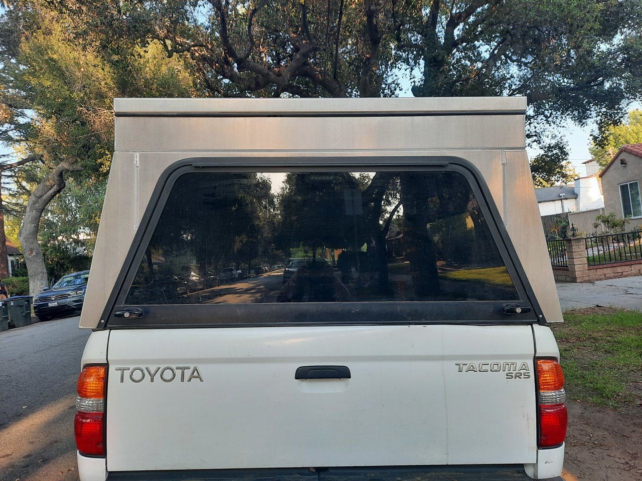

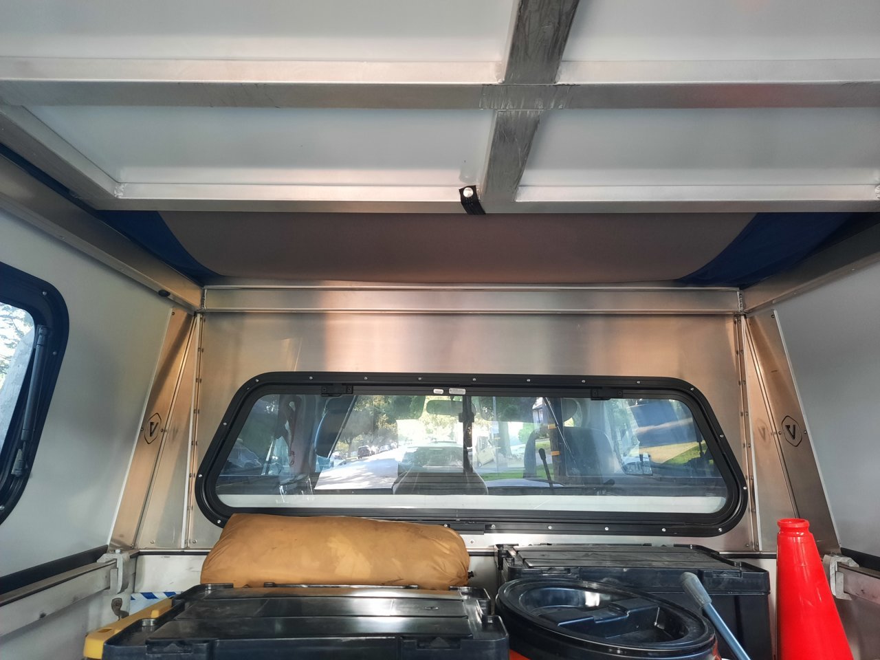

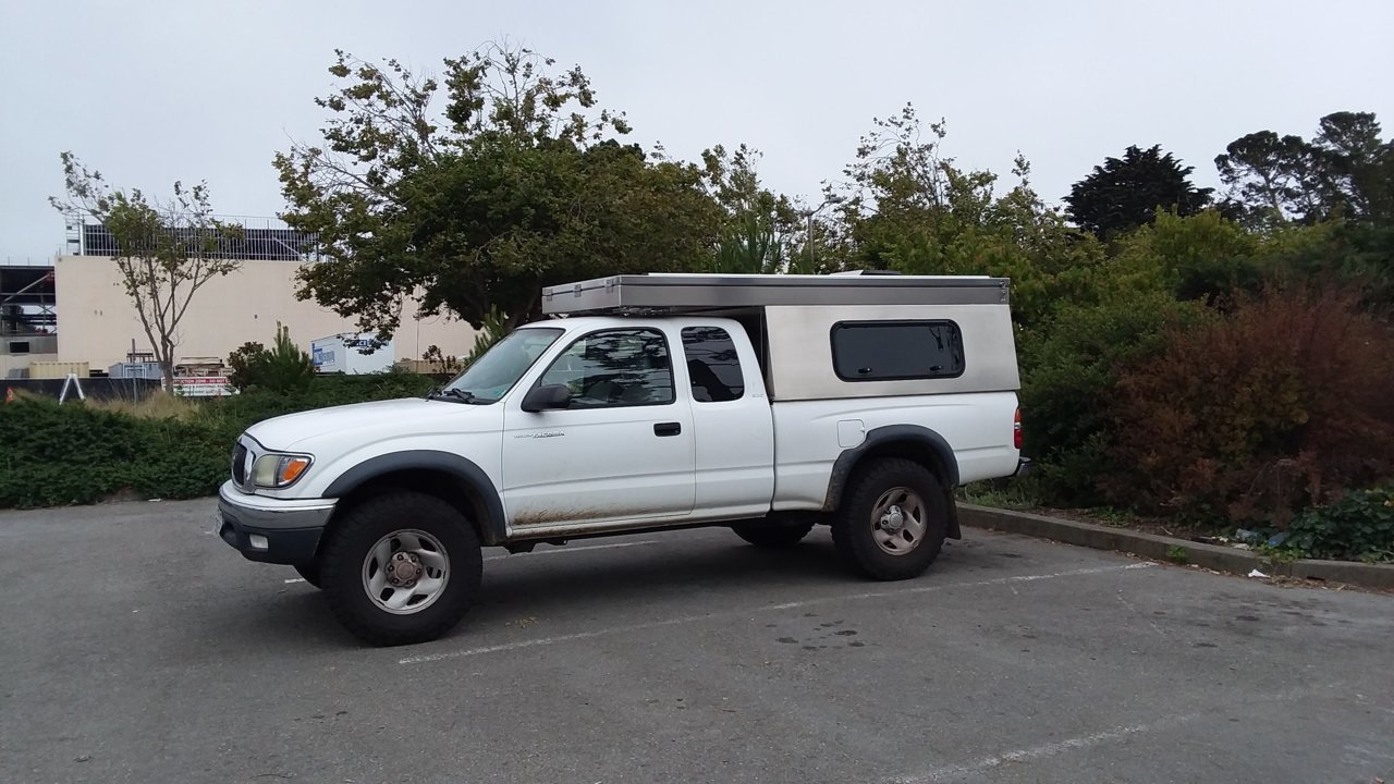

    Sorry to revive old post but do you have any more pictures of the fitment of that camper?
  9. Sep 6, 2021 at 6:01 PM
    BioG
    BioG [OP] Active Member
    Jul 22, 2018
    #260139
    29
    Pasadena, CA
    2002 Tacoma 2.7l 4x4
    Here are a few more photos. The one issue I have with the 1st gen truck is that the inside windows of my truck and the camper don't line up. The camper was made for a 2nd gen and newer truck, and the back window placement in those trucks is a different height than the 1st gen. The camper is also a tiny bit wider than my bed, it would be flush on a newer Tacoma, but that's no problem. 20210906_175328.jpg
