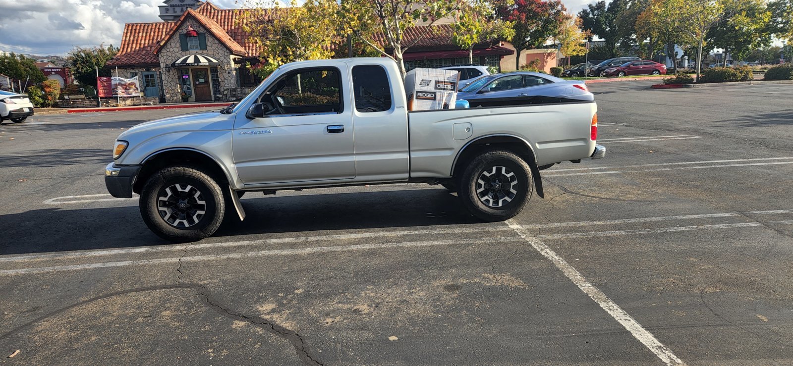

    I have a 2000 sr5 v6, extra cab 4wd 110,000 miles on it and it rides like shit. Like borderline scary. I live in california so the roads suck and I use this truck mainly as my snow ski rig. When coming down the mountain roads and hitting potholes the ass end kicks out a little bit. Having some weight in the back helps.
    I recently drove my trd tundra 500 miles on washboarded nevada dirt roads and it made me really realize how shitty that tacoma rides. I dont expect the tacoma to ride as nice as the tundra.

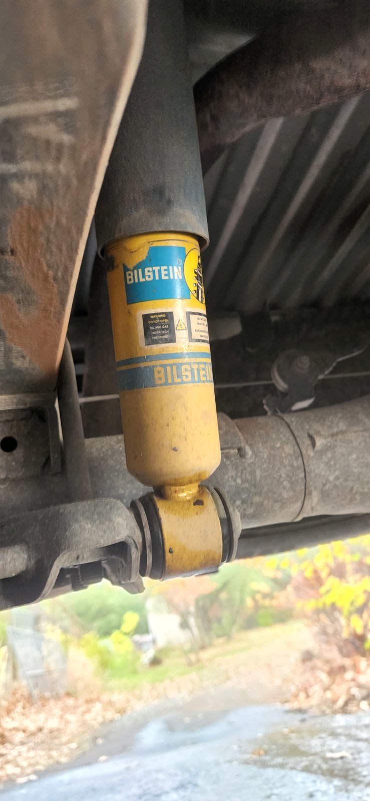

    About 3 years ago 20k miles, I put Bilstein 4600's on it. Back then The truck had the stock 14" wheels and I think 31's on it. The new shocks made it ride maybe 10% better. Then 2 years ago I got some take offs from a 2021 tacoma. It again rode a little better. But it still sucks.
    It also has a bad squeaking noise, almost sounds like sheet metal bending coming from the front right but I think its the sway bar. Assuming it has one.
    I am thinking about upgrading the springs and shocks with bilstien 5100's. Maybe get an ome or a kit from toytech like this I am not super in to researching this stuff. I just want to find a kit that everyone says that they love and install it. I don't plan on getting bigger tires when these wear out but I think an inch or so lift might be nice after dragging the receiver through a creek crossing last weekend.
    What are your suggestion's?
    Thanks

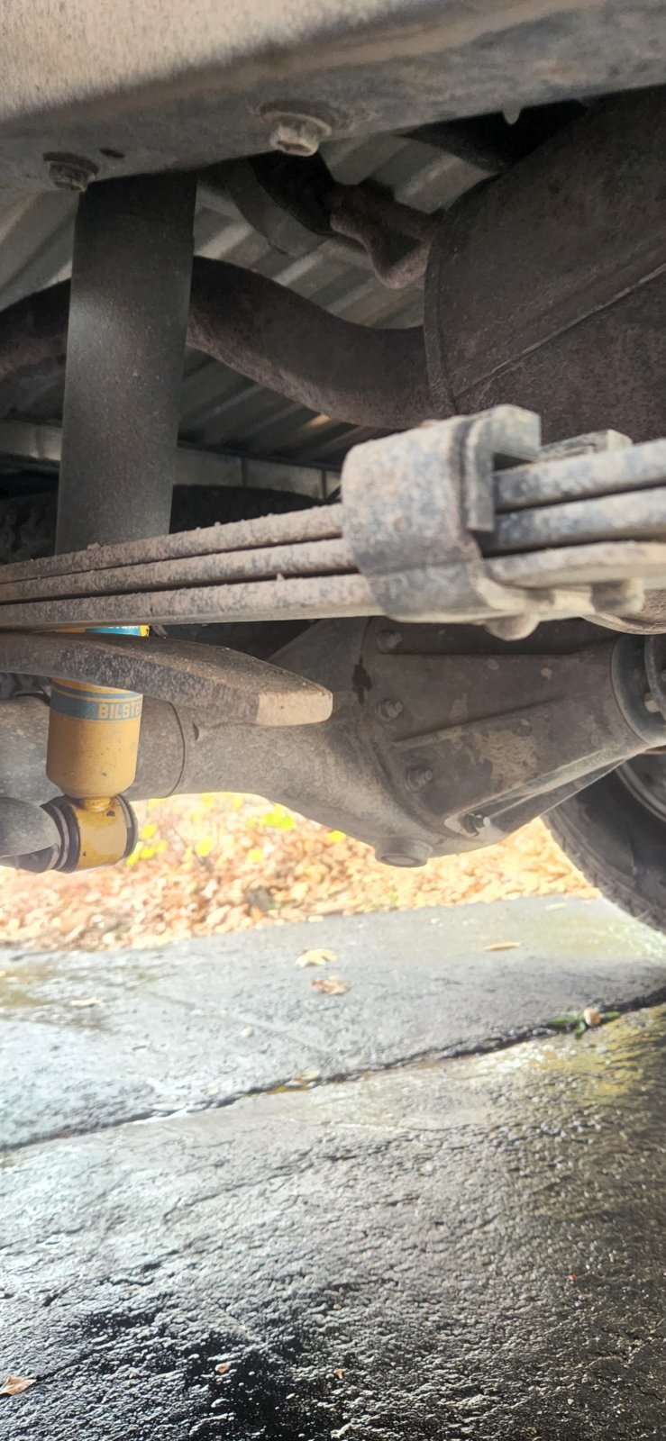

    The photo makes it like the rear is sagging, is it not? Stock these trucks had at least 1-1.5" of rake (rear high). If so, a low lift pair of leaf packs, along with just about any new shocks should help. 5100's with OME 880's or 881's should also be an improvement. To me, these improvements should start with a budget, then work within that budget to get the most bang for the buck.
    As for driving down snow or ice covered roads....the ass end of these trucks are so light that even with better suspension you might run into some puckering moments. Tire type can help and weight as you said.

    Thanks for the replies. I was noticing that also about the rear end looking low. I think maybe the rear left tire was off the edge of pavement.
    I carry 100 pounds of sand in the back in the winter.
    I am planning on replacing all the bushings, etc when re-doing the suspension. I have no idea to how well this truck rode when new. But I don't think the ushings are solely responsible for the ride.
    I will get some pics of it on level pavement and include the leaf springs. They do look shot when I look at them but I know nothing about this stuff.
    It might have 30 pounds worth of stuff in the back. Shop vac and empty cooler

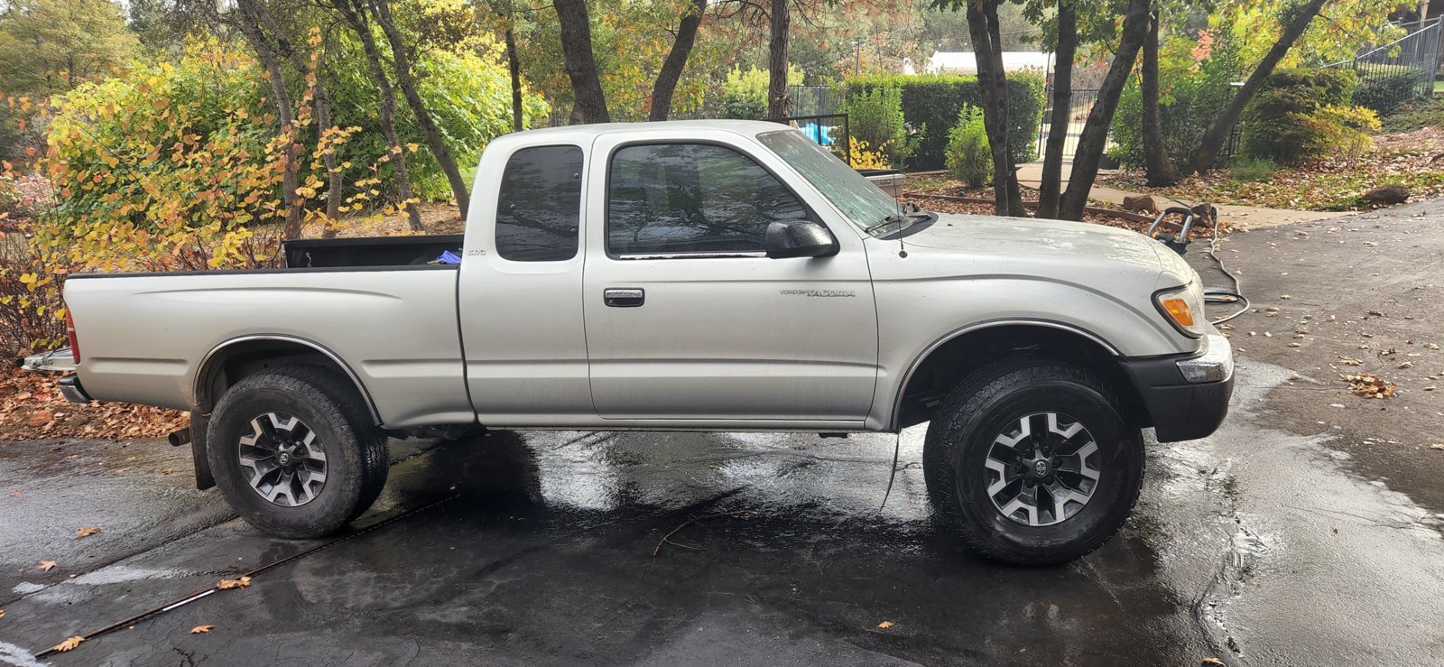

    The fronts shouldn't even fit.. the rears maybe.. But then why would you think that shocks valved for a completely different truck would be a good idea?

    I thought he was talking about suspension too at first, but I think he meant the wheels/tires are 2021 take off's.

    Oh- looking at his photos. yeah. take off wheels and tires.. :notsure: At least he didn't jam 2021 shocks in there :rofl:
