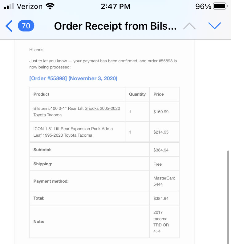

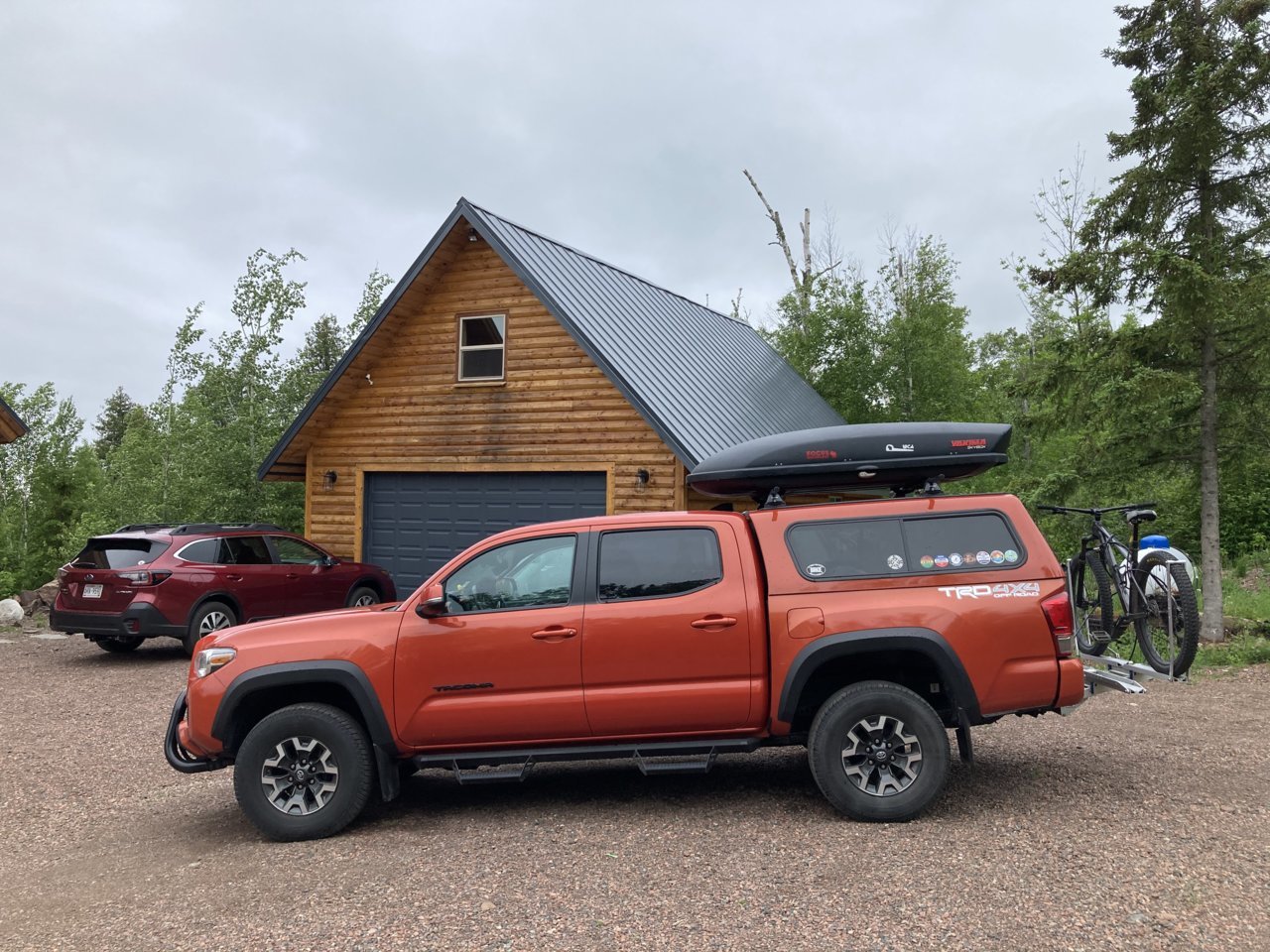

    i have a platform to snooze on and a topper on my 2017 OR and put an Icon add-a-leaf 3-pack with new shocks on the back which added about an inch to the rear (it’s supposed to add 1.5” but I had sagged a half inch over time). I didn’t do anything up front. Very happy with result.

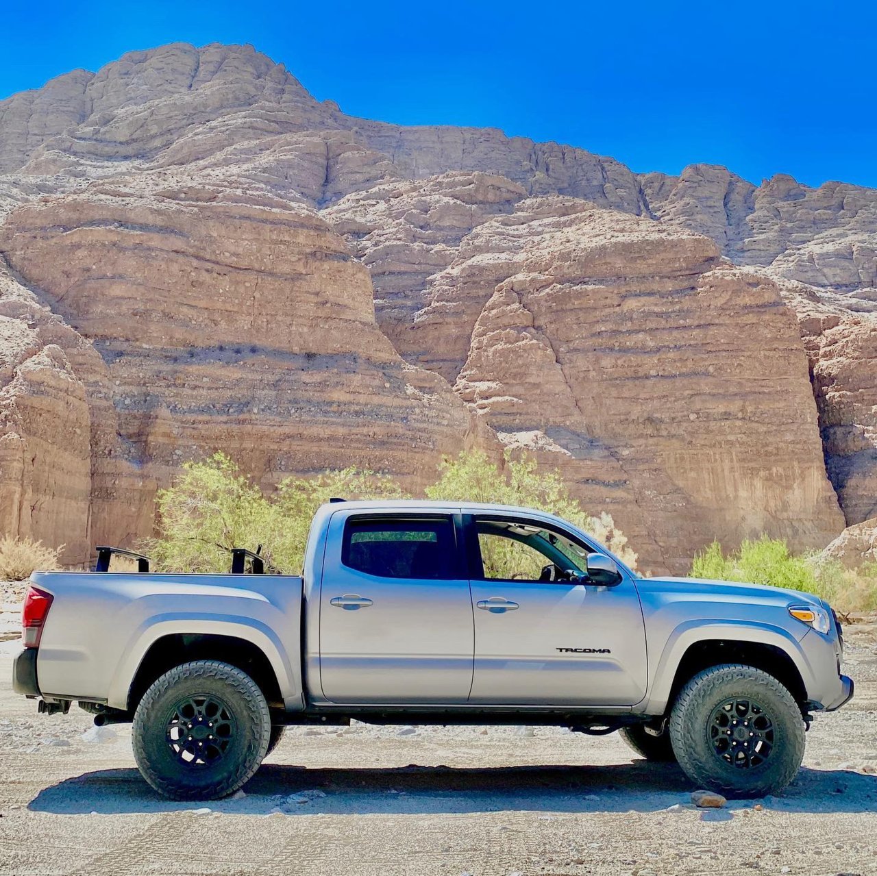

    Bilstein 5100's all around 1 inch lift in the front - Icon 3 leaf AAL in the rear 1.5 inch lift. I carry a roof top tent and gear when I go camping and it sits level.
