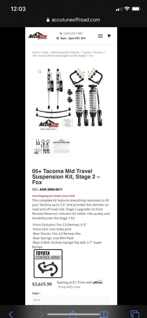

    Hey I’m new to this so please excuse my ignorance, but I purchased a 2014 Tacoma trd sport with a max trac spindle about 4” lift and I was looking for some coilovers but I can only find 0-3 lift on the coils and none for 4”. I have a screenshot of a Fox 2.5 0-3 kit with coils and shocks for the rear and UCA and leaf springs. Can someone please help me or direct me in the right path?

    You do not need extended length coilovers. With a spindle lift you use a factory length coilover. Now you can use an adjustable coilover but it would have to be at the zero setting to maintain just 4” of lift. If you adjust to let’s say To 2” then you would have 6” of lift in the front.
