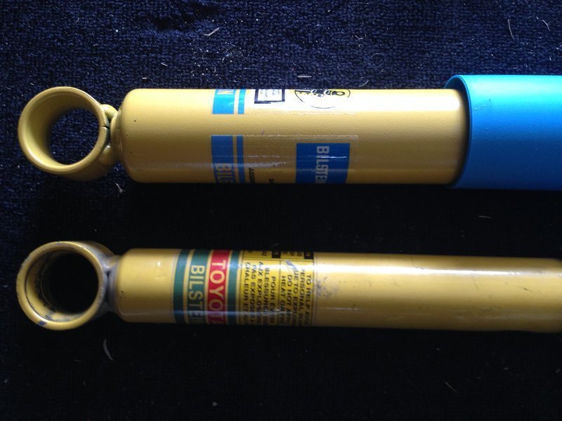

    69,757
    Not sure, but here’s a comparison of a 4600 (top) and OEM (bottom) for first gen Tacoma.
