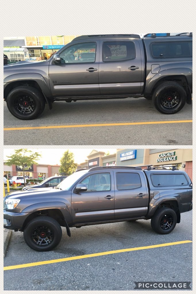

    I was super unhappy with the suspension in my 2015 sb with shell. I also did not want much of a lift as I am limited by my home garage. I ended up doing days of research and decided to buy a pair of struts of a 2017 trd sport that the owner lifted. This gave me 1" of additional front height and while I was at it I thru in a toytec spacer on the drivers side to combat taco lean. The new struts are sprung heavier and in my opinion provide a ride quality that the sec gen's should have come with from factory. In the rear I added the icon progressive add a leafs with over load left in as I occasionally Pack a load. I am super happy with this set up and can't believe how much better it is over stock. Drives and handles like a dream.before and after pic below!IMG_4865.jpg

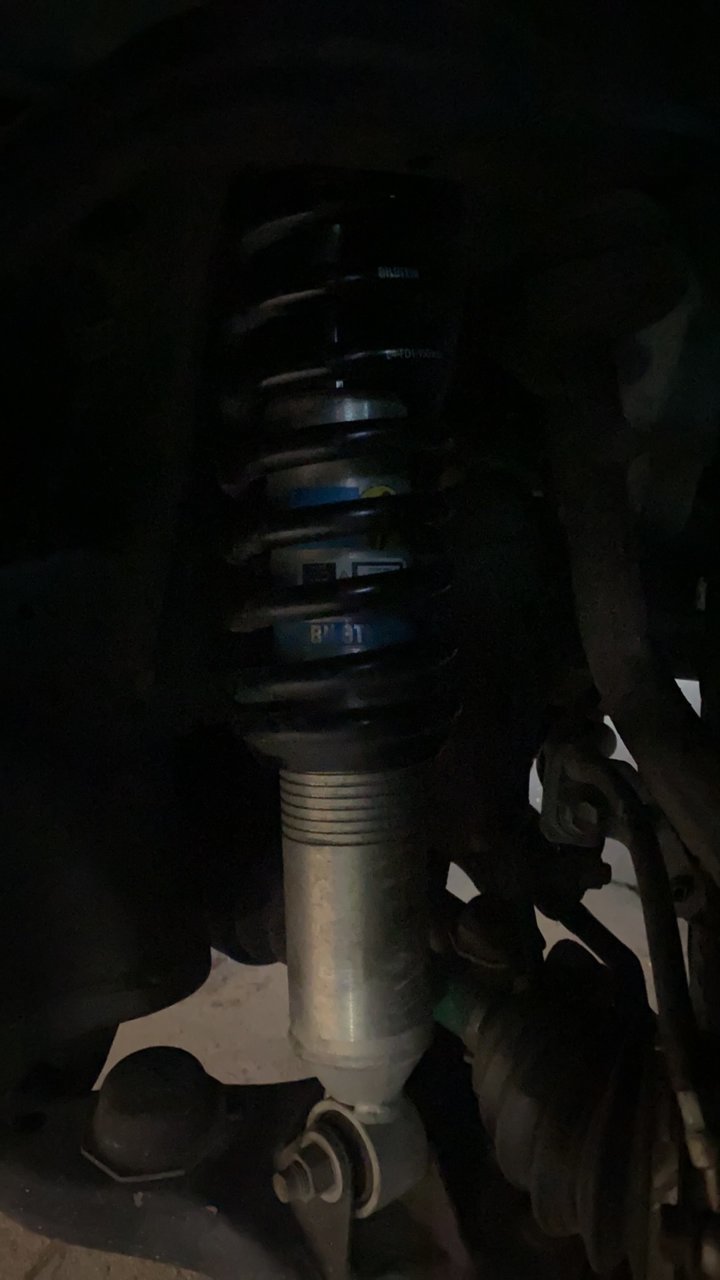

    Ricky
    Can someone tell me what shocks these are? 5DDB1DDE-22B1-4BB7-8AA1-DD89C1B9463E.jpg

    Won't the 880 and 881 be the same stiffness since they are both the same spring rate?
    In that kit that you mention, one of the options is the 880.
    Does that mean the nitrochargers will fit the zero lift of the 880?
    Are the nitrochargers and 5100 about the same build quality and application?
    With your setup, is your front and rear level to each other?
    Would the Dakers lift the back to much while using the 880 in the front?
