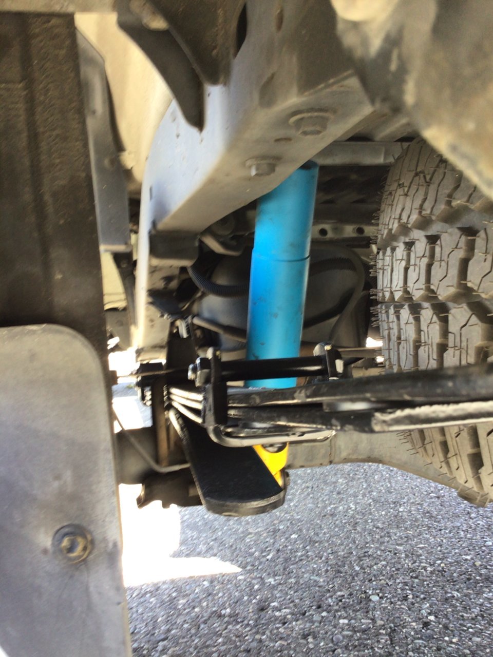

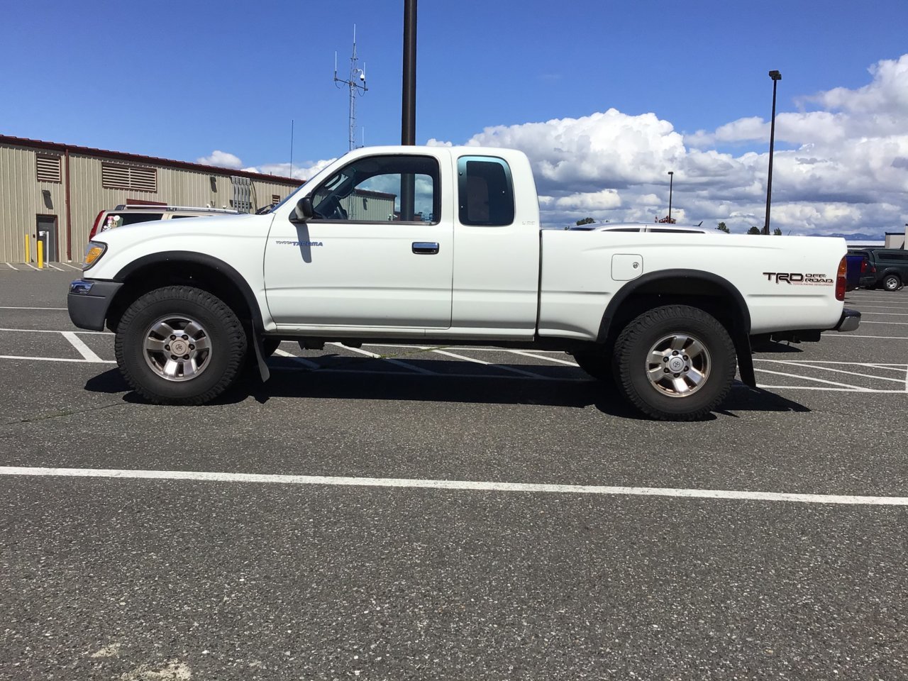

    So, here’s my truck after having 4600s installed on all four corners and a pair of General Springs standard/OEM (not heavy duty) rear leaf springs installed just last week. It’s hard to tell from the picture, but the rear leaf springs raised the back end just enough to have a little bit of a rake. Ride quality was noticeably improved.
    I also included a picture of what the new rear leaf springs look like. Although they don’t have much positive arch, they lifted the back end noticeably.
    Very pleased with the results. I’m hoping that the backend doesn’t start sagging prematurely though.

    You tell a guy this, 3 or 4 times (and he says he wants no lift) but refuses to listen.
    Maybe your picture will reinforce what I've been telling him.

    What the picture reinforces to me is that the rear sits lower then the front. Ok, thanks. Yet doesn't mention anything about replacing front springs, (which is what I'm looking to do) just adding shocks. I see you have the stock rear springs which is fine.
