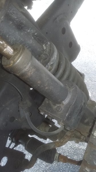

    So I have a 99 4x4 6" lift I just don't know what brand lift and I need front struts but it haves two different struts can some one recognize this struts names or brand thanks I need the one without the coil

    I had that lift on my first Tacoma about 16 years ago, the vw struts hold up much better than the tm ones did. It took just a bit of grinding to make them fit, they were a tad longer and the collar wasn't exactly the same, but in the end it was worth swapping them in.
    Where the second strut attached at the top eventually failed and the second strut went into my wheel well at about 5mph. The lift was complete junk, I was happy when I got rid of that truck! As I recall, there is just a hard rubber attachment at the top of the added tm bracket held on by three screws, eventually the rubber aged and it just popped right through.

    Pretty terrible lift, because it eliminates the upper control arm and turns the suspension into a macpherson strut design, with a dodgy upper strut mount that bolts to the OEM shock bucket. The upper strut mount sees high duty cycle because it's also the steering joint, but the materials Trailmaster used aren't durable.

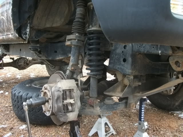

    ^The Trailmaster lift is kinda "abnormal" with the strut that clamps onto the spindle:
    One possible, but spendy, way out is to use the spindles from a Fabtech 6" lift kit along with OEM upper control arms.
    FabTech spindle P/Ns: FTS70007D, FTS70007P (they run about $280 ea.)

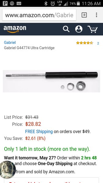

    I have this same lift on my truck currently. i haven't had problems with it but i also do not off road. There was a site that had an inversion mod where you flip the top mount but the part number for the struts i use are Part #G44774 they are gabriel struts. If you haven't done the inversion mod you will need to grind down part of the strut like in the link provided by McMash.

    This is what shows up with that part number now im confuse on how to install it when the old one have 3 holes in the bottom one holding the spindel and the other two holding a cheesy u braket. I know that top strut mount gives out after a wild of use and punch a hole through the fender if it do so is there any other top mount that is better for it? thanks

    That's the correct strut. If I remember correctly if you slide the boot up there is a collar that holds the strut in if that doesn't do it then its the connecting piece right below that. I think its 4 bolts on the side and I think 1 or 2 on top of the same piece. As for replacing the top mount you can't. The only way around it is to get lift spindles, I think pro-comp made some. But that means removing the strut mount and putting the upper control arms back on. I really don't see how the strut mount give way because its a solid metal piece?? But I have read that about this lift kit

    Don't get the Gabriel struts. Posts on TTora show they can leak pretty quickly, too. Get the Sachs struts I PM'd you, they are better built.

    Danm I just bought the Gabriel's now.....
