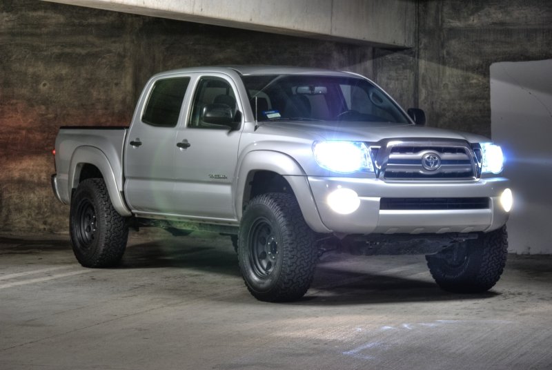

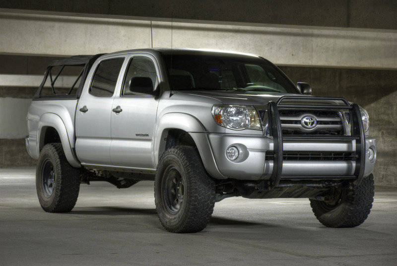

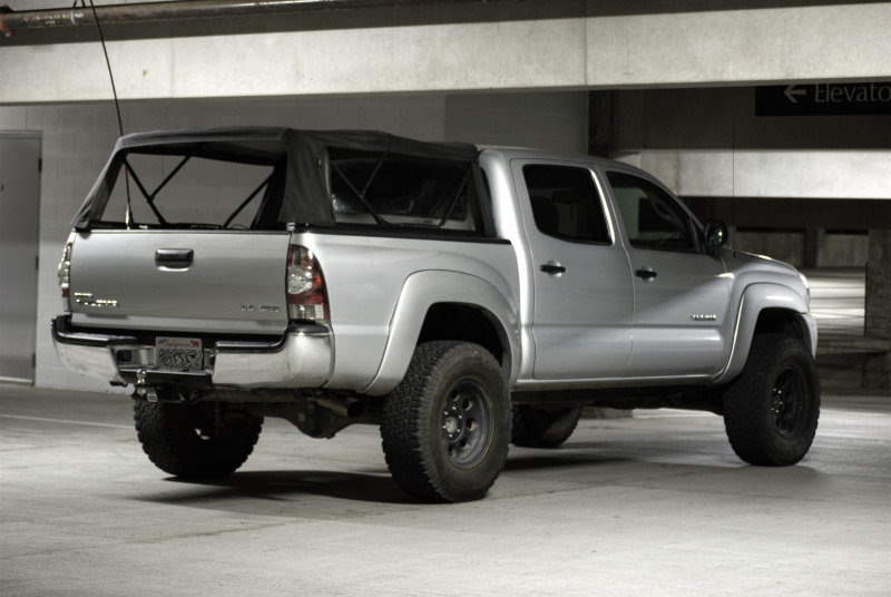

    2" AAL from Toytec gave me a .5-1" rake. Should level you out nicely.
    Before
    After
  13. Oct 19, 2012 at 6:38 PM
