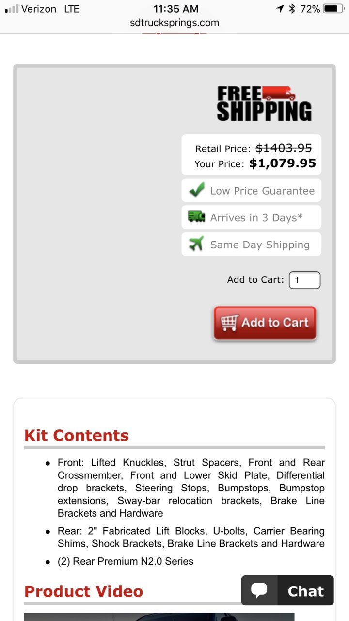

  9. Jan 30, 2018 at 9:36 AM
    Monster55060jr
    Monster55060jr [OP] Member
    Jan 28, 2018
    #242747
    6
    Blue taco sport
    This is what I found and the price, is there anything that I would have to get extra that doesn’t come with this kit?
