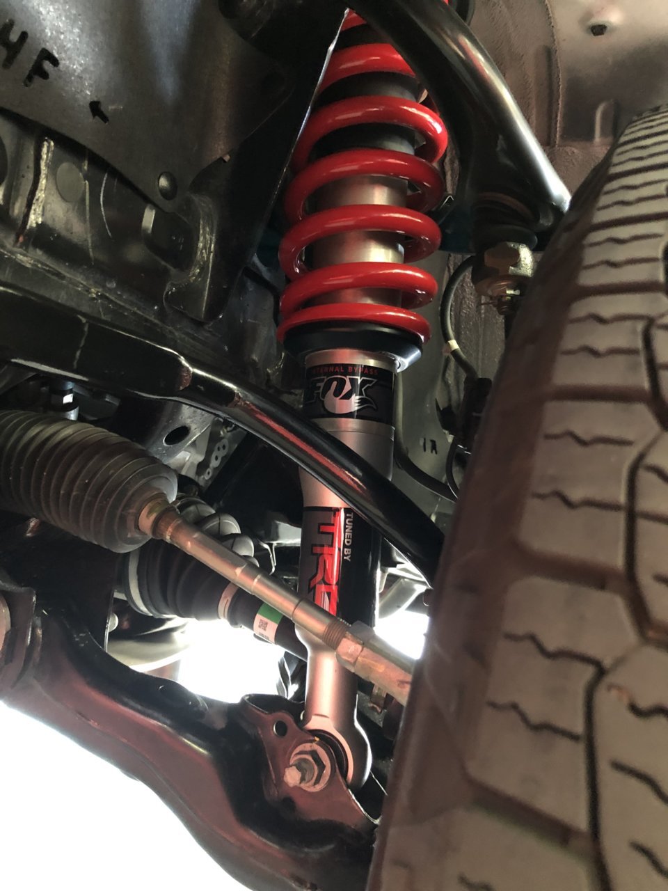

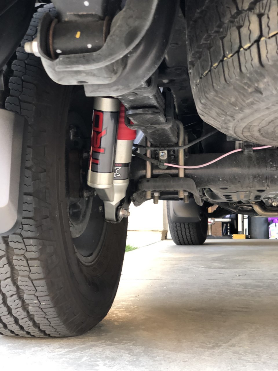

    Upgrade or Lift/Upgrade? .... I just did these and am very happy with the upgrade!F6DB4445-C8F0-428F-A994-2F86E2A1D369.jpg919C581E-7062-4CF0-BAD8-4E1FE712A4CE.jpg
