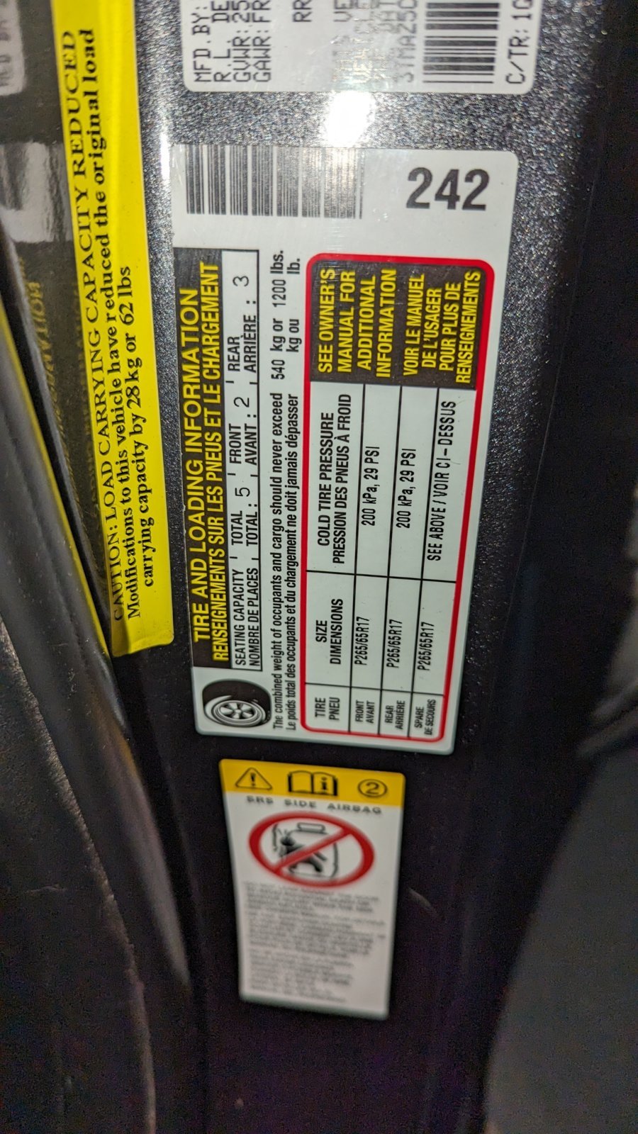

    Stock tires that have the letter P in their size? 29 psi.
    Look for this sticker to confirm.
    Mid 30's would definitely explain a jarring feeling on bumps.
