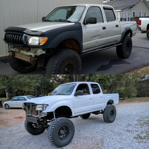

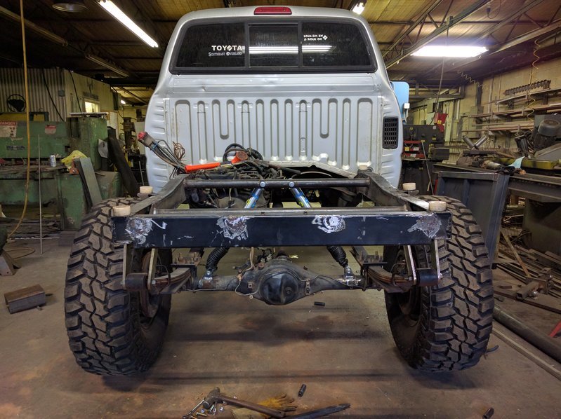

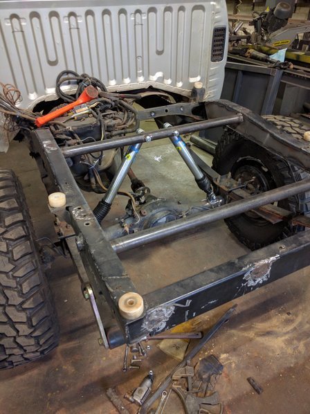

    Got the rear all finished up. I'm going to add a 1-2" block to it for the time being until the front settles. Can't be having that squat look.
    Rear shocks were triangulated and the rear frame is boxed. I tacked the LSPV in place and have an LSPV bypass to install. It's coming along.

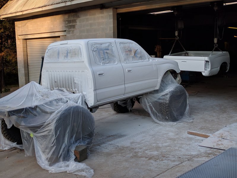

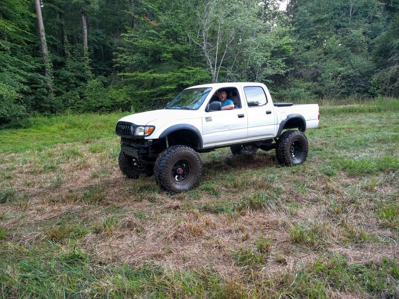

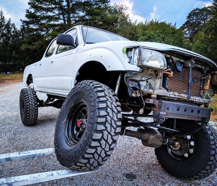

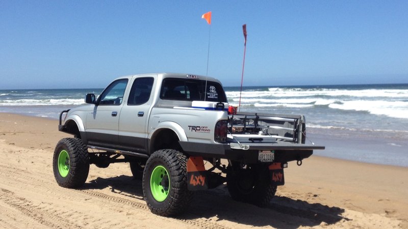

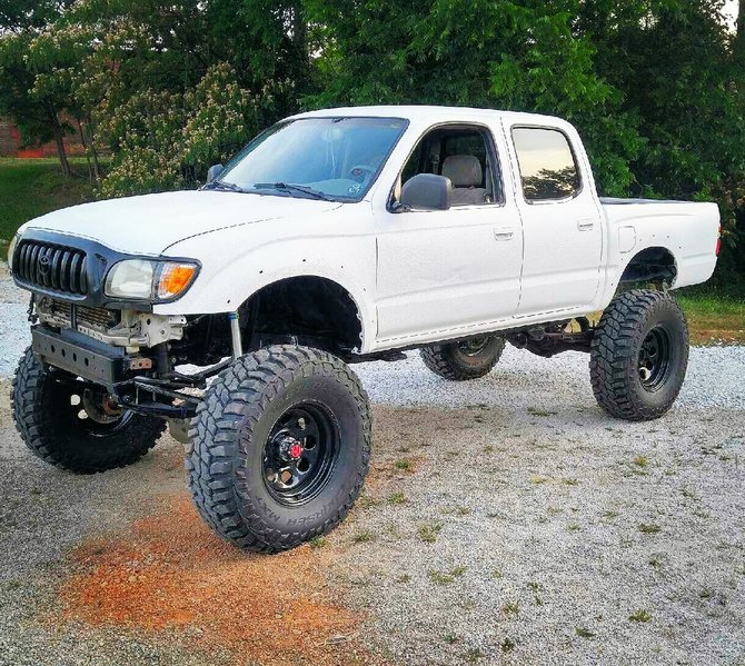

    so finally got this thing moving along. got her painted up with monstaliner and it turned out great imo. was gonna order new badges until i saw they cost around $200.

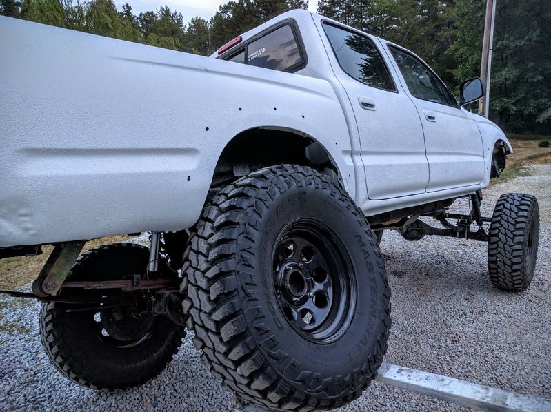

    got the bed back on and took some forklift pics. the rear isn't matching the front in these pics but it flexes decently with the stiff springs.
    Finally got the rear to match with a 2" block (temporary) until the front settles. I took it out this weekend and realized that the rear axle is offset to the right about 1.5" so we'll be fixing that. Other than that it is great. Got it up to around 70 mph and it drives very smooth. got some weird "thud / clunk" sound when the body rolls but i'm hoping its just the front spring shackles. I'm going to take a leaf or two out of the front this week, cant stand it being so high. it also has some minor things that i need to finish up but it's going very well so far.
