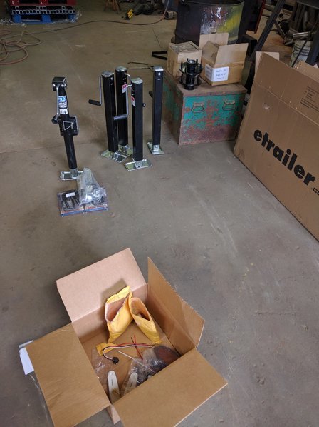

    started something else this evening.. @Milota95 is the inspiration with a hint of @Mademan925 lol

    B.F.E

    Leveling jacks. I like it. I just use my highlift but that would be way nicer.

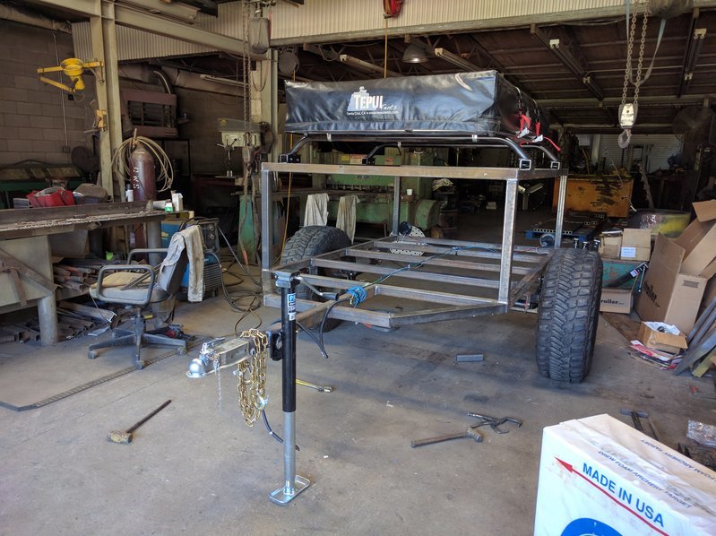

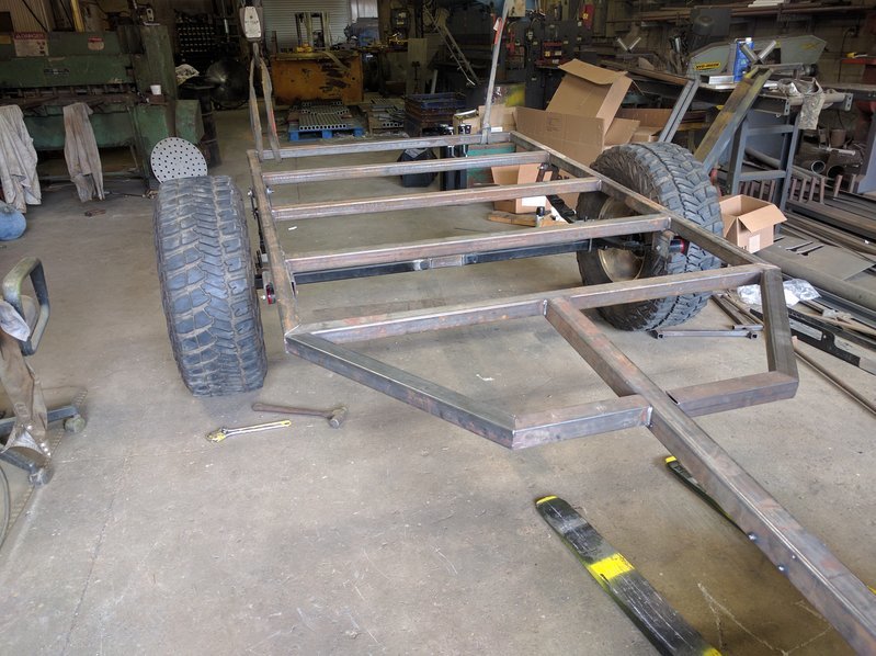

    well i got the trailer rolling and mounted the tent to try it out this weekend. works really well. I'm thinking of mounting a pet cool type air conditioner to the trailer and running a hose to the tent for heat / air to make sleeping more comfortable.
    Trailer is 5x7 on 35" tires. It's pretty wide lol

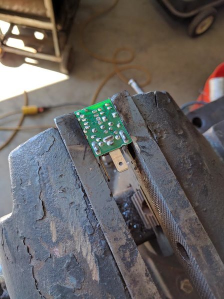

    -Since I have no turn signals (no bumper and the fuse kept shorting) I decided to cut the DRL wires and splice the turn signal wires in their place. This resulted in the quick blinking turn signals because of the lower power draw much like an LED replacement. I dug under the dash and found the relay responsible for the quick turn signals and took it apart. Once we had it apart we drilled out the pin from the appropriate chip and voila! no more fast blinking. I plan on using the now cut DRL wires as all time fogs later on down the road.

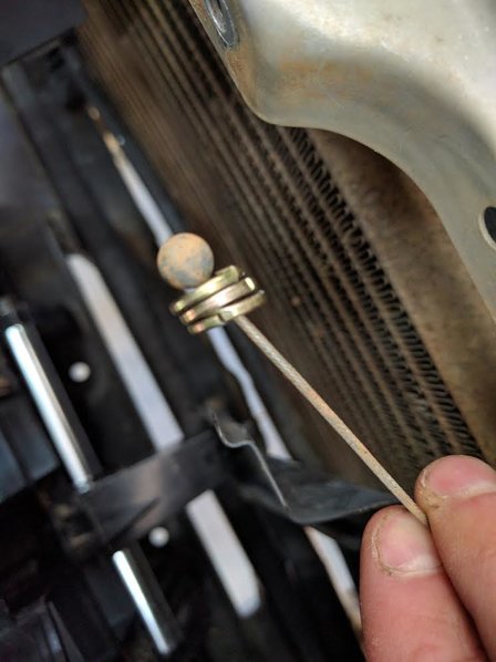

    -My hood latch cable has been stretched out for a while to where it will barely open the hood at the end of the pull. To fix that we put 3 small lock washers on the end of the cable closest to the hood and closed up the lock end. Good as new.

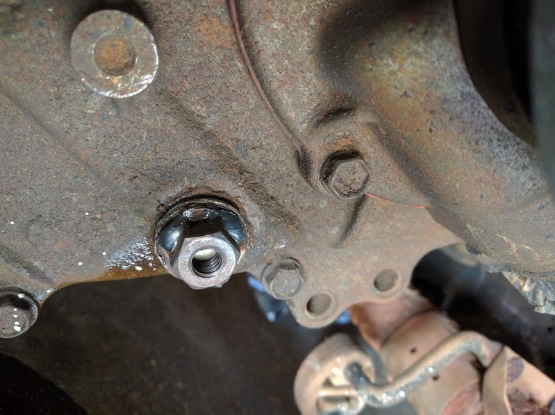

    -The last booty fab thing came when I tried to check my Tcase fluid level and noticed that the PO had rounded off the head so bad that we had to take a hammer and chisel it off. Once we had it off, I used a grinder to get a flat surface, then welded a nut on top. Voila... it works haha.

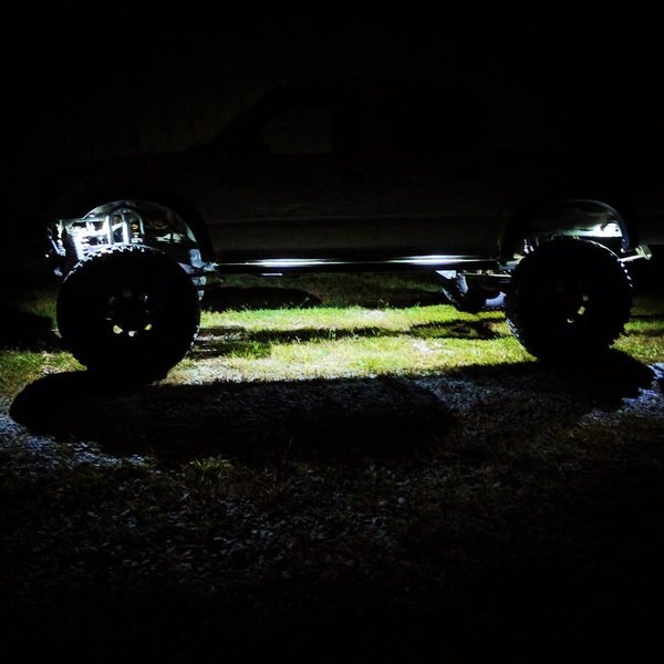

    Got the rock lights installed last night. Turned out pretty sweet. 8 lights to do this long wheelbase.
