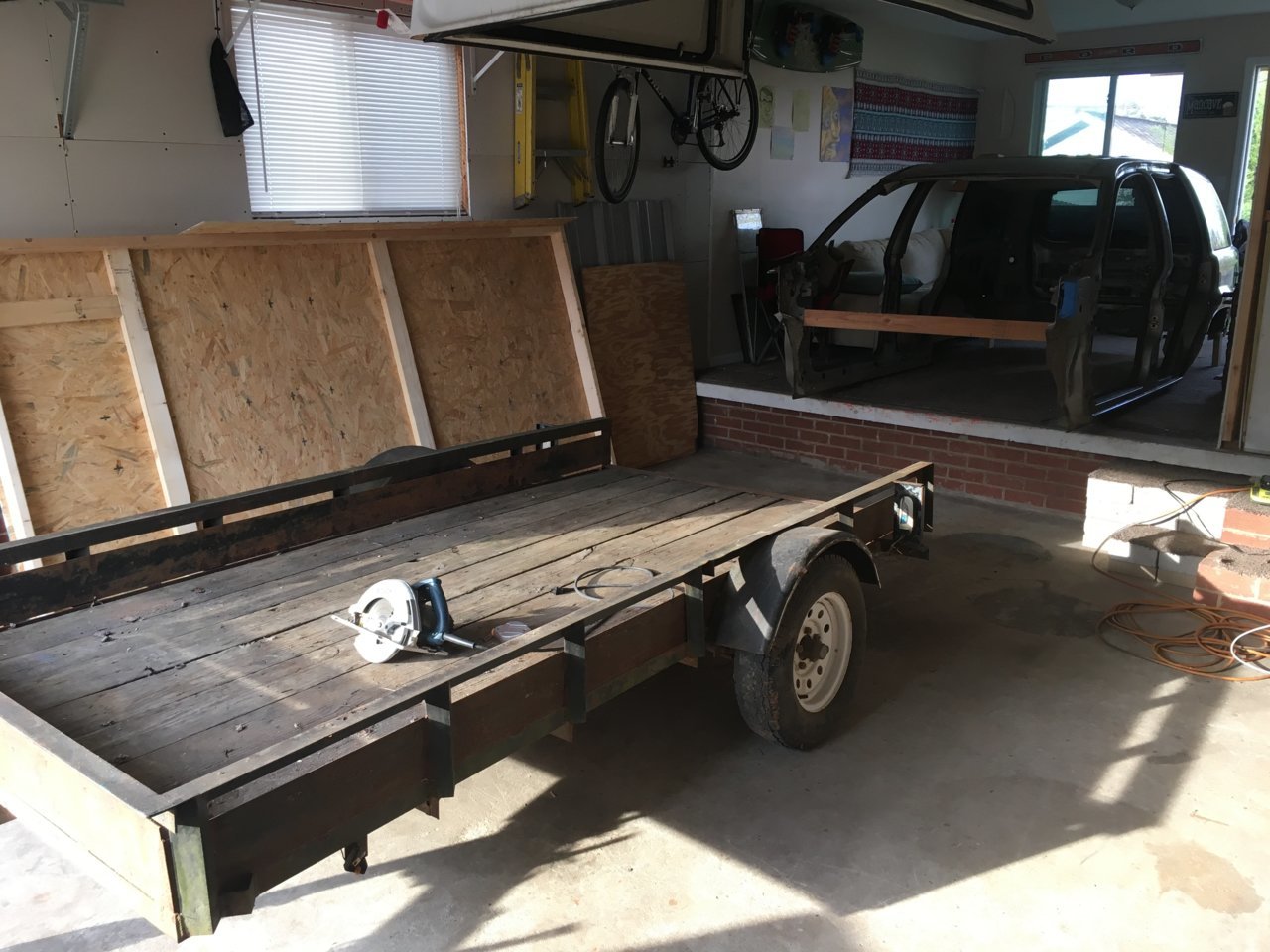

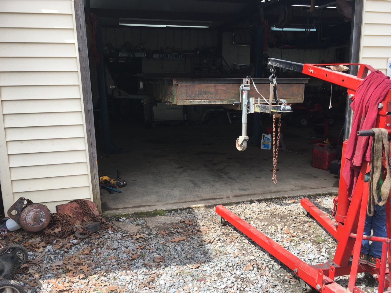

    There is a big stupid jeep in the middle of my man cave just in time for the weekend, dammit. :sadviolin:The trailer is getting the axle swap tomorrow. We are using my buddy's lift, and the jeep body would've been too tall. I have not attached the new floor yet because of this. I am looking forward to assembling the big parts. Soon. Standby for tomorrow's mediocrity.

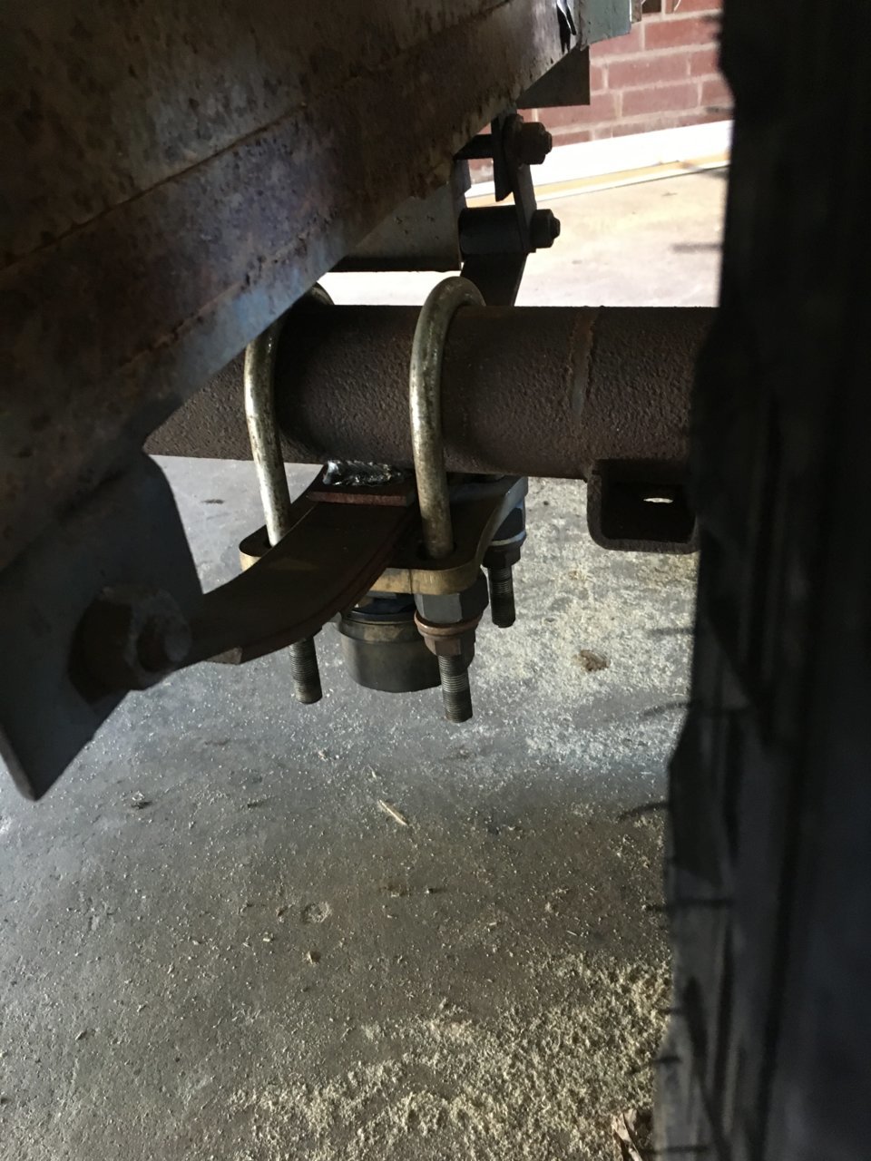

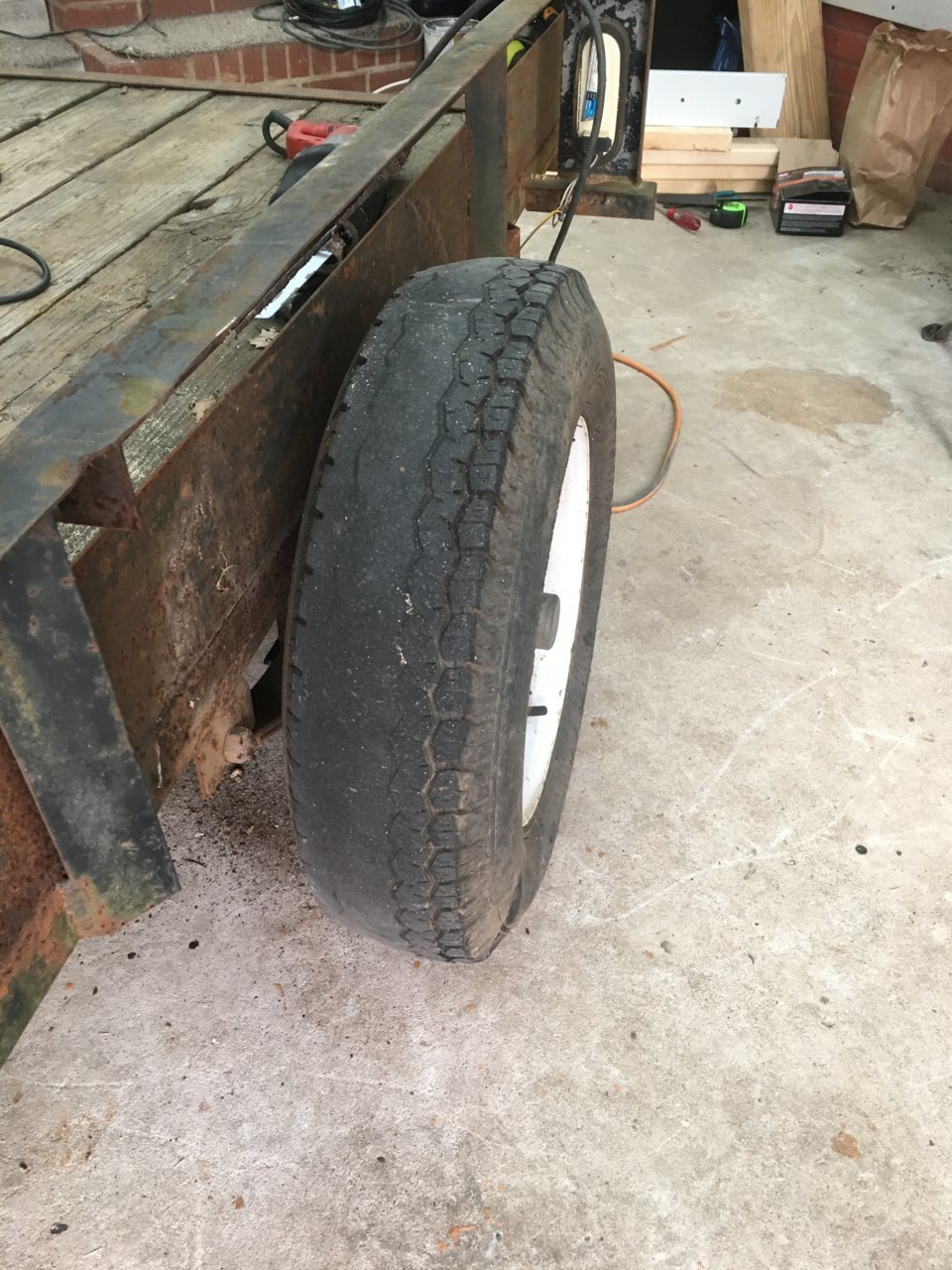

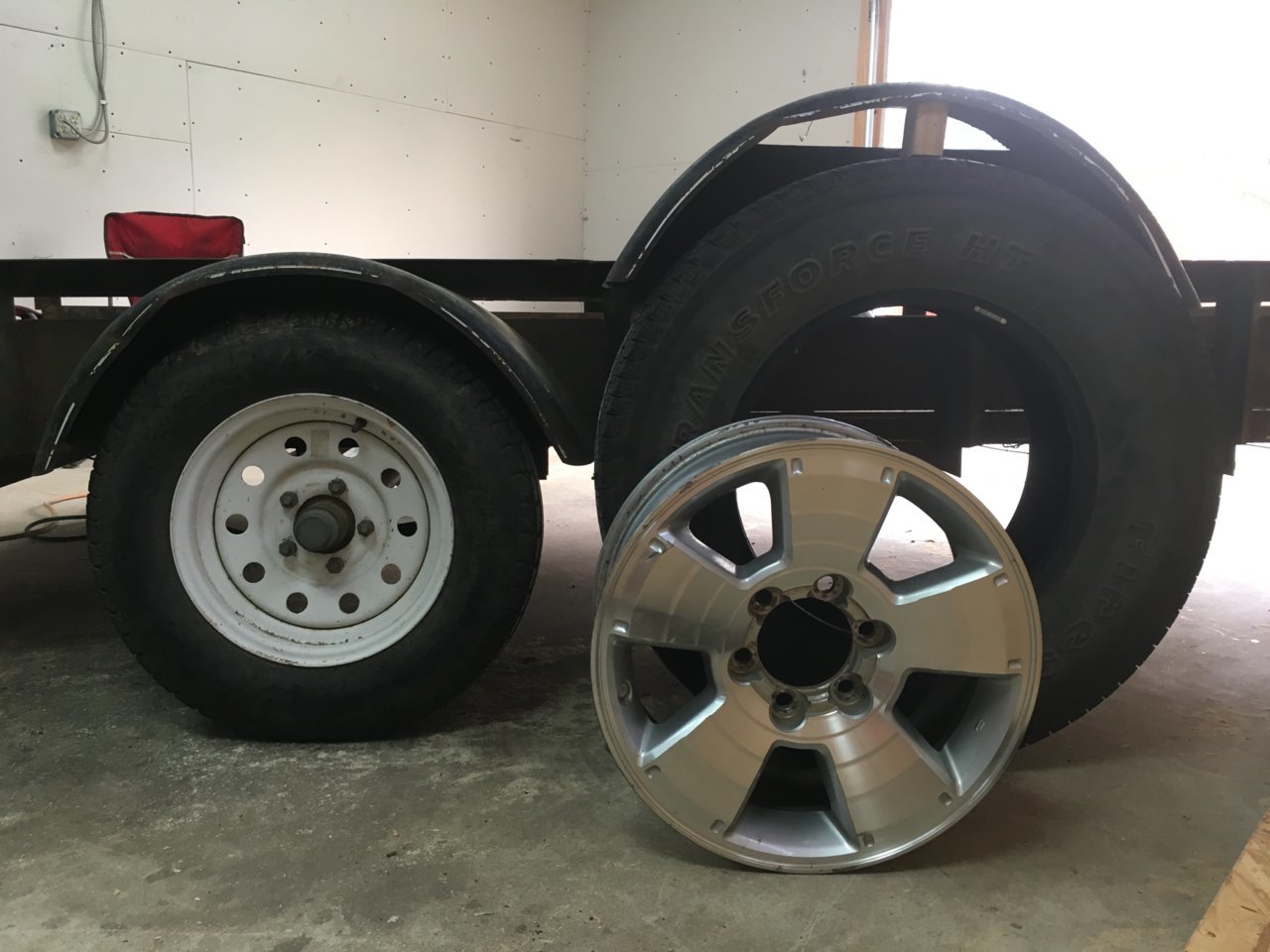

    I want to keep the center of gravity low-ish, so the new axle will be mounted with the springs under it just like the old. Because of that, I had to remove the trailer fenders. I will modify them and re-install them after the new wheel/ tire combo. The new wheels will be quite a bit bigger. Also, part of the reason I'm replacing the axle is because the old one is bent. Notice how horrible the old tires are wearing.

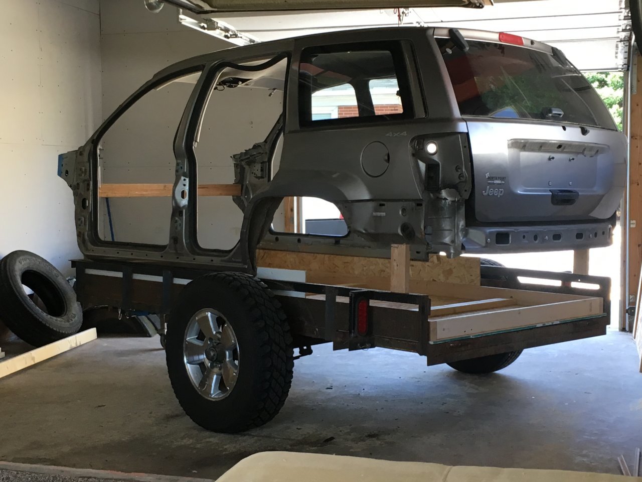

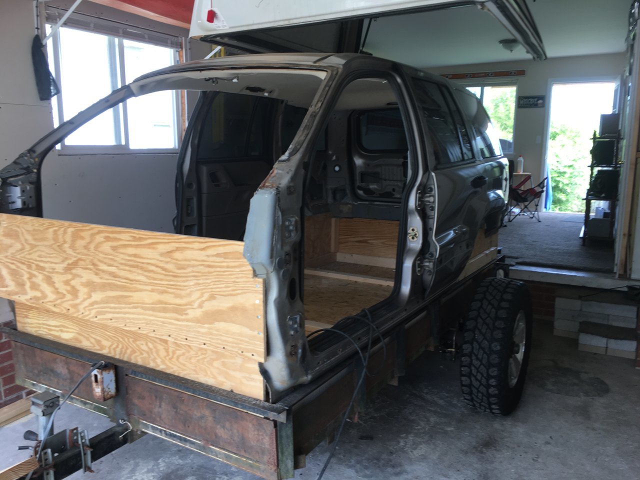

    Axle swap is done! I ended up using the old U-bolt flip kit from the Tacoma. It fit the new axle perfectly. I still need to remove the now upside down bump stops and trim the bolts.
    This morning, I put the jeep body back on and put the floor in for the first time. It all fits together great!

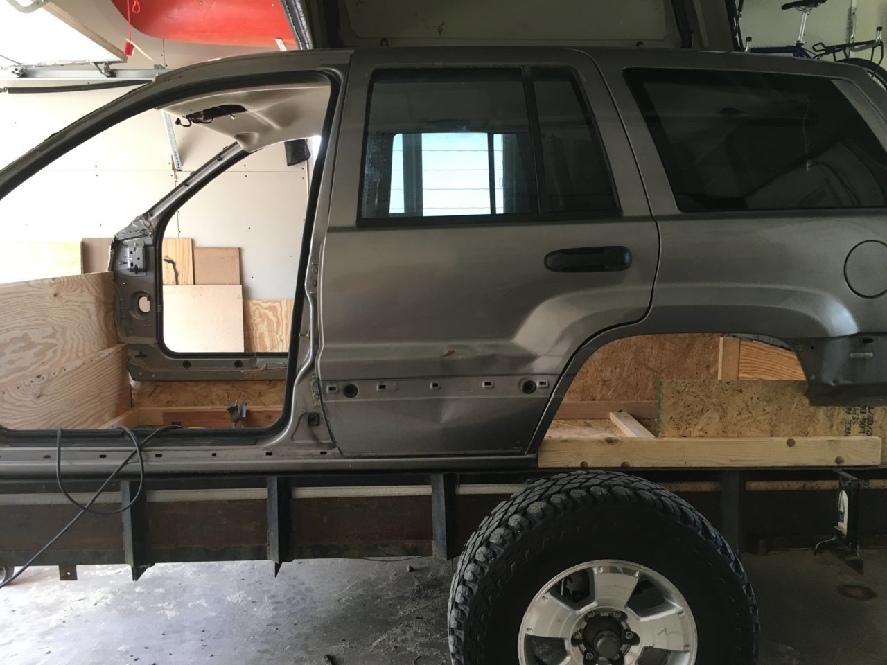

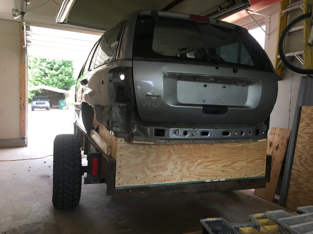

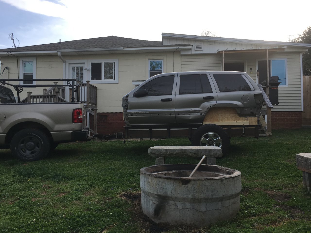

    Made some really good progress yesterday. Attached the floor to the body and started filling in the gaping holes in the front and rear. Also reattached the back doors.

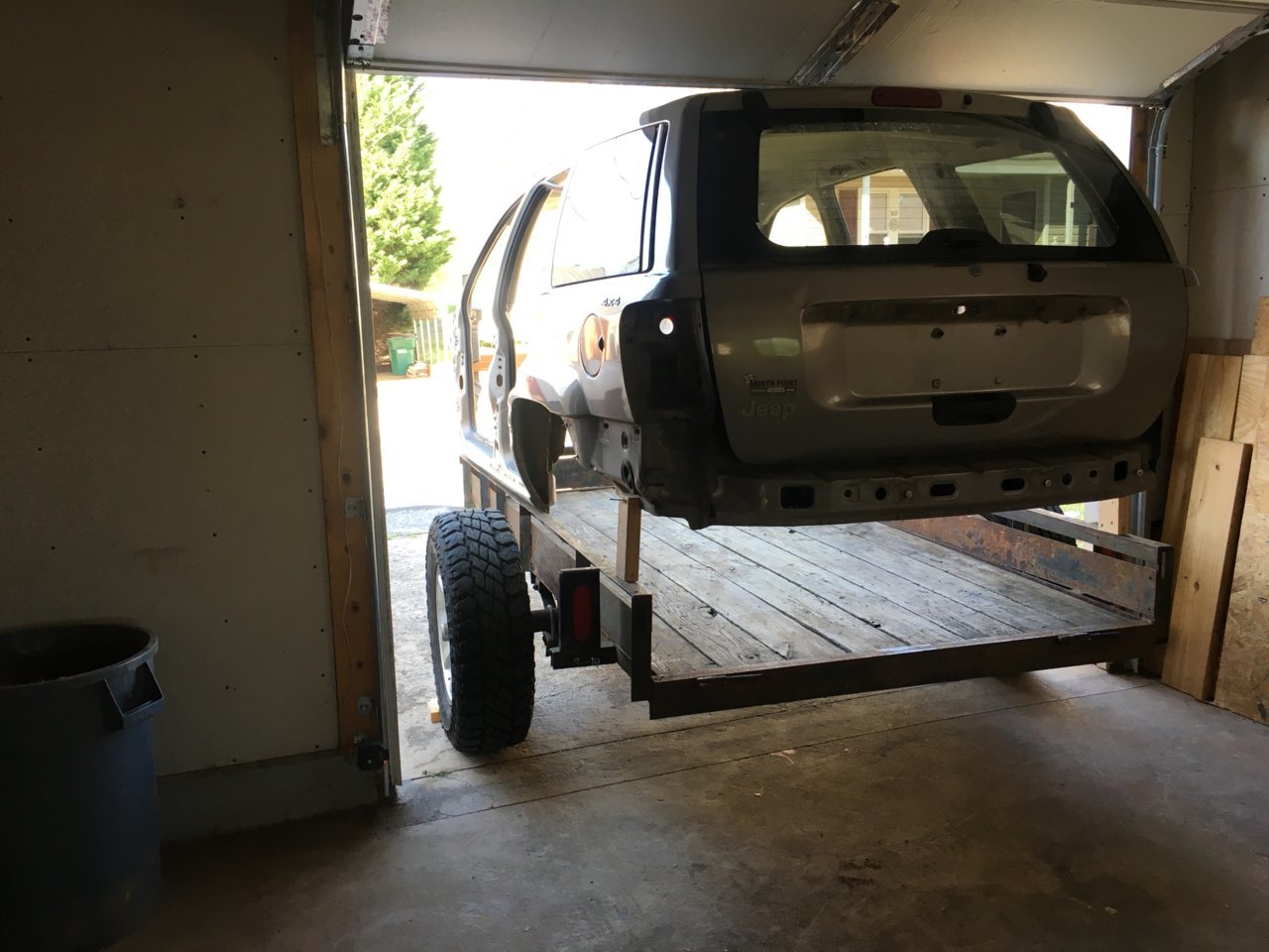

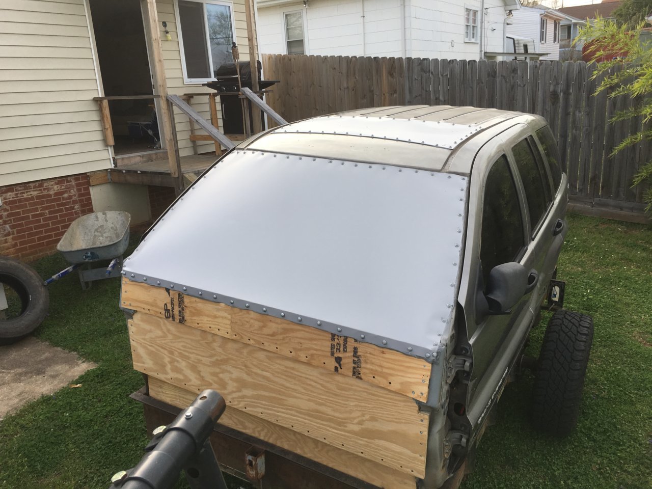

    Well, it is pretty much weatherproof now, so I moved it out of the garage. Now I can work on it with a little more space and sunshine. Also the backyard is much more private with less chance for intrigued neighbors to interrupt, LOL. More importantly though, but Tacoma gets its garage back.

    Welcome to the party.:cheers: I think I'm going to get a bumper sticker for it that says "It's a Jeep thing".
