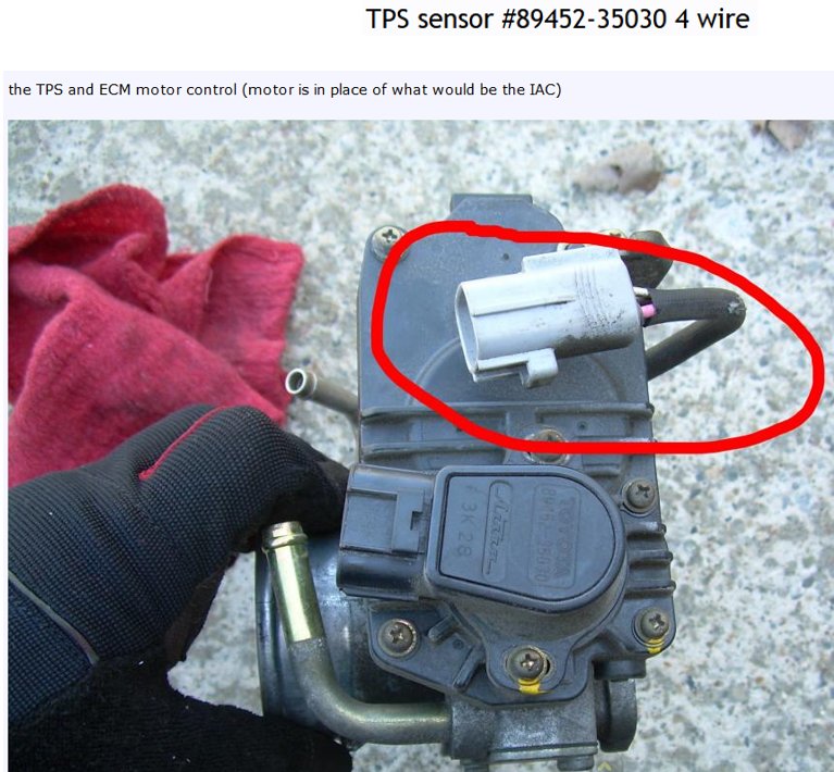

    I "believe" TW member frizzman posted this picture of the part in question.

    Well I ended up buying a used throttle body on eBay, just put the tps in and still no luck. Wtf!!

    There's 3 parts on that throttle body if i'm not mistaking. have you tried switching out complete throttle bodies

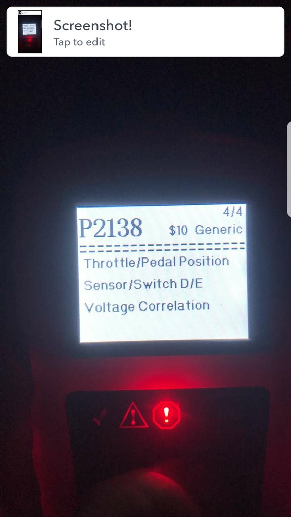

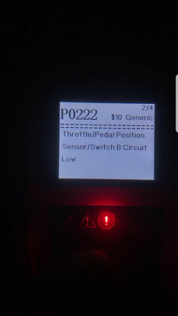

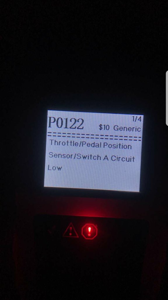

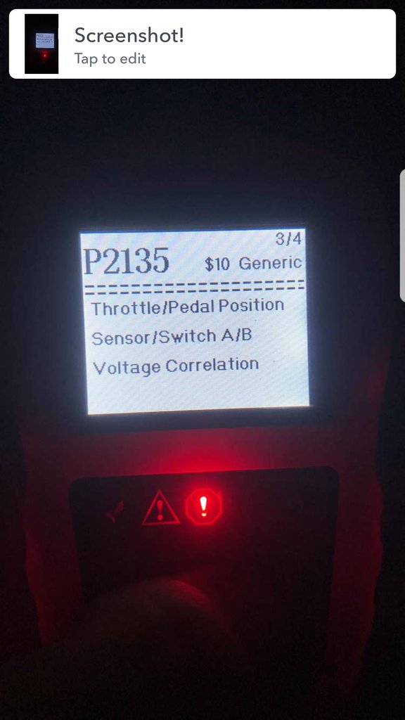

    Still getting a code? What code? What are the symptoms?

    im no mechanic. but if the wire's or plugs still have mositure or mud in them would it throw this code?
    i would find a wiring diagram and trace all the wires and plugs down on that circuit and blow them out with compressed air and make sure their clean

    yep i just goggled all those codes and they can all be caused by faulty wiring. i would definitely chase down all the wiring and plugs and make sure they are clean and dry. the next step would be an ecm

    Your getting TPS codes. I'd unplug igniter and blow the connection out. make sure its dry.
