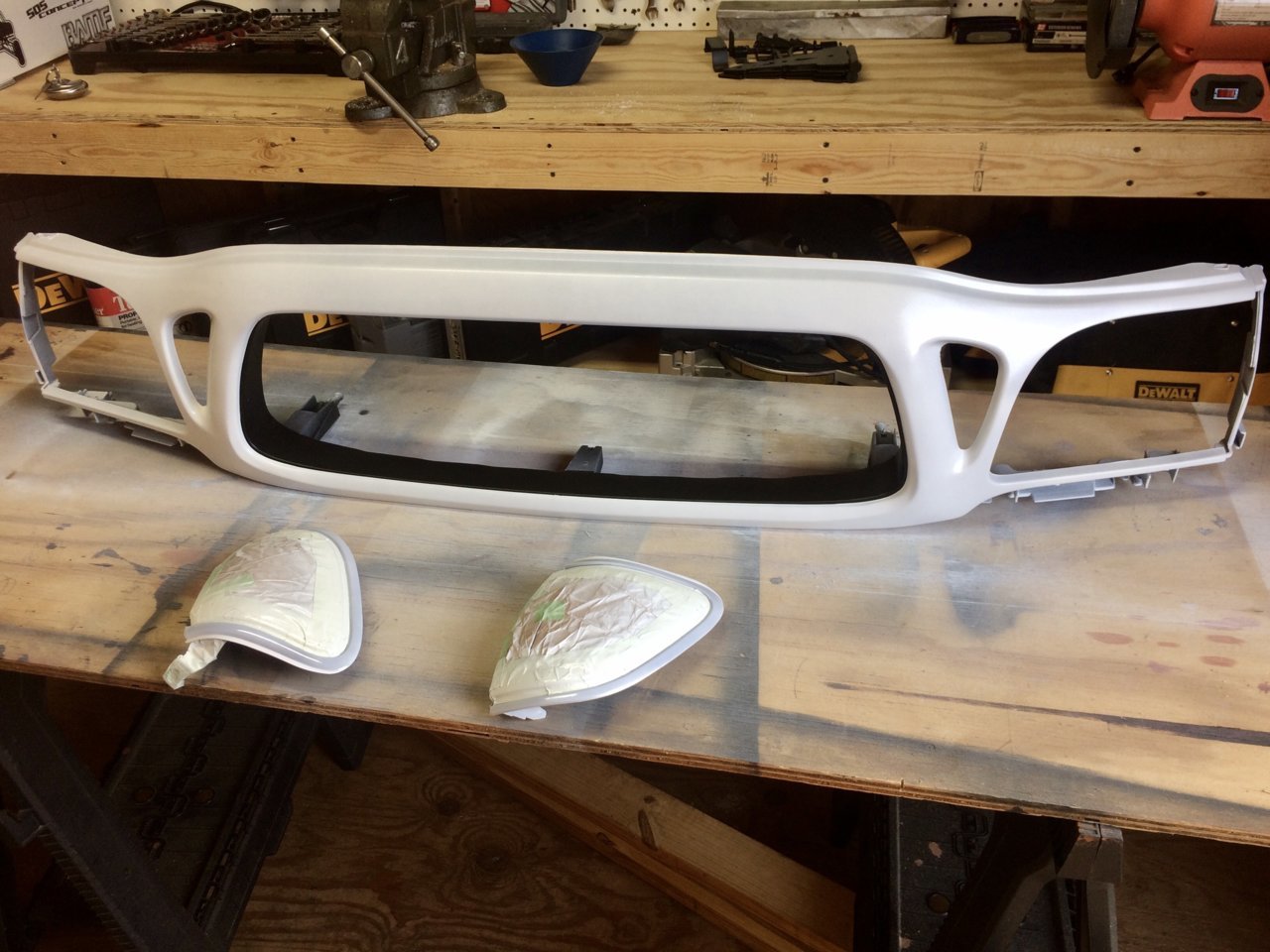

    Back to the Satoshi Grill
    December 29, 2018 - Well, it's been over a year since I started this thing so I guess it's about time I finish it. I went to the local paint supply shop, gave them my exterior color code from the door jamb and they mixed some SEM brand paint in an aerosol can. They recommended some expensive aerosol clear coat that had some sort of hardener. Got home, taped off the black painted portion and back to the paint booth it went.

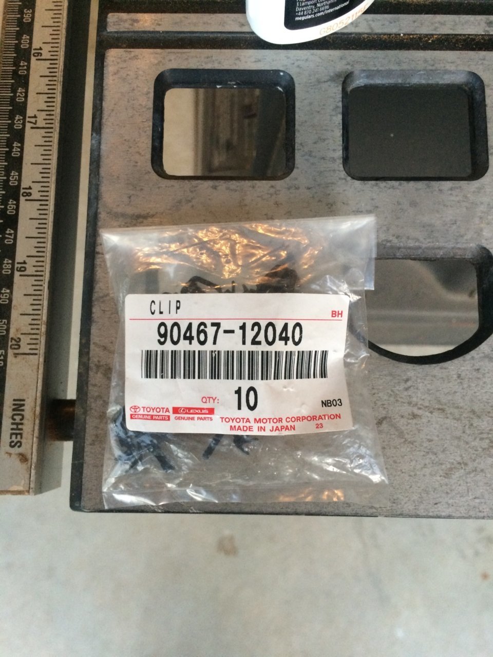

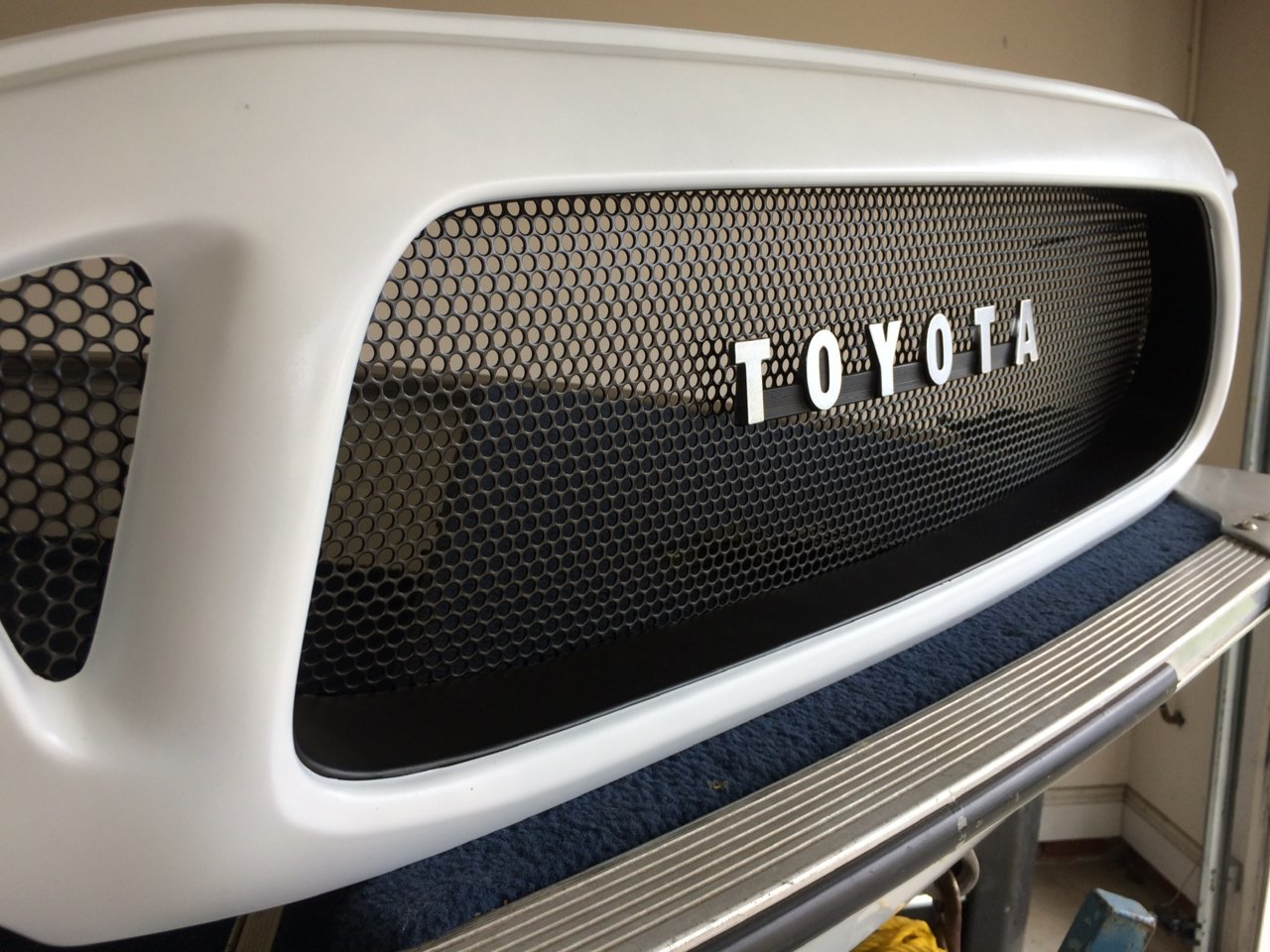

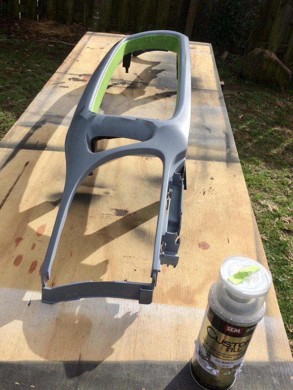

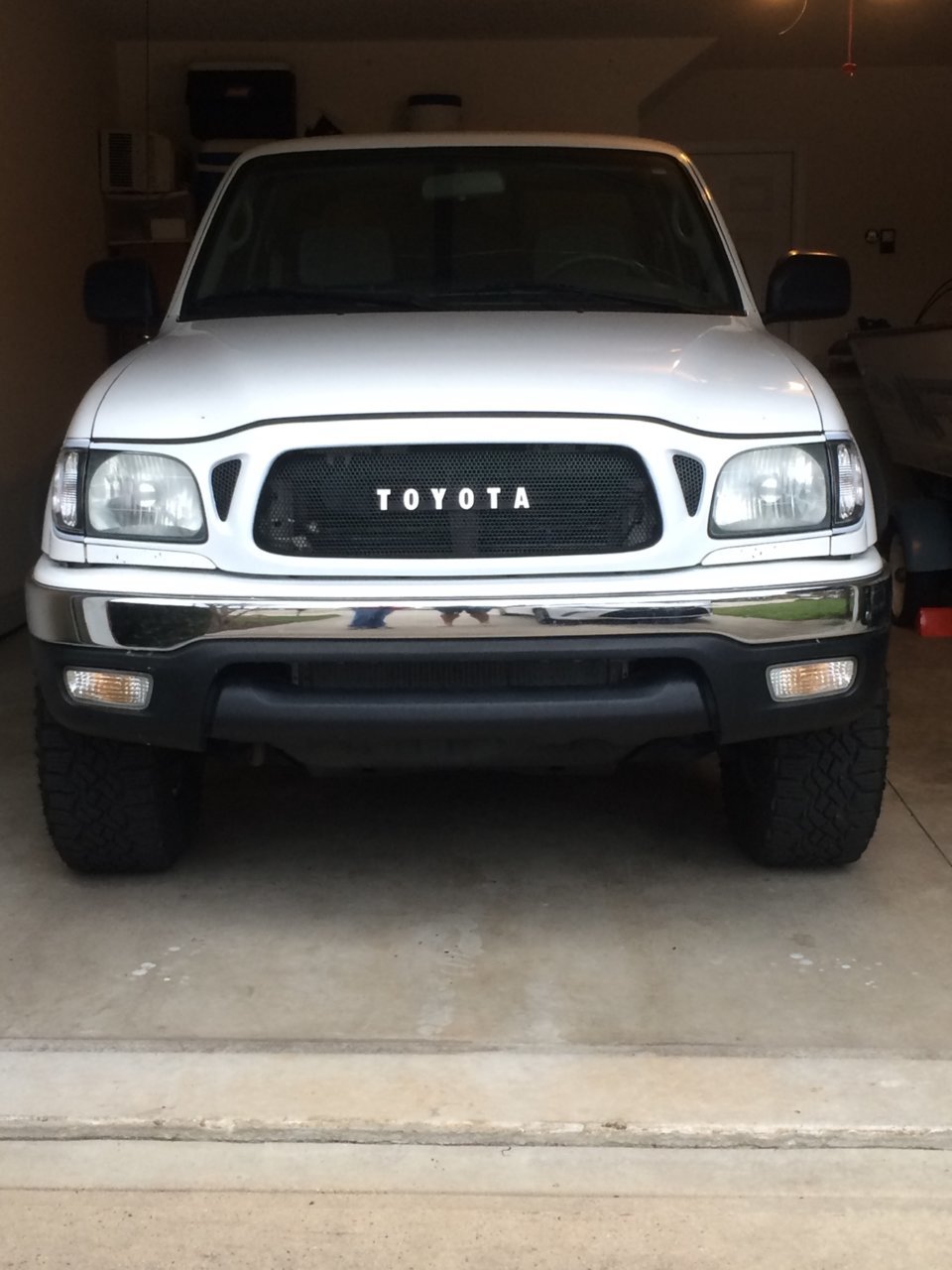

    Back to the Satoshi Grill Part II

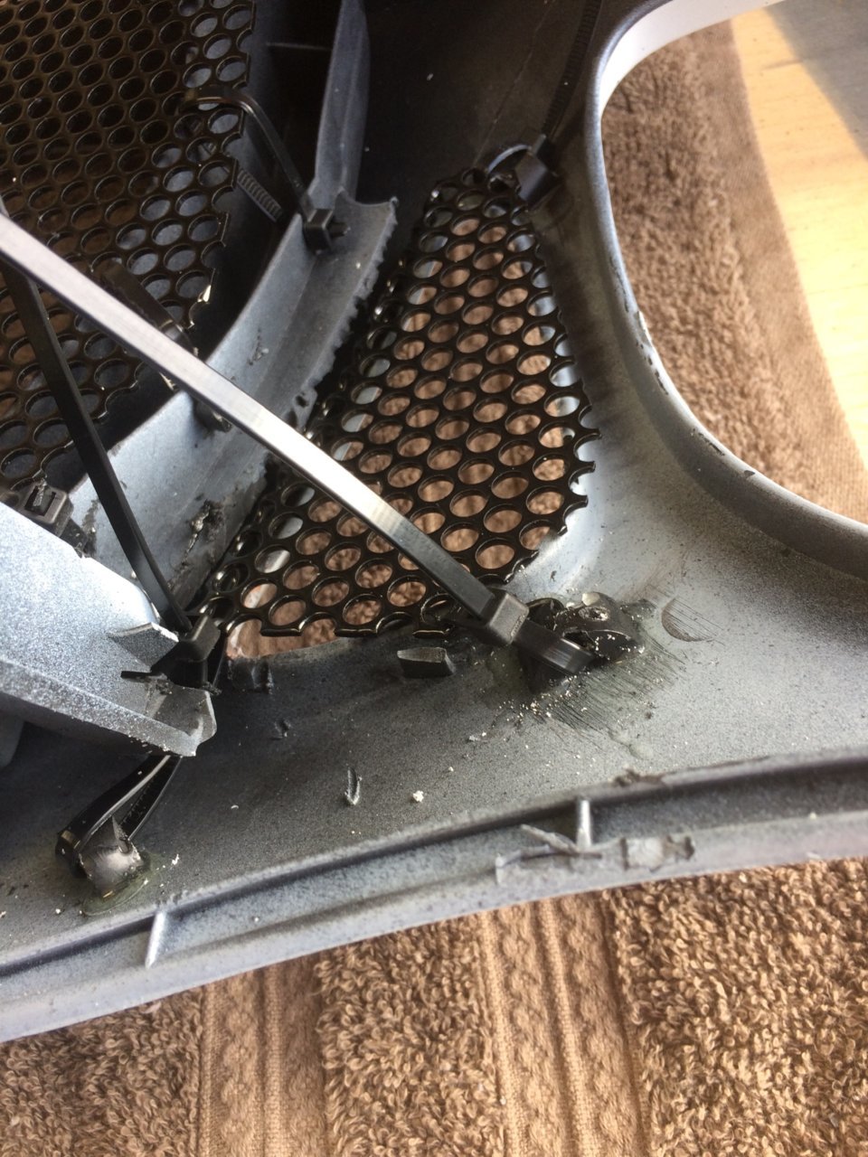

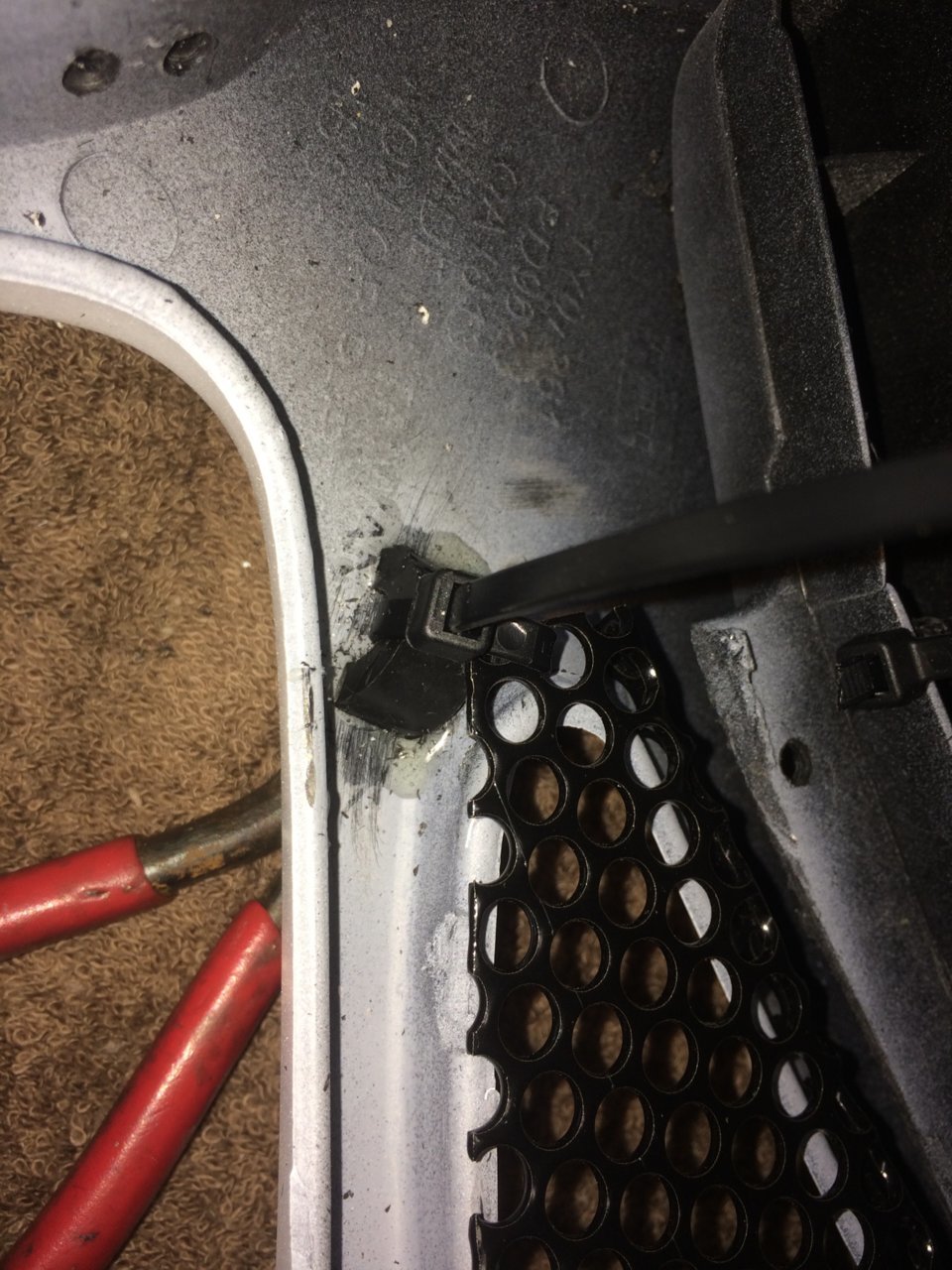

    January 27, 2019 - Some zip ties, plastic washers cut in half, some JB Weld Plastic Weld and the mesh was in. Added the Toyota emblem, part # 75321-60010 and this thing was done. It's got some defects if you look closely but I never claimed to be a paint and body guy.

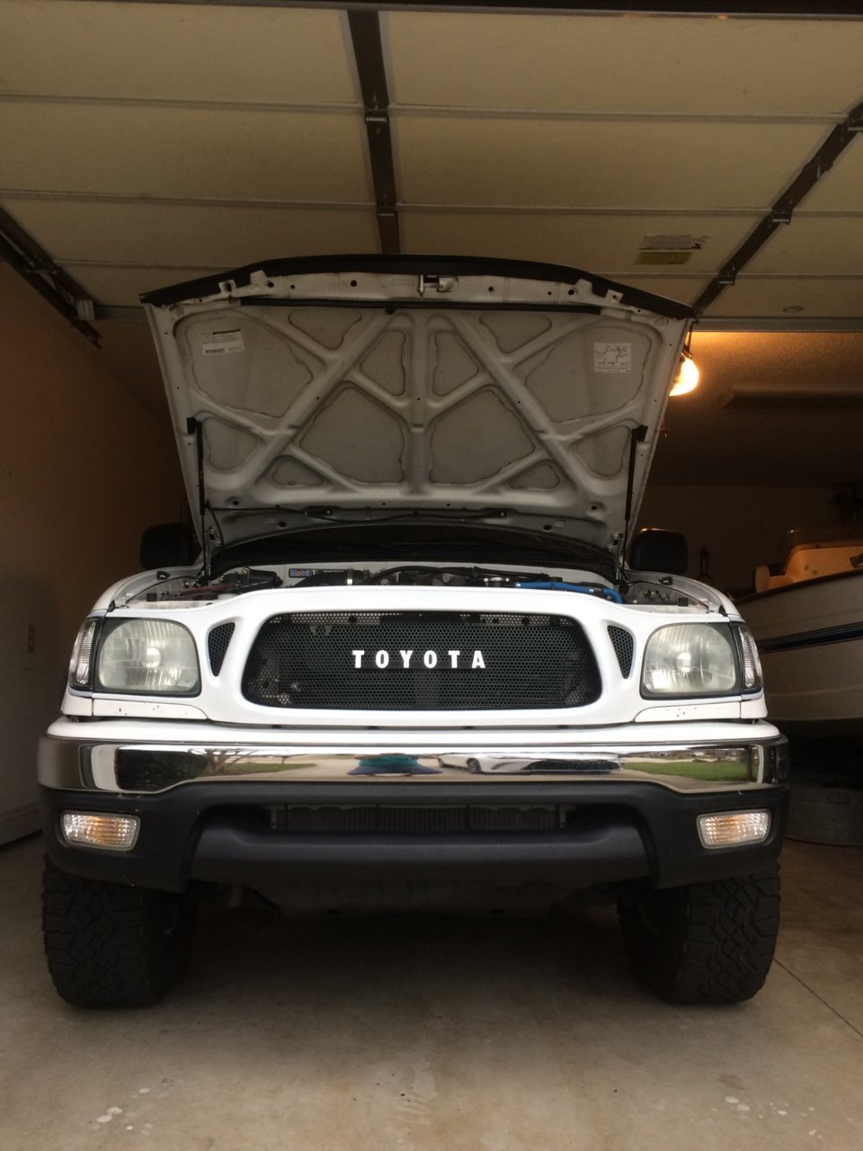

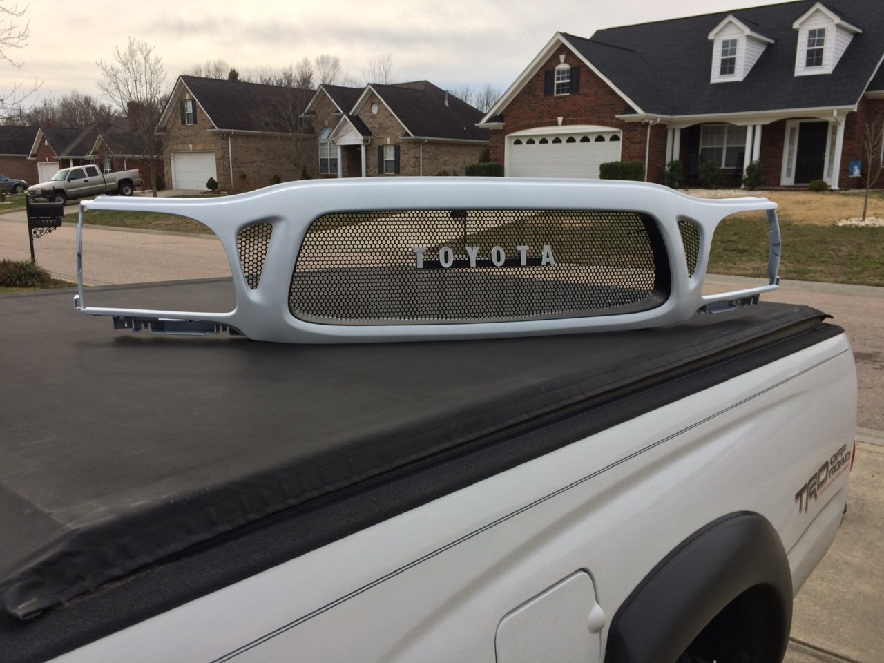

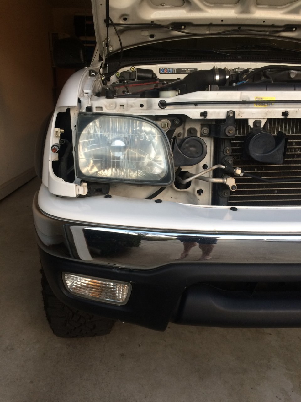

    Back to the Satoshi Grill Part III

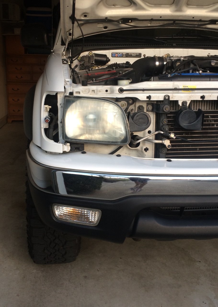

    February 4, 2019 - Removed the OEM grill and side markers, attached the aftermarket clear corners that I had also color-matched and the Satoshi grill.
    I also used this opportunity to polish the headlights.
  5. May 21, 2020 at 8:53 PM
    #45
    boostedka
    boostedka Well-Known Member
    Sep 29, 2011
    #64367
    6,023
    James
    NM
    2013 DCSB 6MT, 2004 4runner
    Wow! That’s front end came out awesome. That’s some sic work you put into that grill
    SwampYota[OP] likes this.
  6. May 22, 2020 at 6:20 AM
    #46
    SwampYota
    SwampYota [OP] Strange things are afoot at the Circle K
    Apr 11, 2016
    #184044
    4,306
    Jon
    Concord, North Carolina
    '03 Tacoma SR5 TRD 5VZ-FE, 5 Speed
    Floor mats
    Thanks man! Yeah it’s still holding up, though I keep seeing the 3rd Gen TRD Pro grills put on 1st Gens now and think I may switch it up. We’ll see.
    boostedka[QUOTED] likes this.

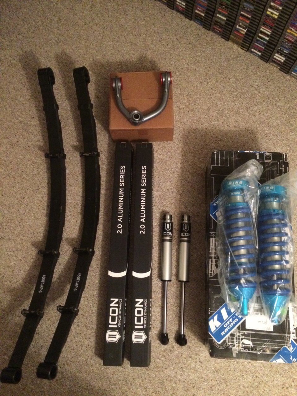

    Additional Lift Parts Ordered

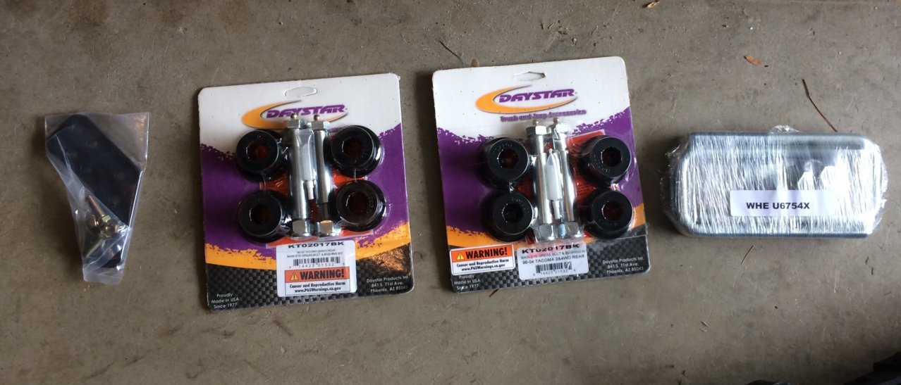

    April 3, 2019 - I needed a couple more parts for the lift set up. For the leaf spring front hangers and the stock shackles I ordered some Daystar Greaseable Bushings, part # KT02017BK. I needed longer U-Bolts and didn't want to reuse the OEM anyway so I went with a 6.75" Wheelers Off-Road Inc. U-Bolt Kit, part # WHE-U6754X. Finally, I ordered a BAMF 3.5" Brake Proportioning Valve Bracket, item # 19.
    Last step, request April 15-19, 2019 off work to install the lift. PTO approved.

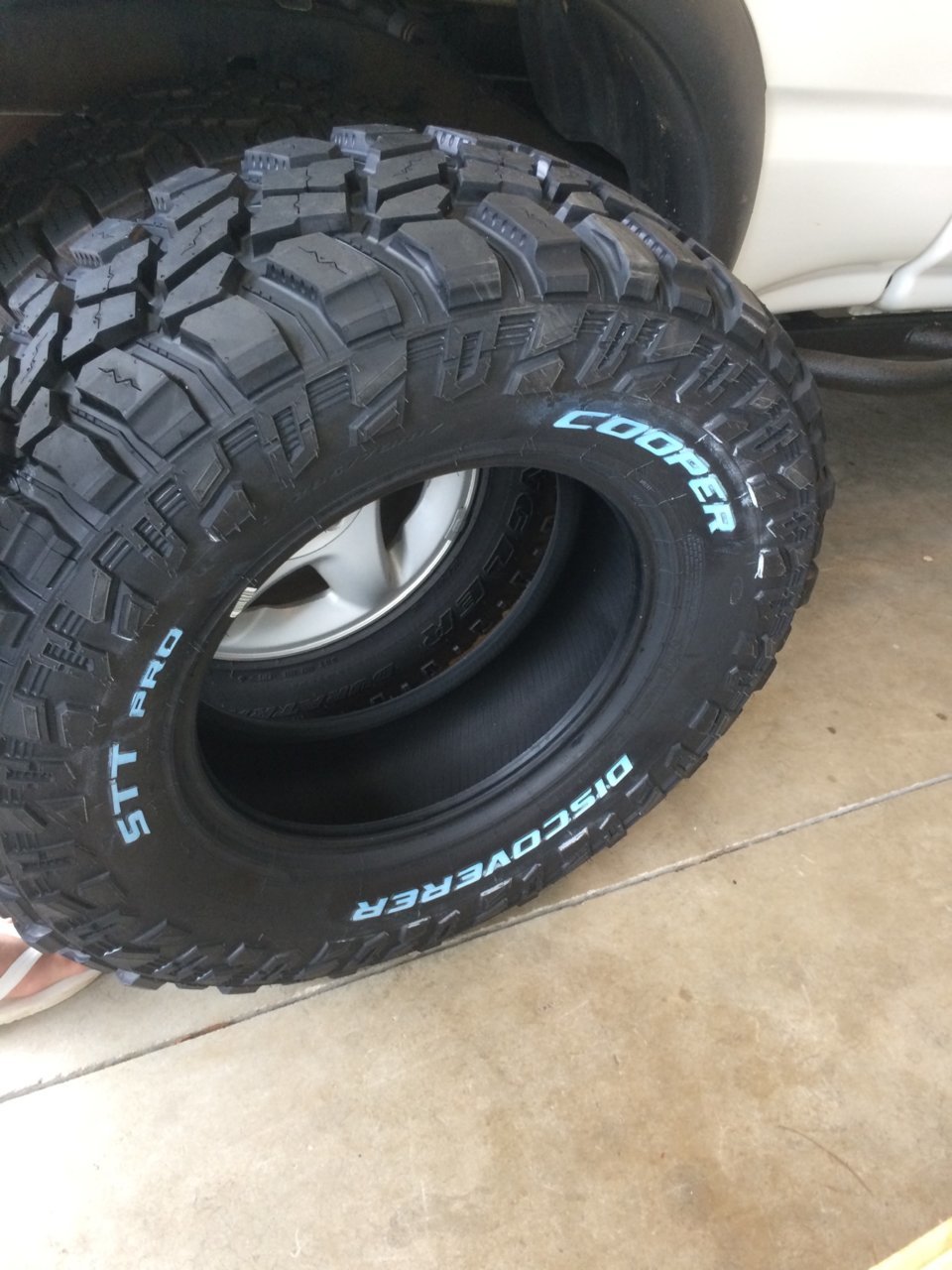

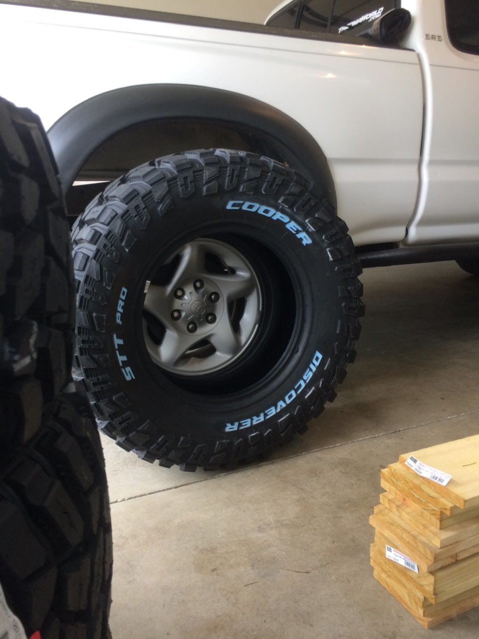

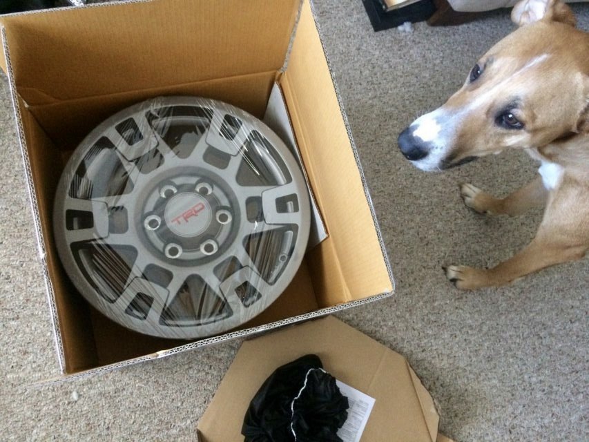

    New Tires and Wheels

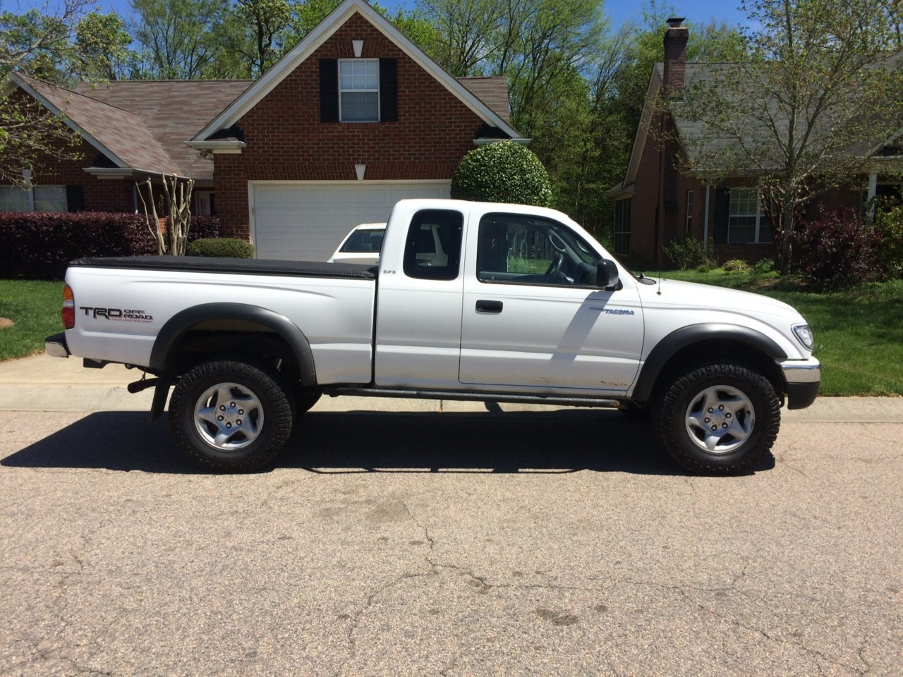

    April 6, 2019 - With the lift these 265/70R16 tires weren't going to look quite right so I ordered some 285/70R17 Cooper STT Pro's to wrap around the Toyota SEMA wheels, part # PTR20-35110-GR. The wheels, like many parts I buy, had been sitting around for a few years. I bought them sometime in early 2017.

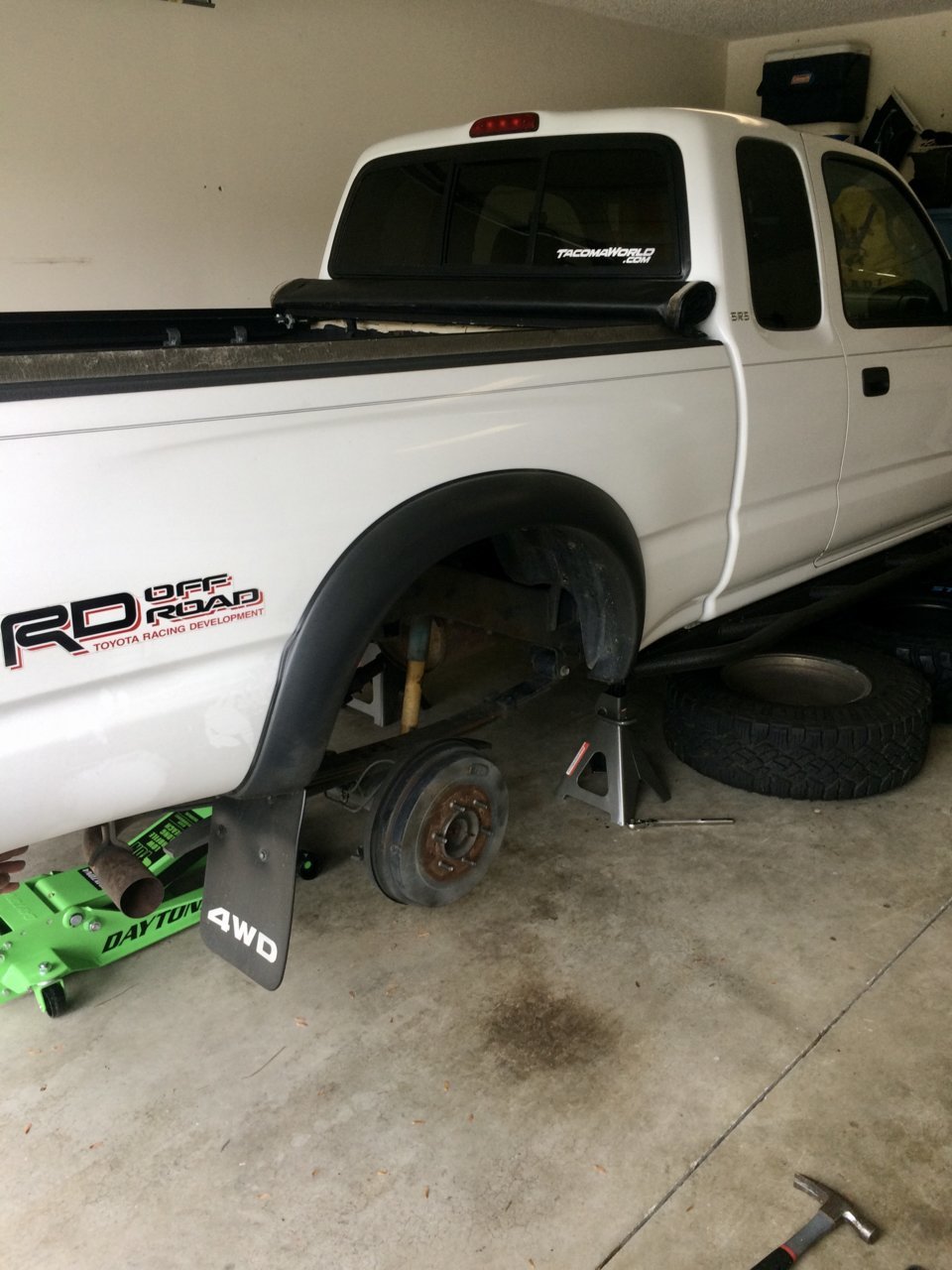

    Lift Install, Day 1
    April 14, 2019 - My Dad took the week off as well to join in the fun, and looking back I must say I really enjoyed wrenching on the truck with him that week. It was the first time either of us had attempted something like this. The front wheels were chocked, rear wheel lug nuts were loosened then it was jacked up and the rear wheels were removed. These were placed under the truck for added fall protection along with two jack stands. Time to begin.
  11. May 22, 2020 at 1:58 PM
    #51
    boostedka
    Sep 29, 2011
    #64367
    6,023
    James
    NM
    Nice wheel and tire choice! How are those STT Pros doing? I'm guessing they are E rated? I had some on my first gen in a C rated. I thinking about getting some in a size that is only E though.
  12. May 22, 2020 at 2:05 PM
    #52
    SwampYota
    Apr 11, 2016
    #184044
    4,306
    Jon
    Floor mats
    Thanks! Yeah, they're E-Rated. Great in the dirt, loud on the road and you feel every bump but I like them. I just realized, you're not in that turbocharged 1st Gen anymore?

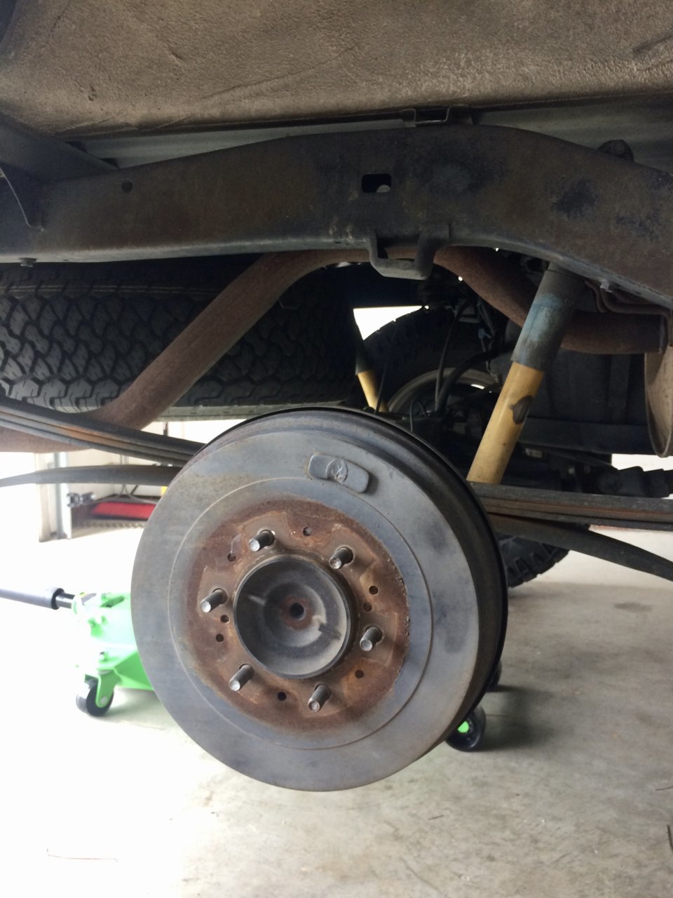

  14. May 22, 2020 at 6:06 PM
    #54
    Ccrowe323
    Ccrowe323 Well-Known Member
    May 10, 2018
    #253126
    364
    Cory
    Florida
    2001 Tacoma 3.4 DC 5speed TRD OR

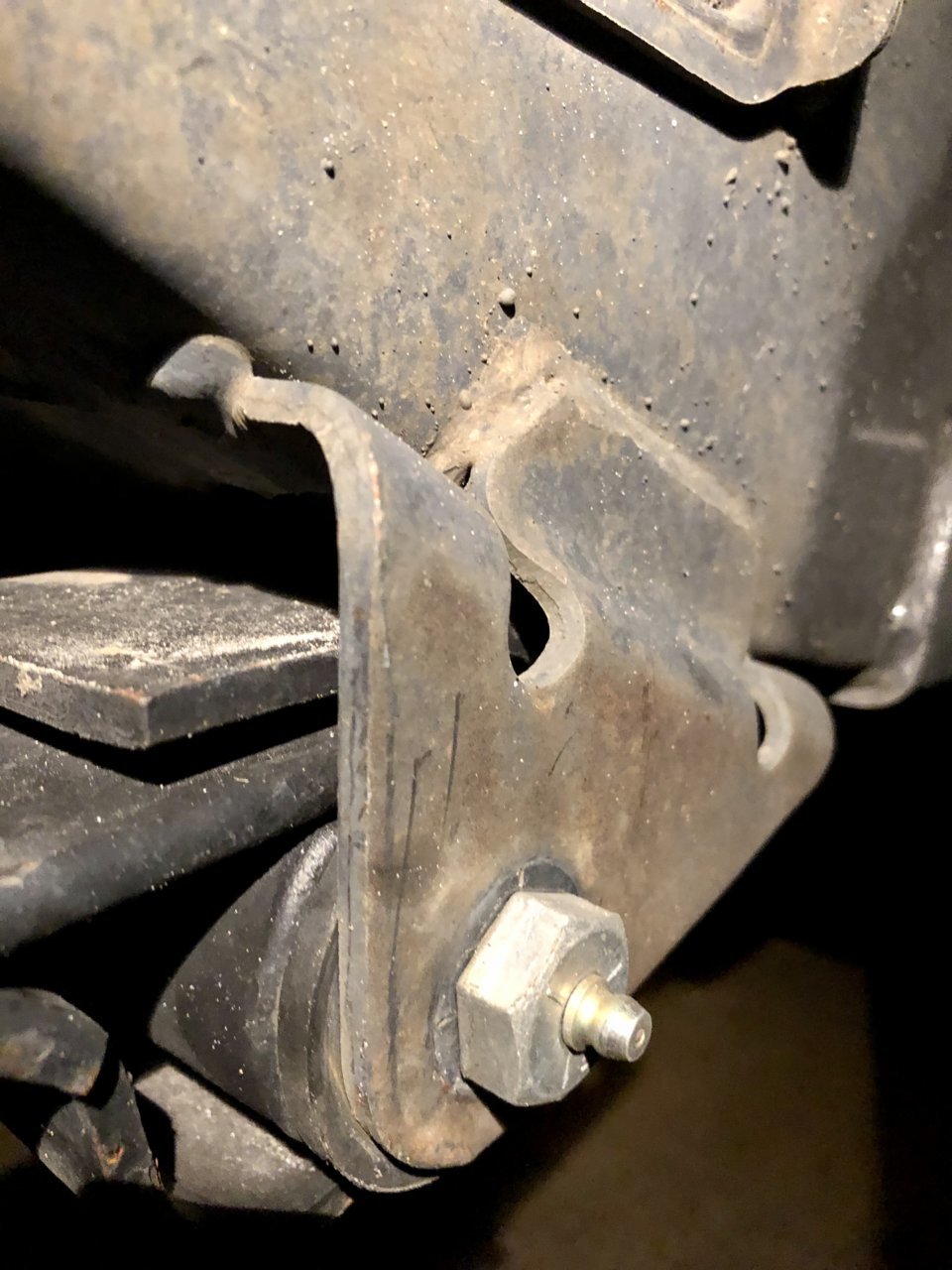

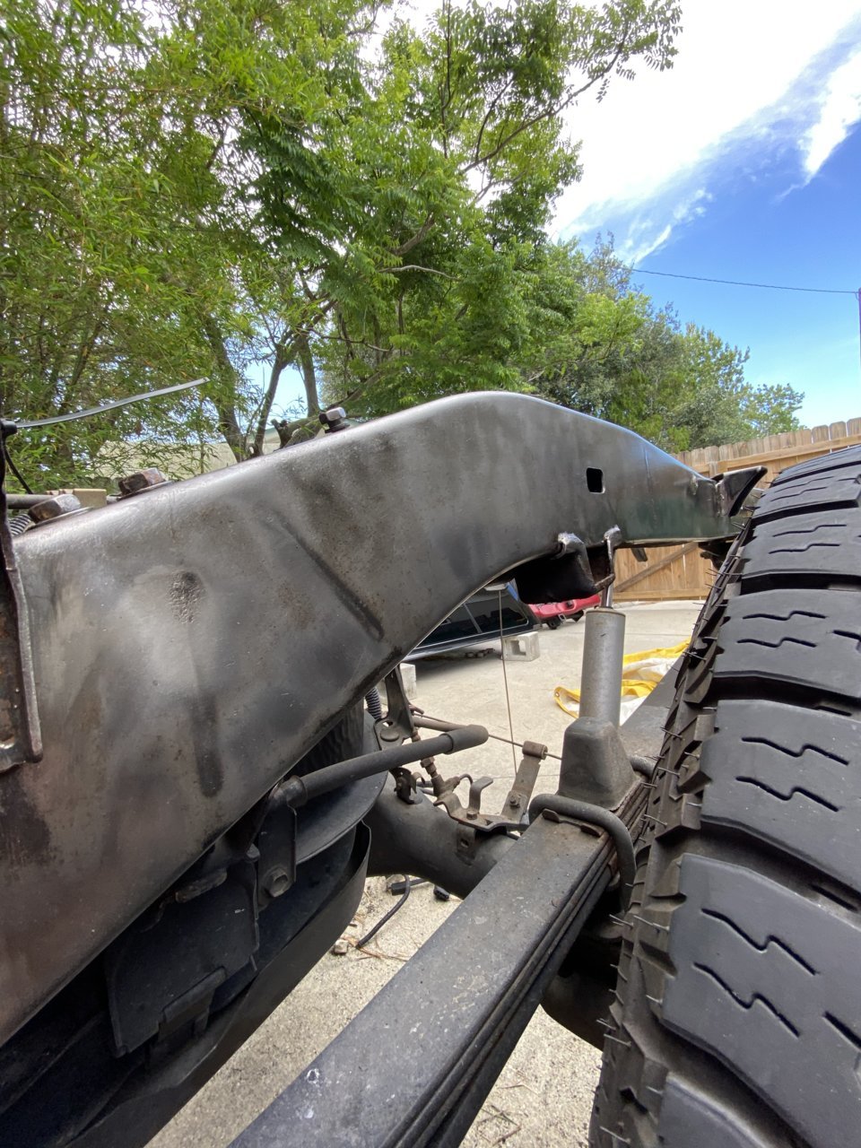

    Dude nice build but you might wanna take care of that rust on the frame or all of that awesome stuff isn’t going to mean much when the frame falls apart.
    You’ve got a nice build going on!
    SwampYota[QUOTED][OP] likes this.
  15. May 22, 2020 at 6:32 PM
    #55
    SwampYota
    Apr 11, 2016
    #184044
    4,306
    Jon
    Floor mats
    Thanks for the kind words man. Yeah it’s all surface rust, no flaking and I’ve banged it everywhere with a ball peen hammer. Taking the shocks and leaf springs off was issue-free last year, but I need to stop it before it gets any more invasive. That’s on the short list of to-do’s.
    Here’s a picture of the front leaf spring hanger up close for reference, this is a major failure point on rusted frames. There is surface rust but it’s not ugly yet. To your point, I do need to address it before it gets deeper.
    Ccrowe323[QUOTED] likes this.
  16. May 22, 2020 at 6:50 PM
    #56
    Ccrowe323
    May 10, 2018
    #253126
    364
    Cory
    Florida
    Right on man, looks better than the little bit on my frame lol.
    Coat it with Fluid Film, it’s a oil undercoating that will stop the rust and prevent any more from growing as it penetrates the metal. It’s decently cheap too. You have to reapply at least once a year but it actual will prevent the rust. And make sure to spray the inside very good as well. If I remember correctly the kit with spray gun is about $100 or so for a gallon. I’ve had my gallon for about two years now. It last a long time and really does work. Only downside is having to reapply but your frame will love you for it lol
    I’m in the middle of grinding off the paint and rust off my frame to repaint with clear coat so I can see any future rust. I will definitely be applying at least 2 times a year living in Florida by the ocean. Salty air sucks
    Edit: my bad it’s like $160 For the whole kit but the gallon will last you a good 6 coats inside and out. Or just buy the straight gallon for like $40 and paint it on by hand. But the inside in crucial
    https://www.amazon.com/Woolwax-Gall...keywords=fluid+film+kit&qid=1590198657&sr=8-6

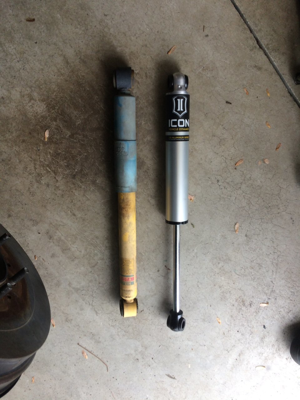

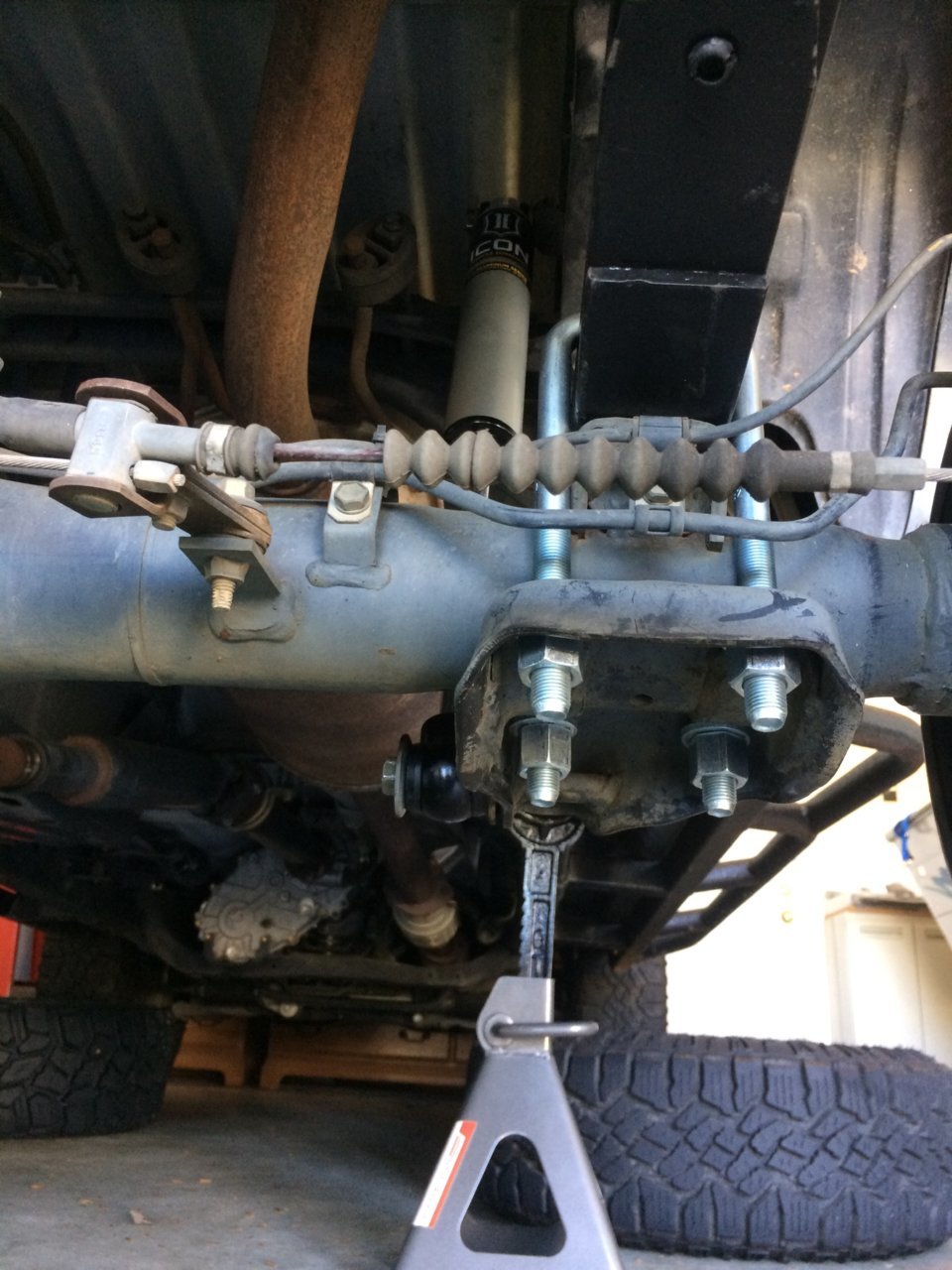

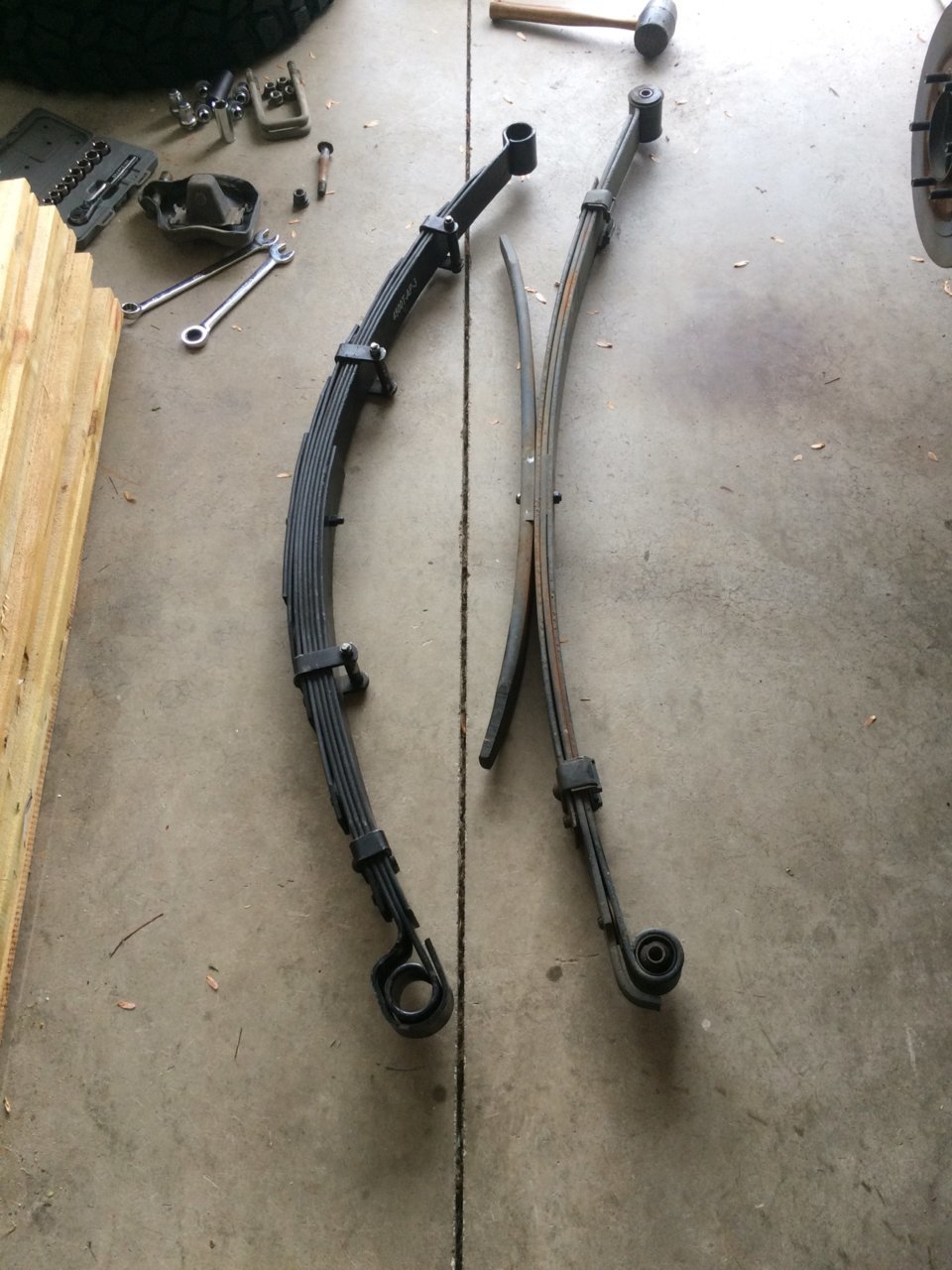

    Lift Install, Day 1 Continued

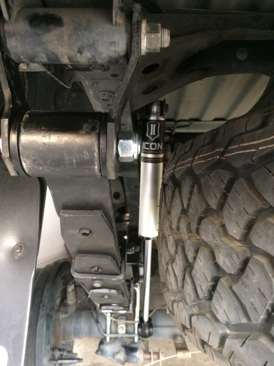

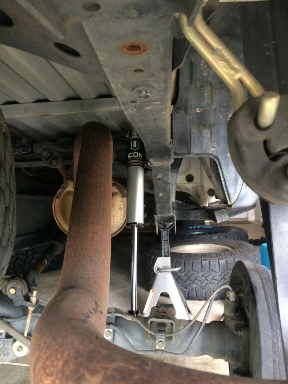

    April 14, 2019 - Shocks, u-bolts and springs were removed and replaced. The greaseable bushings were installed in the front eyelet and rear shackles. Productive day 1.

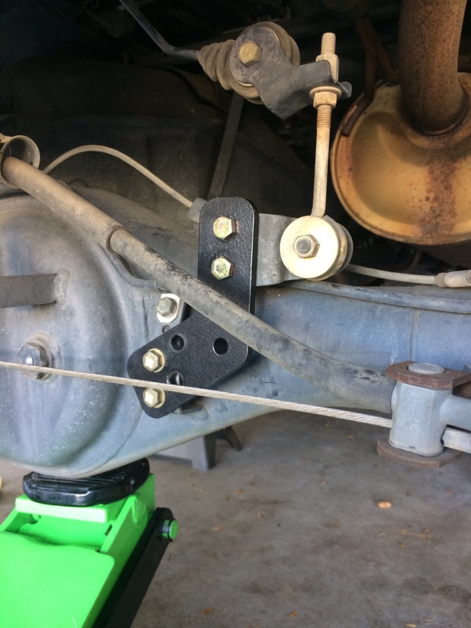

    April 15, 2019 - Today we torqued everything to spec, installed the BAMF BPV bracket and put the tires back on for a quick test drive. Everything was good, check out that rake.
