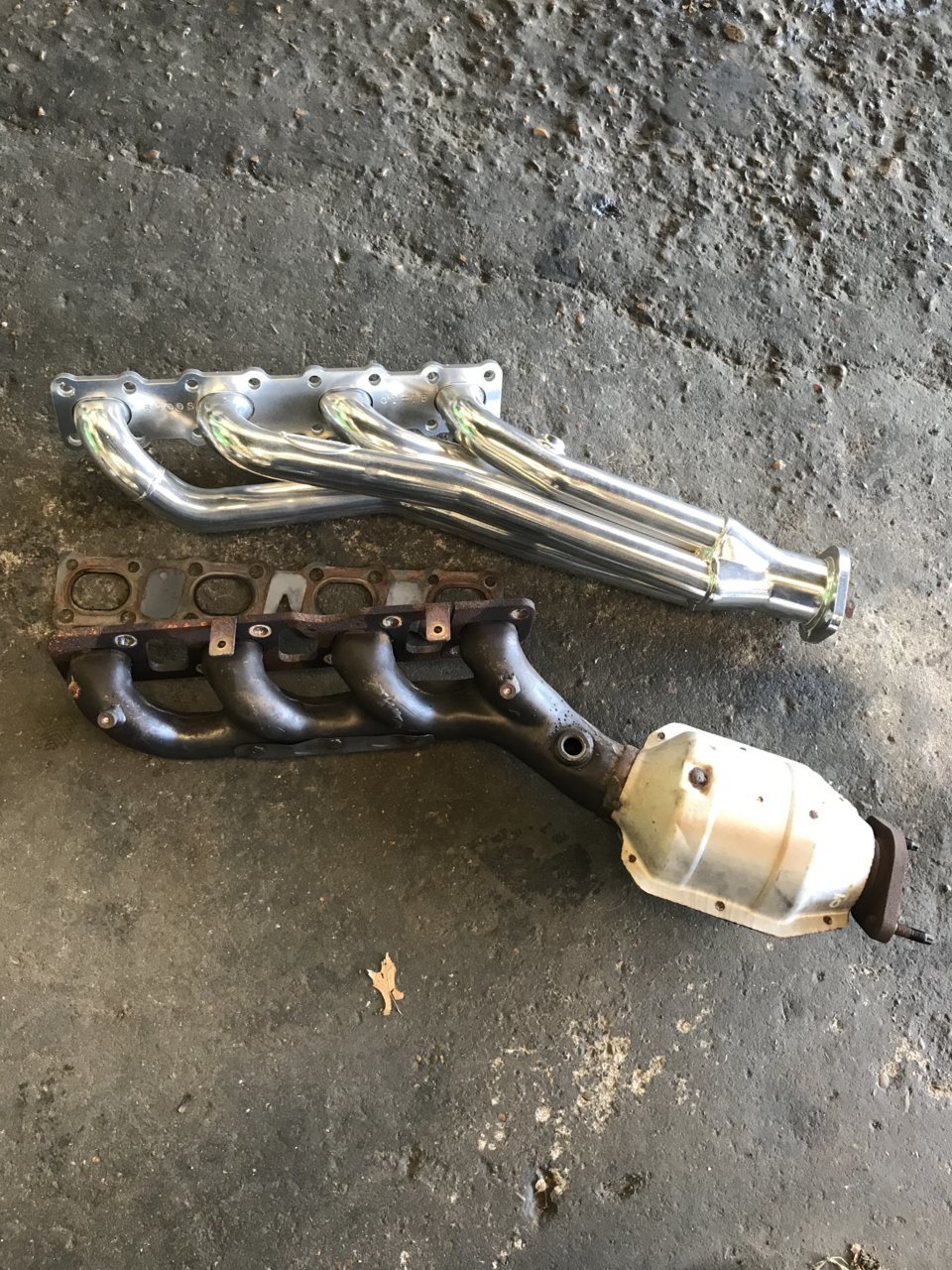

    Not tacoma related but I’m doing a small build on a friends Titan. 3” lift with headers. Did new motor mounts while I was In There too.
    The instruction sheet was correct, I beat the piss outta the heat shields

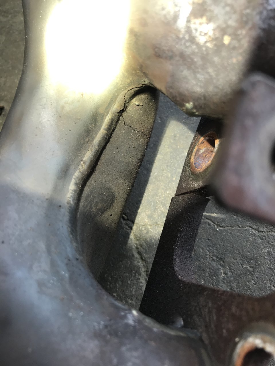

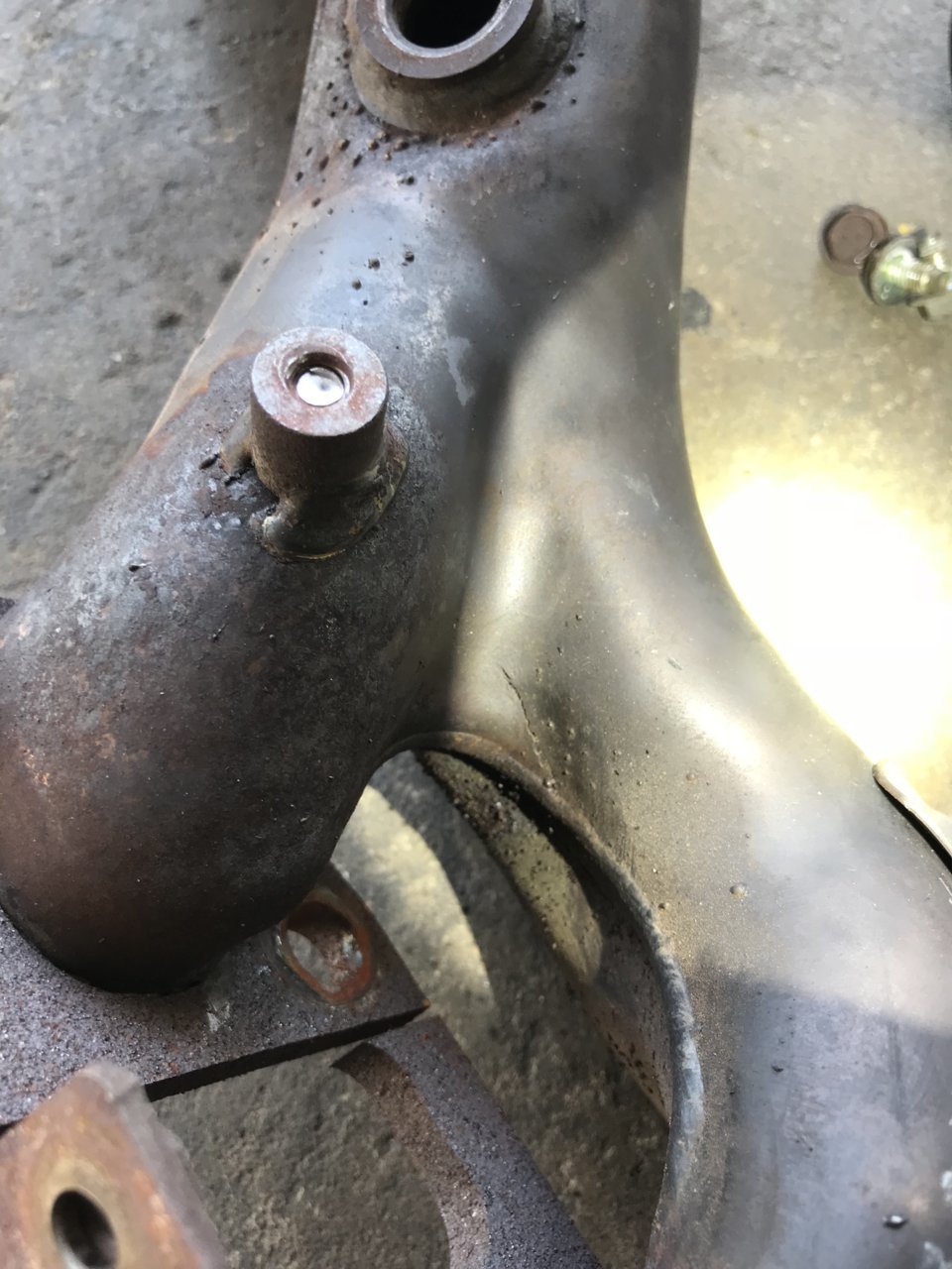

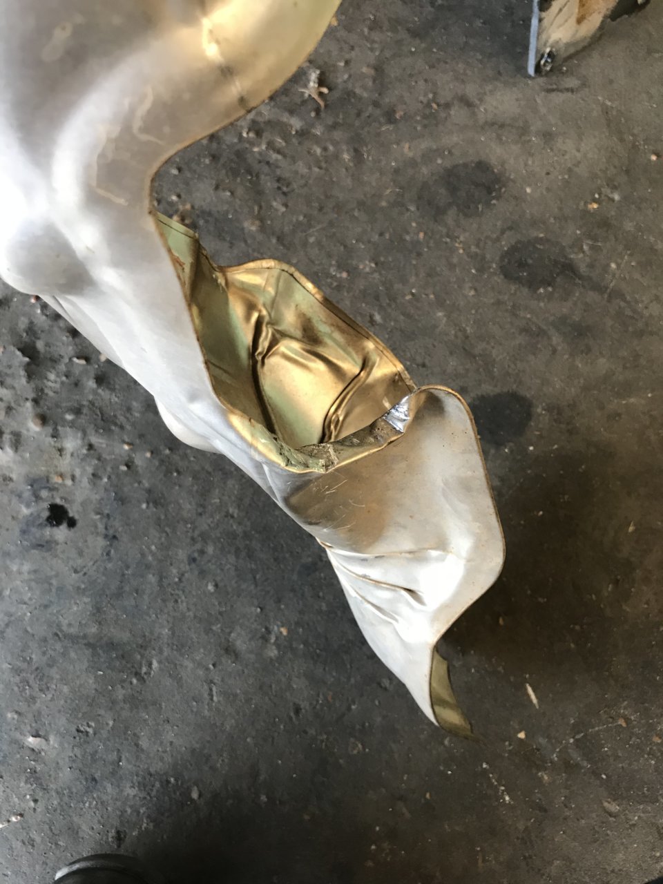

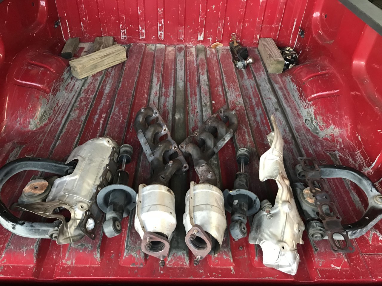

    You can see where both factory manifold converters were cracked causing an air leak and check engine light

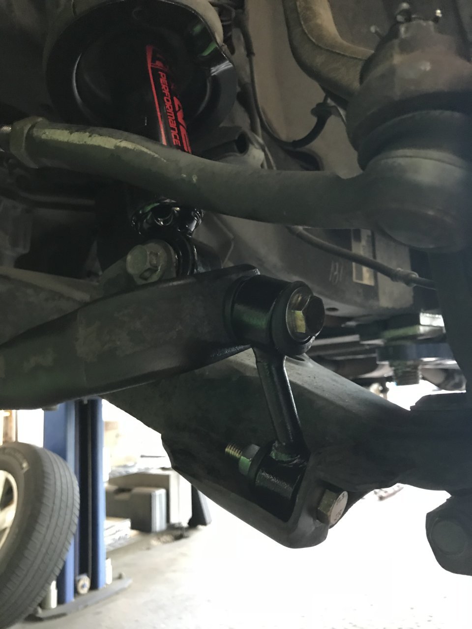

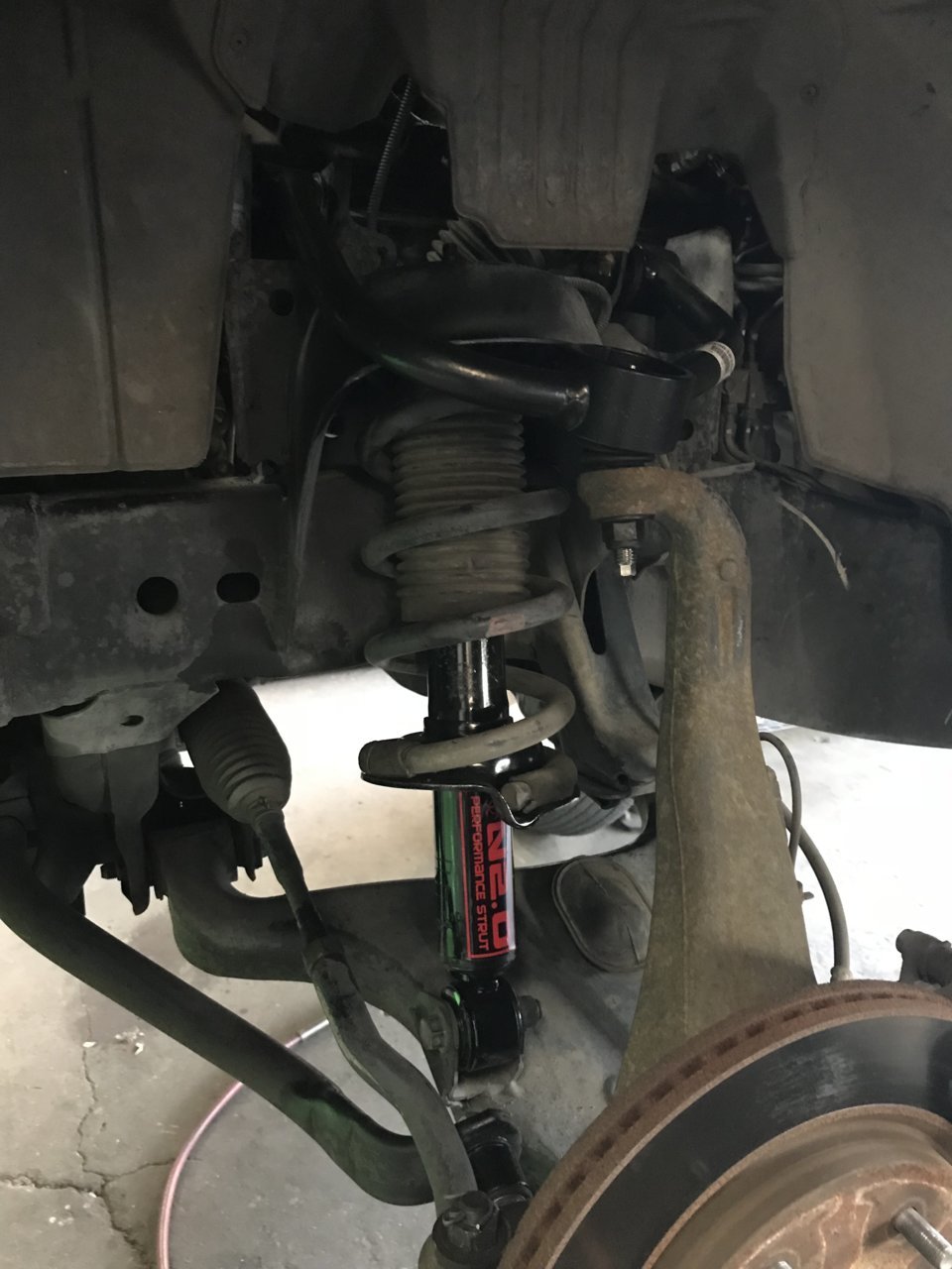

    New lift struts, tubular UCAs, had to modify (shave) the outer coil bucket edge to clear the forward UCA arm at full droop, then hit it with matte black rustoleum so you don’t even notice. And new sway bar links

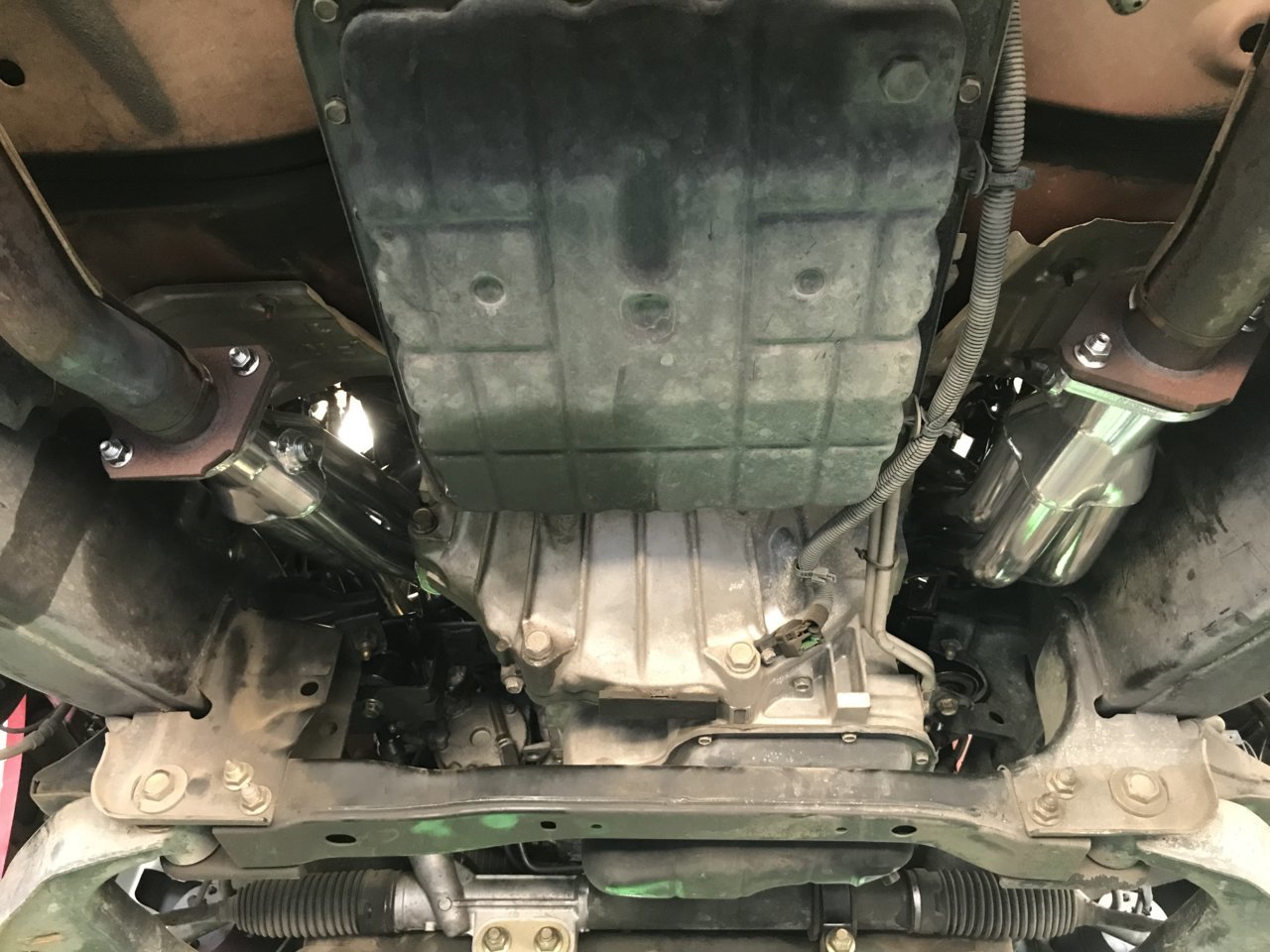

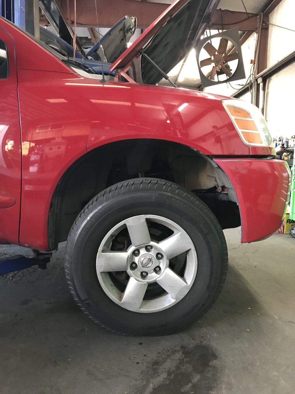

    Resting on its own front weight
