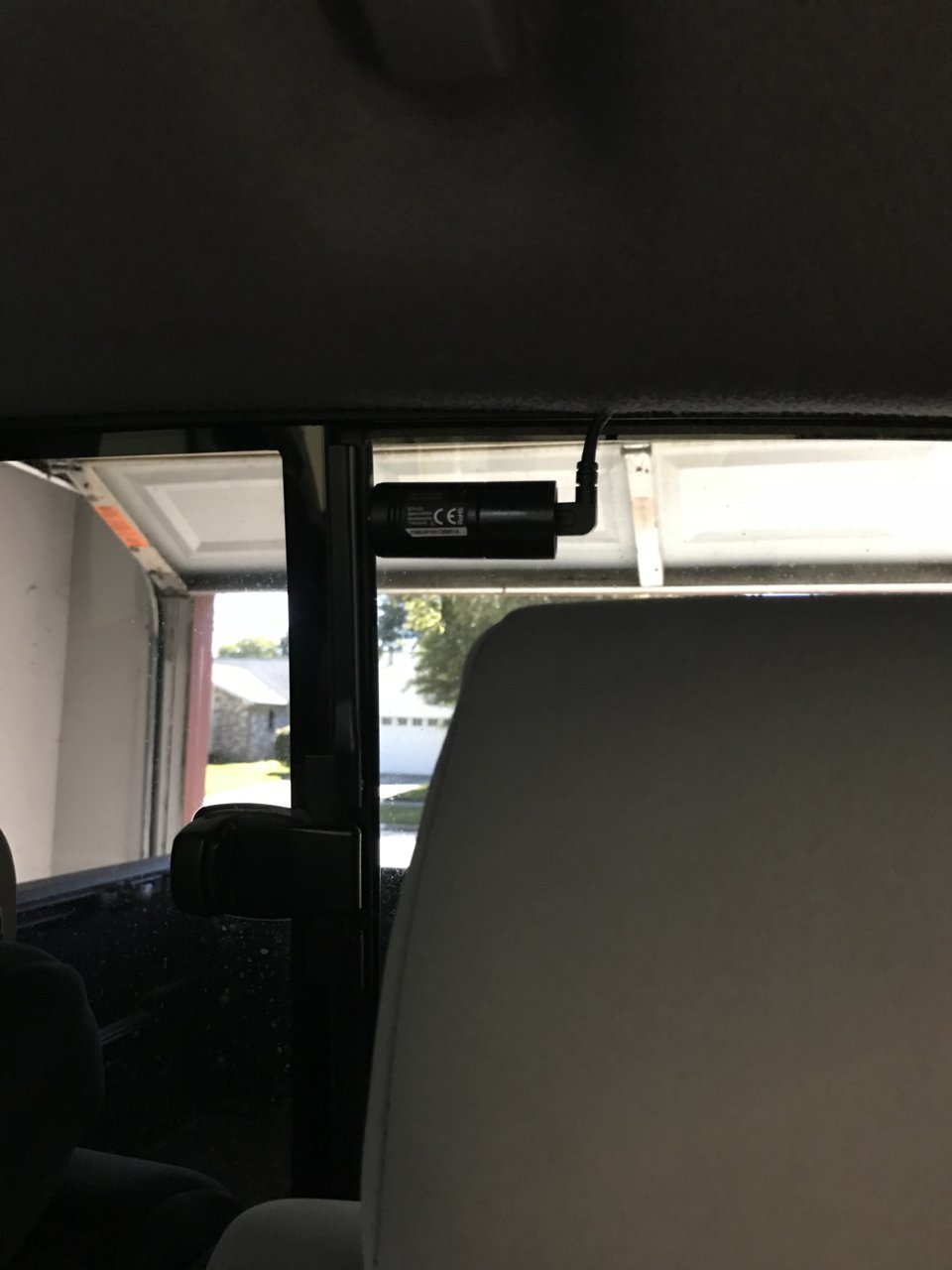

    Just finished installing the Thinkware F800 Pro dashcam. Front and rear camera, GPS enabled, tracking enabled, hardwired, and has parking mode recording. The quality is awesome and I can access live feed from my phone and download files wirelessly from the camera to the phone.

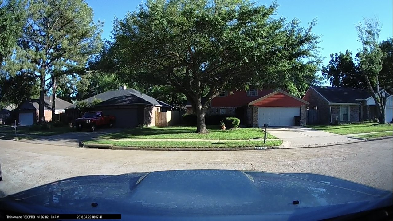

    It’s dark in my garage right now but the small rear cam on the back glass isnt noticeable when you look in the rear view. And from outside you can’t see it because of the tint. The front camera is hidden from drivers view behind the rear view mirror. Here are a couple shots of the camera output
    239CB1E9-2A5D-4EF3-986F-003DABADBF2A.jpg AEBA5C2A-8C45-48BD-B35C-E289AE8389B4.jpg
    I’m still playing around with the camera settings, night vision sensitivity, etc
    Edit: the rear cam is looking through limo tint (2.5% film)

    Appreciate it! Took me a while to install since I wanted the wires routed as nicely as possible. The rear cam wire didn’t get routed through the headliner, I went across windshield, down the a pillar, through the channels under the kick panels, up the rear and over to the camera, that route also helped use up some of the excess length of the cable so I only had to roll up a small bit. And hardwire routed across windshield, down a pillar and to the interior fuse box and I used add a circuit. What’s nice is you can also unclip the main front camera from the windshield mount and take it out of the vehicle easily

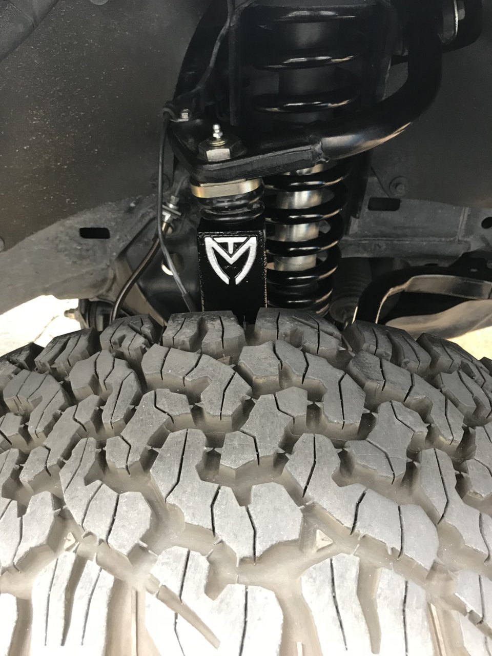

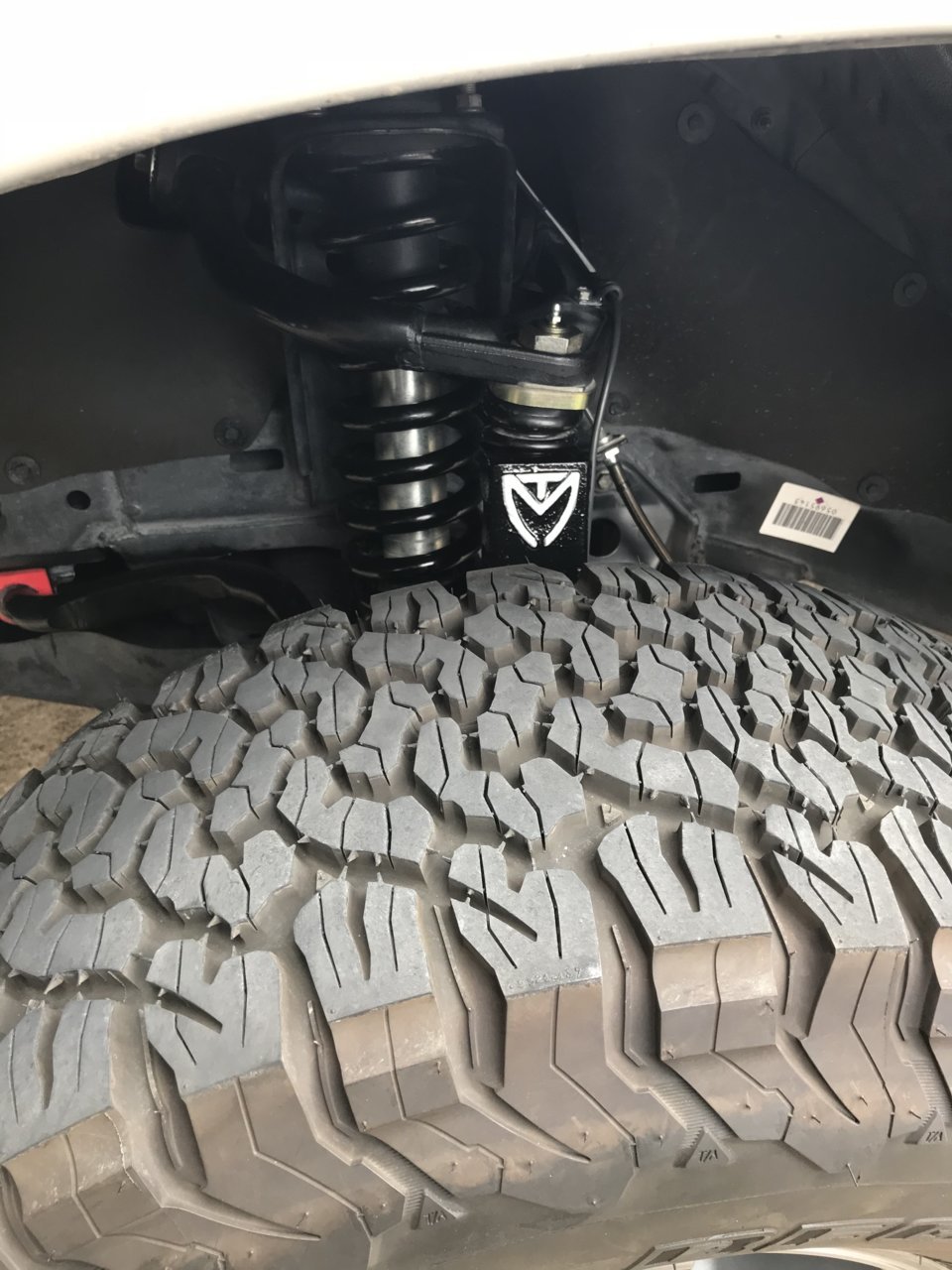

    I began painting the maxtrac symbol on the spindles. Yes I will be touching up with more silver and black, not everyone has a perfect steady hand lol. I’m using a VHT silver header paint and small fine paint brushes. Happy so far

    Clean! Really pops with the raised lettering.
