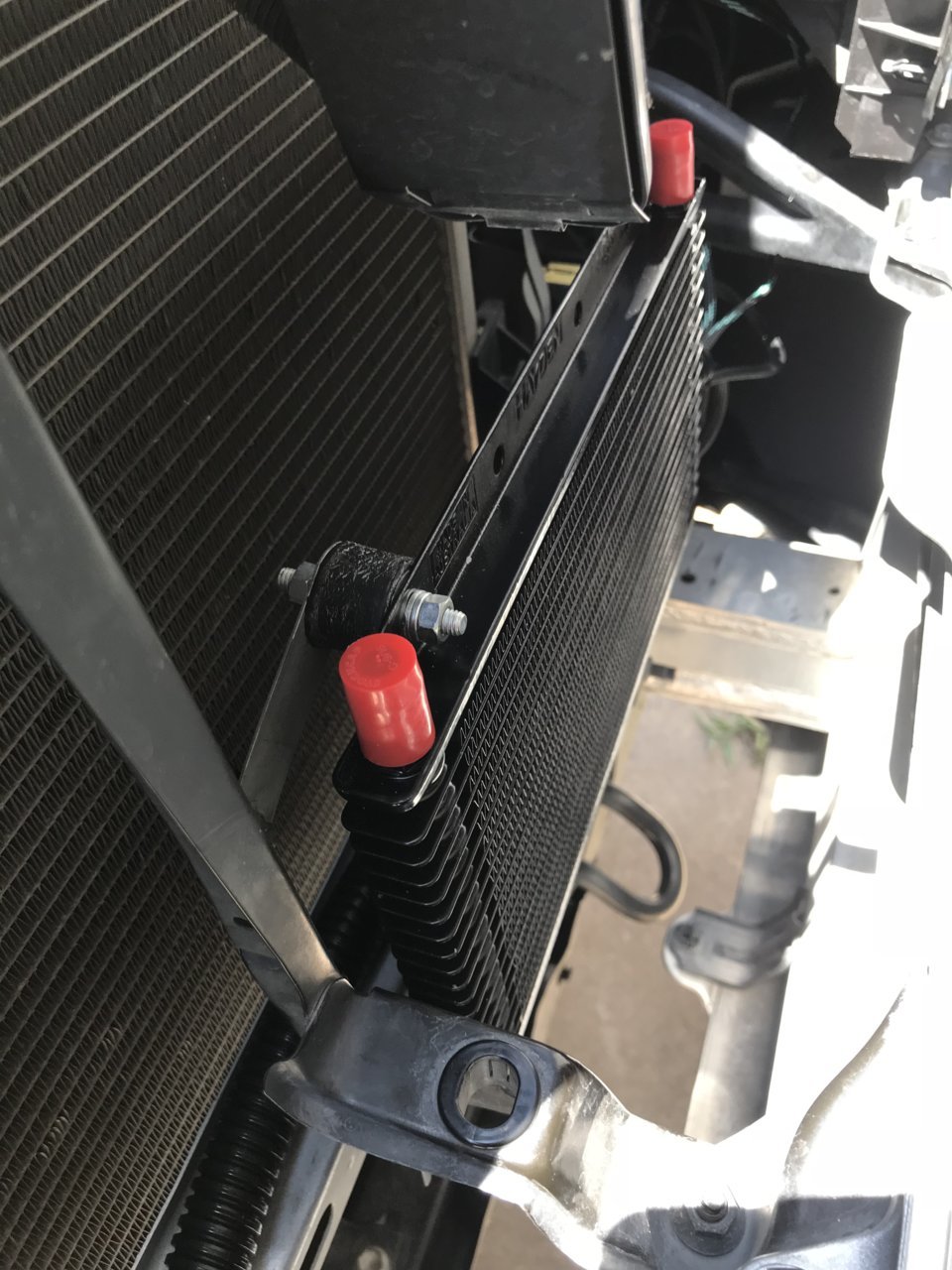

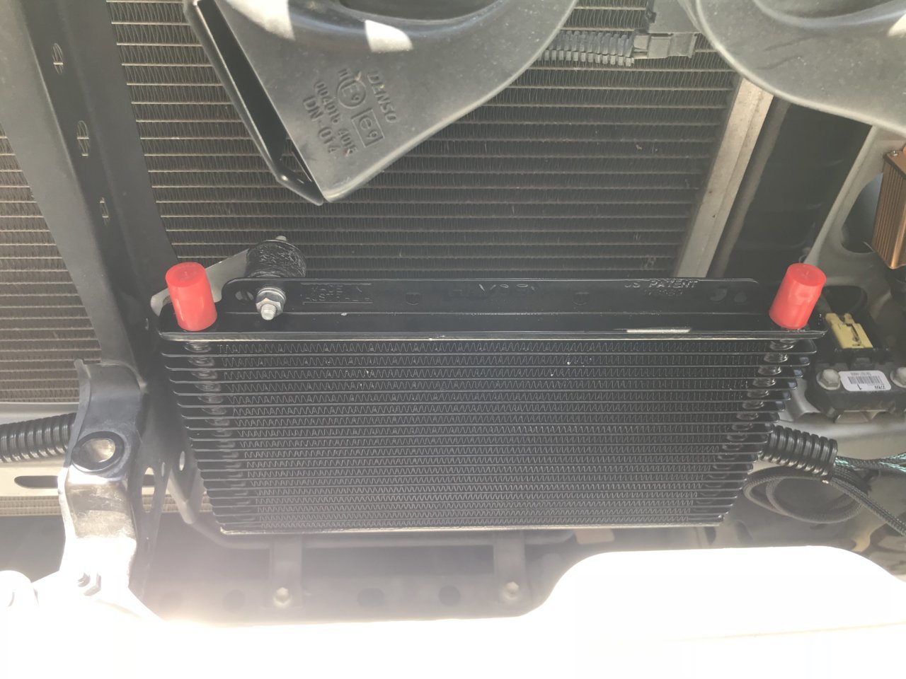

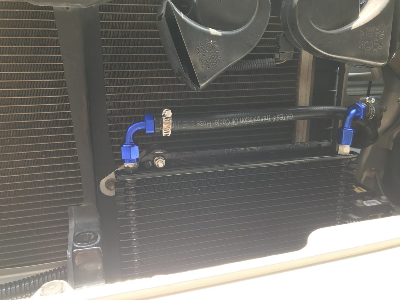

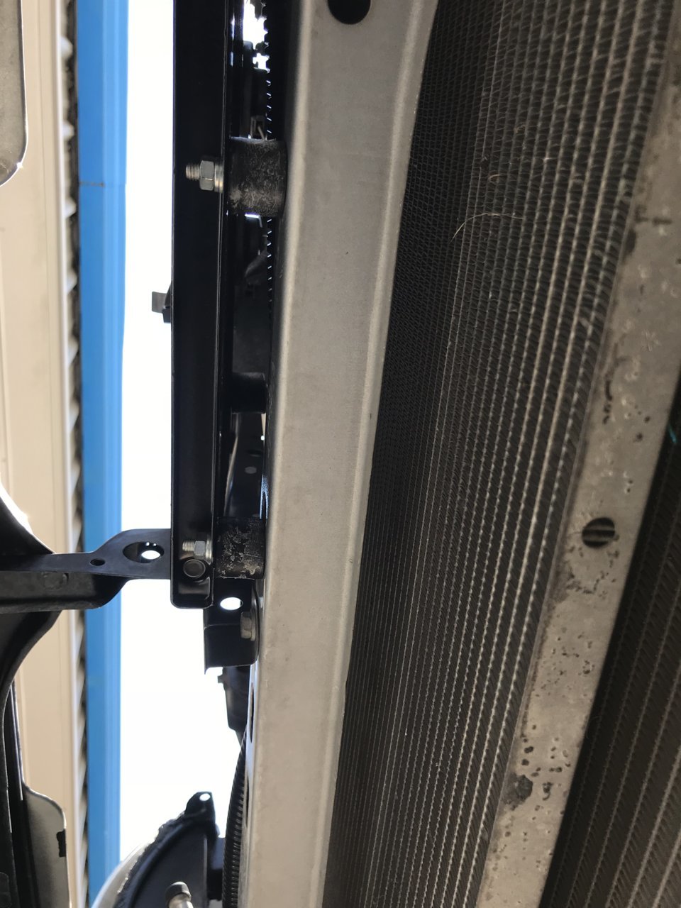

    Trans cooler is mounted. Waiting on custom 90* fittings to screw into the cooler and attach the hoses to it

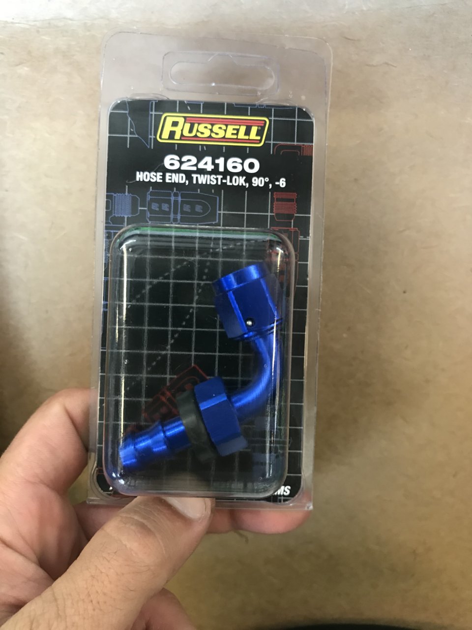

    One fitting showed up today, the other will be here tomorrow or Friday
    Russell fittings, a division of Edelbrock.
    If only they came in red lol

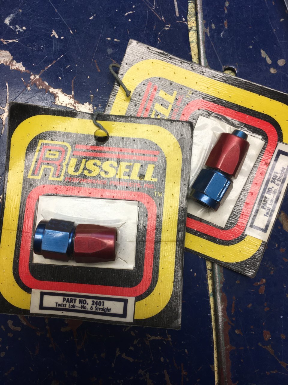

    The old Earls ones were Red & Blue. Still using them today.

    I may switch to those at some point, I like the blue but prefer red

    My Bad, they were Old Russel’s before the Edelbrock buyout.

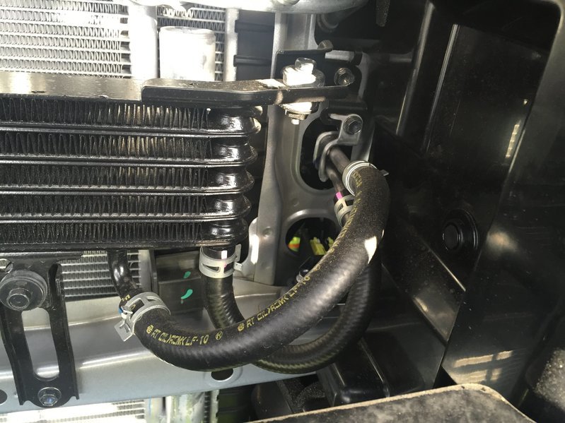

    Ok trans cooler is all hooked up, no leaks. Will see how she does on the way home tonight.

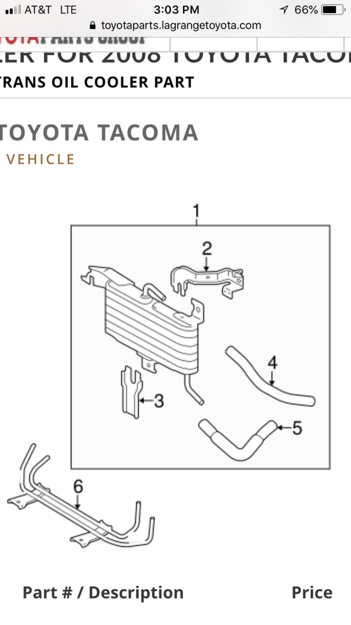

    Ordered a few factory parts to make it nicer for the hose setup
    I ordered bracket number 2 which bolts to the drivers side core support
    And the fixed line assembly that bolts to bracket number 2 and makes it where I won’t have the rubber hoses jammed into the side of the opening, and it will make it look factory
    #32906
    You can see what it should look like passing through the core support here with the bracket/line assembly I ordered

    I just didn’t like how the hoses laid over in the opening so I ordered those two items to make it look much better! And this Hayden trans cooler is twice the size of the factory oem cooler :D
    Edit: Hayden cooler cost me $56
    OEM cooler is $300
  18. Aug 3, 2018 at 1:28 PM

    Very slick! It's bound to help out!
