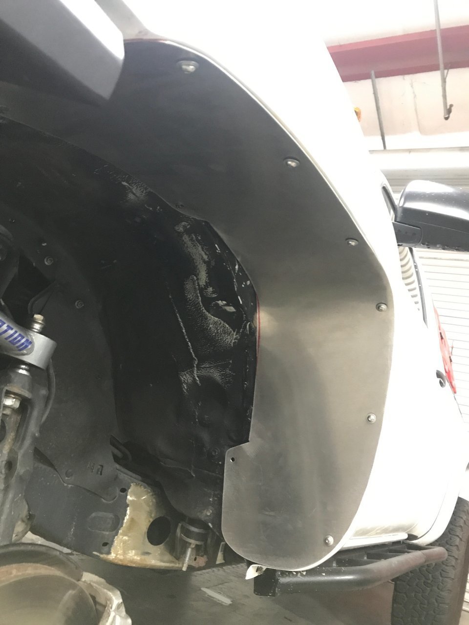

    You get the idea but there have been some really kick ass ones I’ve come across before that were made to seal it up with glass fenders

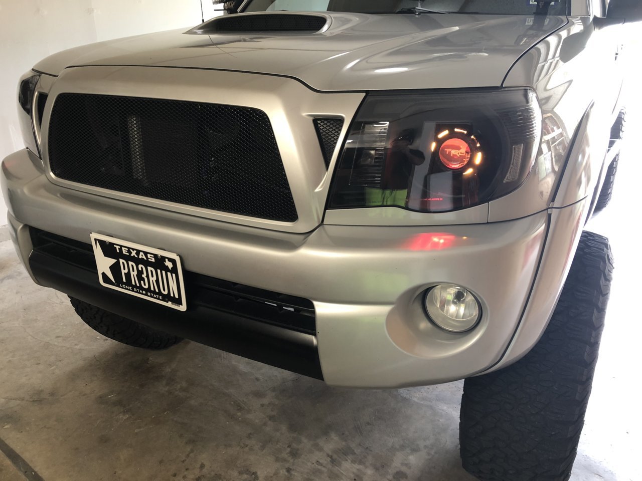

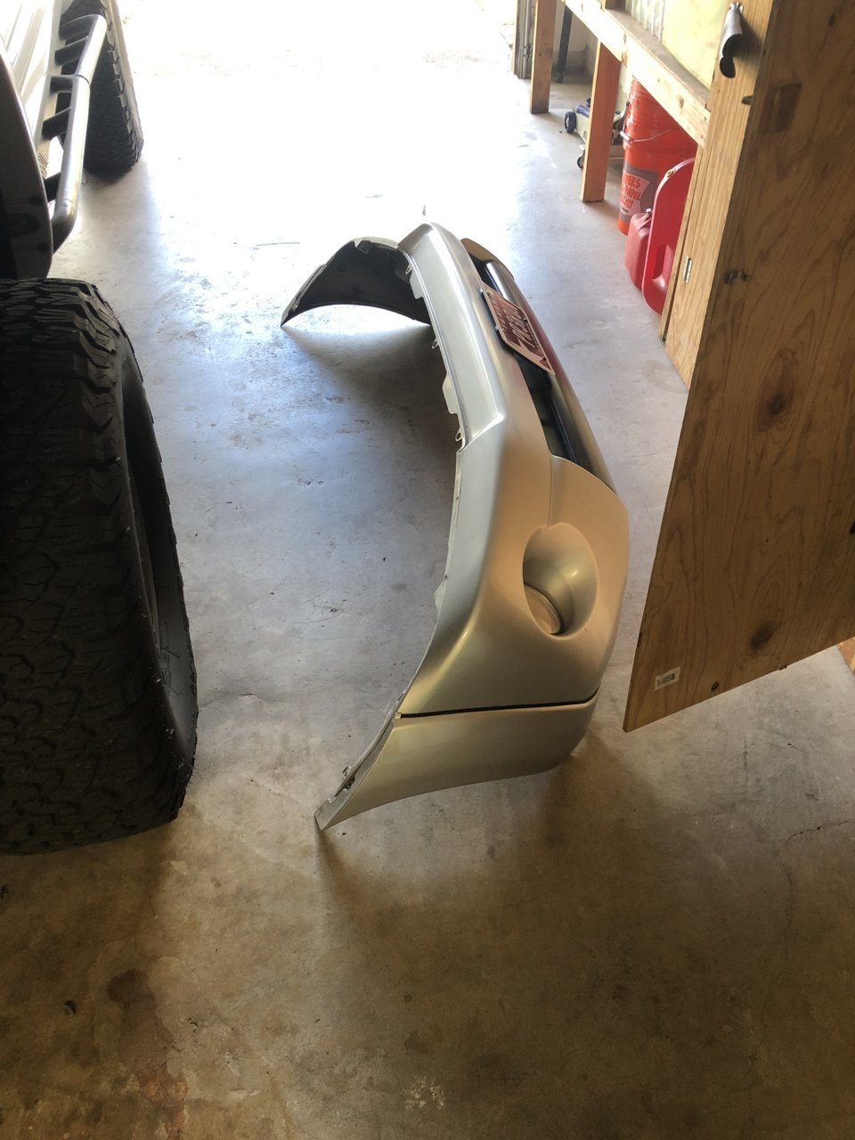

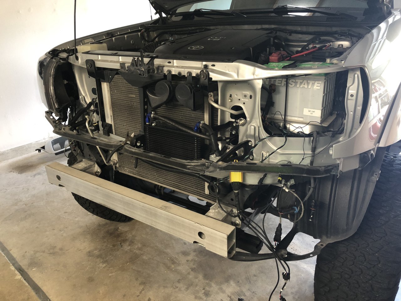

    Working with the retrofits to seal the one leaky one up better and redoing the wire routing, pics to come soon with the grillcraft grill

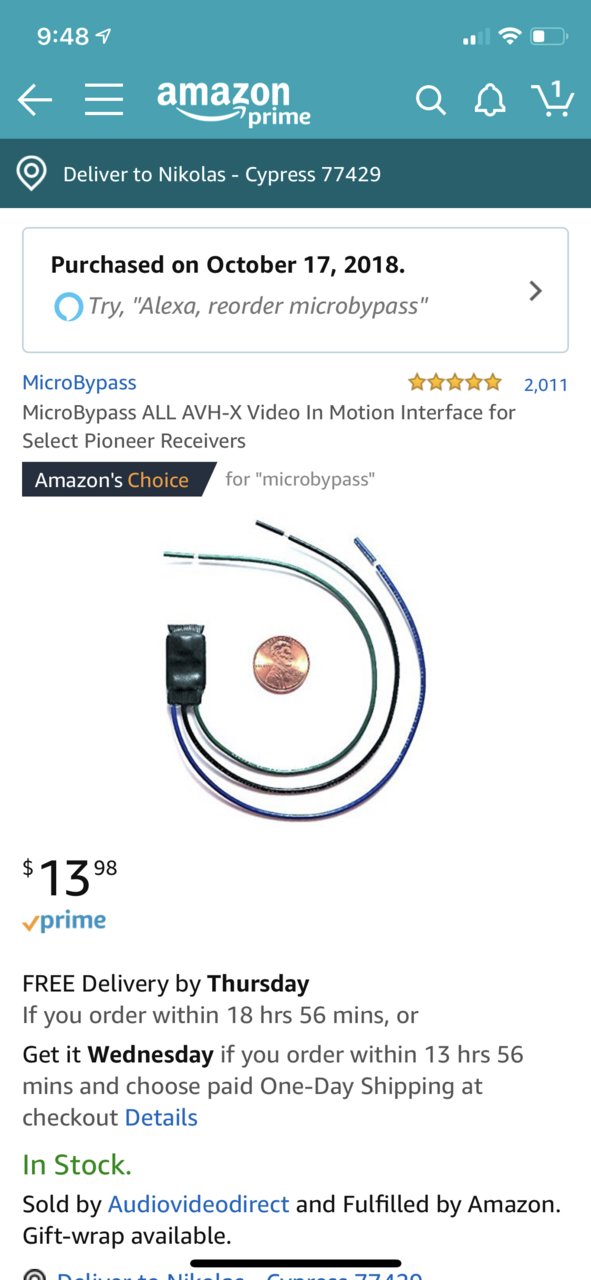

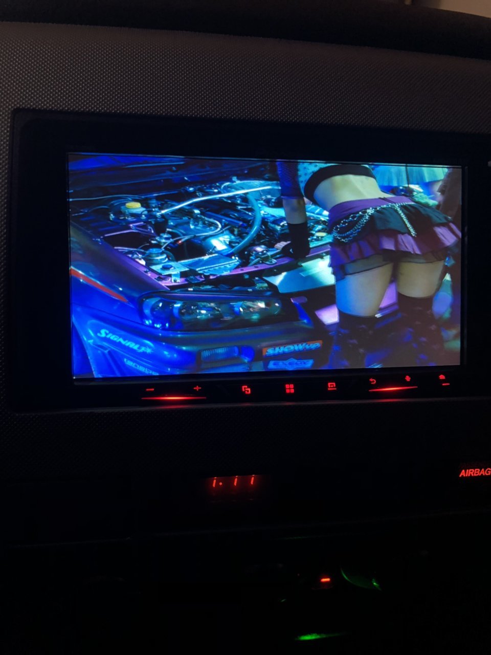

    Went ahead and wired in my parking brake bypass on my head unit tonight. Initially I purchased it so I can access the Bluetooth menu and some other functions but it also allows movies to be played too. I had to buy this bypass
    With newer head units you can no longer just connect the parking brake wire from the radio harness to a body ground, the newer radios want to see a pulsed signal and this creates that.
    And no I don’t play movies while driving but if I’m sitting somewhere for a while waiting this will be nice to use. It was extremely simple to install, I just had to cut out two but connectors and add two of the 3 wires in with them (amp turn on and ground) and the third wire goes directly to the parking brake wire.
