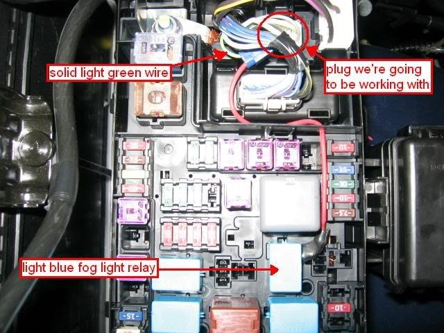

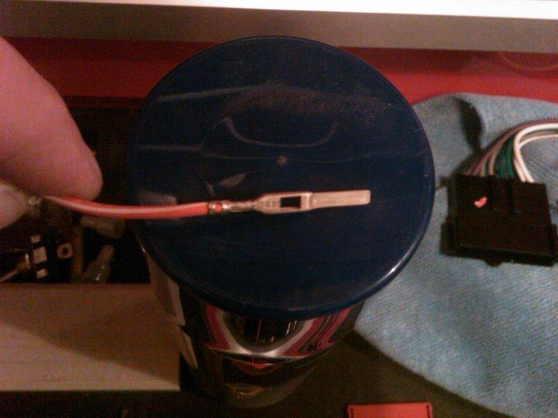

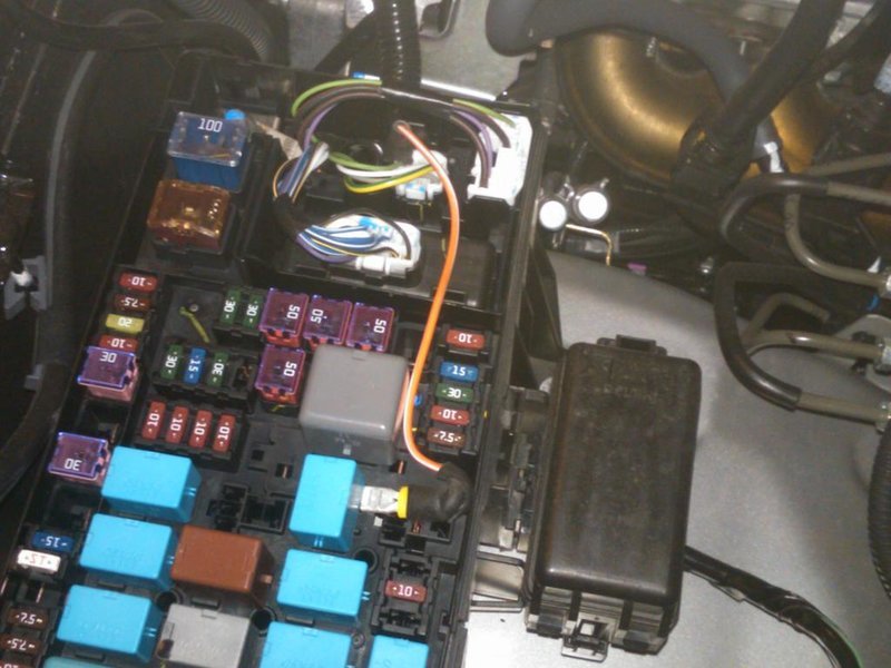

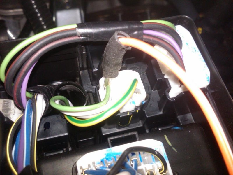

    I’ll see what I can find, and I may attempt my fog light anytime mod with this method I came across which requires zero splicing.
    Posting pics here for a later quick reference for myself when I do this. The guy uses a male thin profile blade connector from a stereo harness. It goes into the factory harness behind the ignition wire.

    Those are not my pics they were taken from another thread for reference for myself when I do this :D

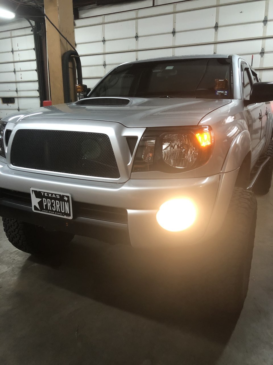

    Fog light mod accomplished!
    Until I change the thin blade to an add a circuit
