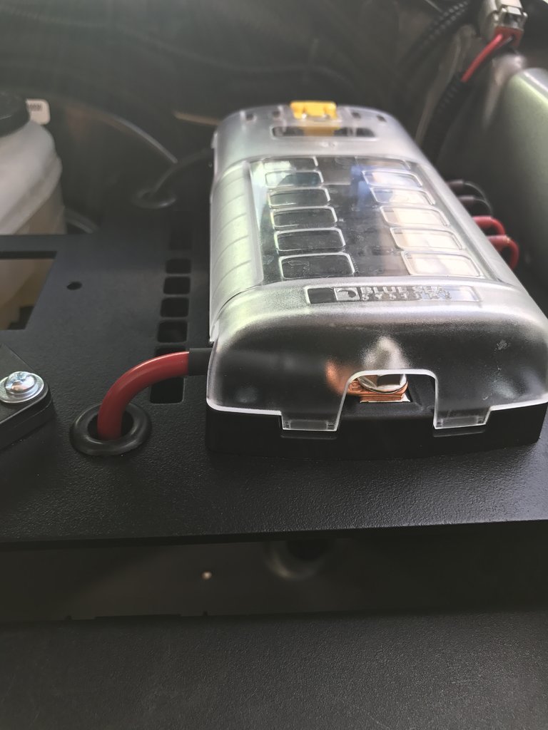

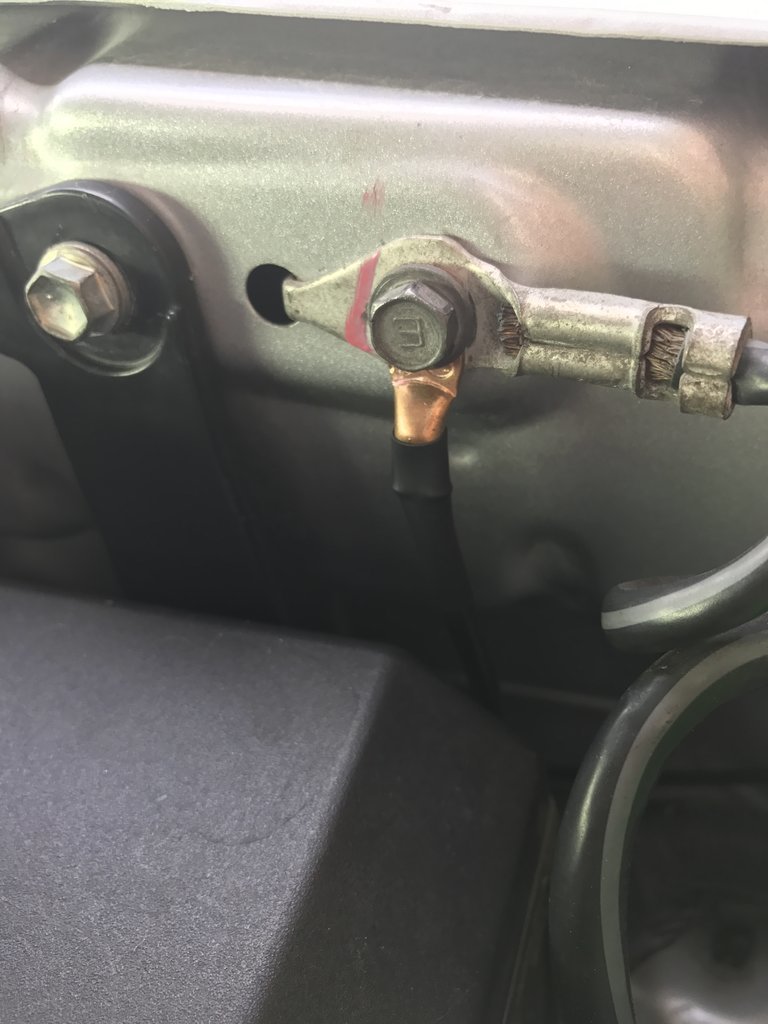

    Re-made the two positive cables and ground cable for the aux panel, this time with heat shrink :)

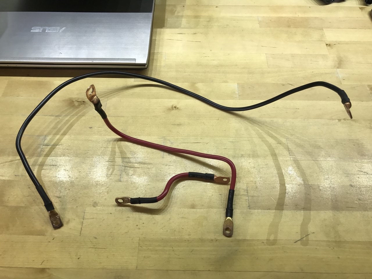

    I believe I can help Chad out since we both have identical setups
    I made 2 sets, I can send/give you the other one. It's 3 8g copper cables with heat shrink and copper eyelets. Battery to circuit breaker (+)/ circuit breaker to fuse panel(+)/fuse panel to body ground (-)
    I can also send pics of each wires short route and bends so you can get it done:thumbsup:
    Your set below, not pictured is 2 rubber grommets for the panel that power and ground pass through, just like I did
