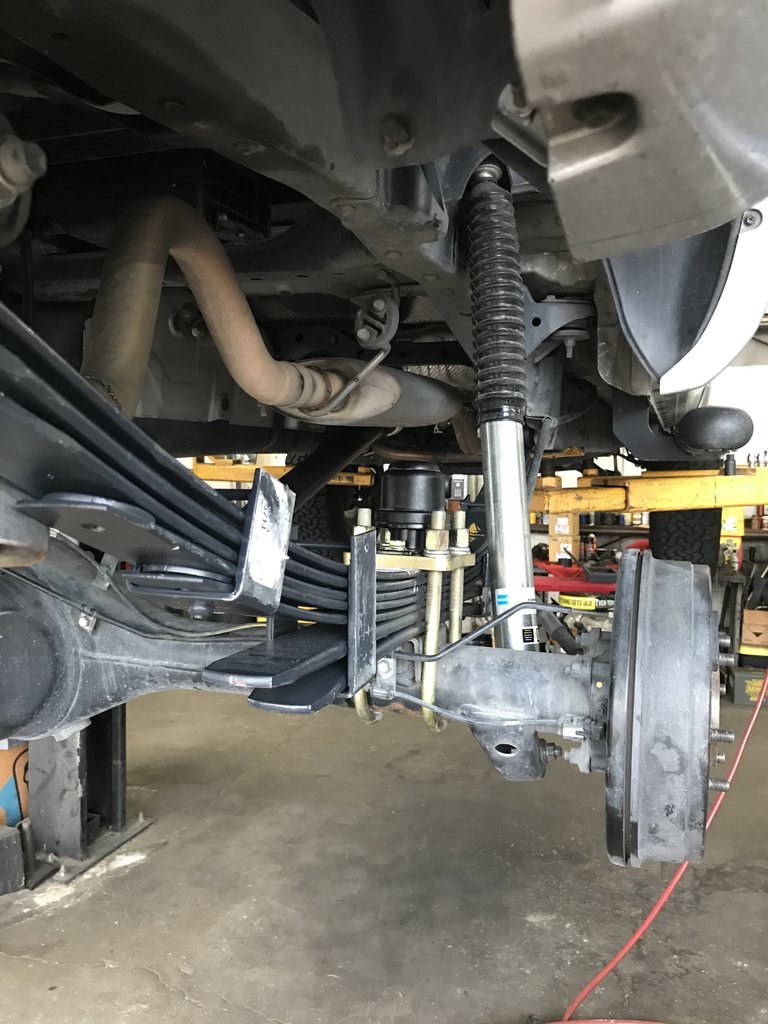

    U-bolt flip kit provides no lift, it's sole purpose is more ground clearance by the new plate being on top of the axle and the ubolt studs now facing up. And it looks much cleaner.

    @MarX here you can see the flip kit easily

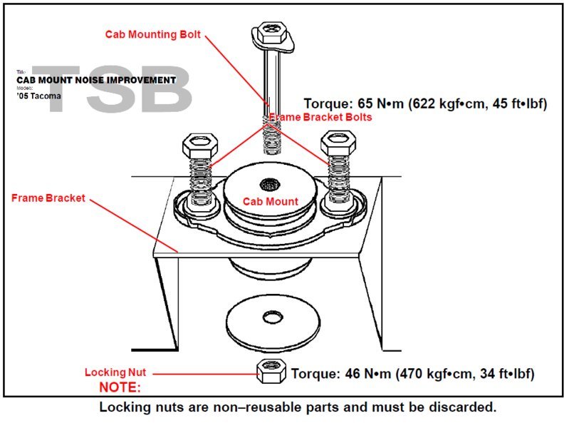

    A bunch a cool stickers, a bada ass MetalMiller Tx Longhorns grill emblem painted Hemi Orange, JBA long tube headers with o2 sims, Diff breather mod, Red LED interior lights, Fancy head unit that plays ipod n movies, Also DIY install factory stuff like, factory cruise control, factory intermittent wipers, OME nitro struts with 886x springs and toy tec top plate, JBA high caster UCA's for better alignmnet and dey beefier too, Old Man Emu Dakar leaf springs in da rear with the gear, U bolt flipper, Ivan Stewart TRD rims with 33" K Bro 2's, some bad ass weather tech floor liners so I don't muck up my interior, an ATO shackle flipper for mo travel in da rear wit the gear, also super shiny Fox 2.0 shocks back there too, all sorts of steal armor for bouncing off of the rocks like demello sliders, AP front skid, trans skid, n transfer skid, demello gas tank skid, and a tough as nails ARB bumper with warn 8k winch, I'm sure there's more
    Yes sir, gave that girl the extra inch she so desired. The washers that came with it were weak, so went to the hardware store n got extra thick fender washers for em. Only things to consider when installing is to do one side at a time to retain body alignment, mark and loosen the steering intermediate shaft, remove the splash guards from the body not the frame, and disconnect the wheel speed/ABS sensor wire from behind the UCA so ya don't rip it. Bed is easier, again, one side at a time. Torque spec for the body are hard to find and they weren't listed in the instructions from @ToyTec Lifts either. Lemme know if I missed anything. I think torque for bed bolts is 32ft#'s and the body bolts are in the pic.
