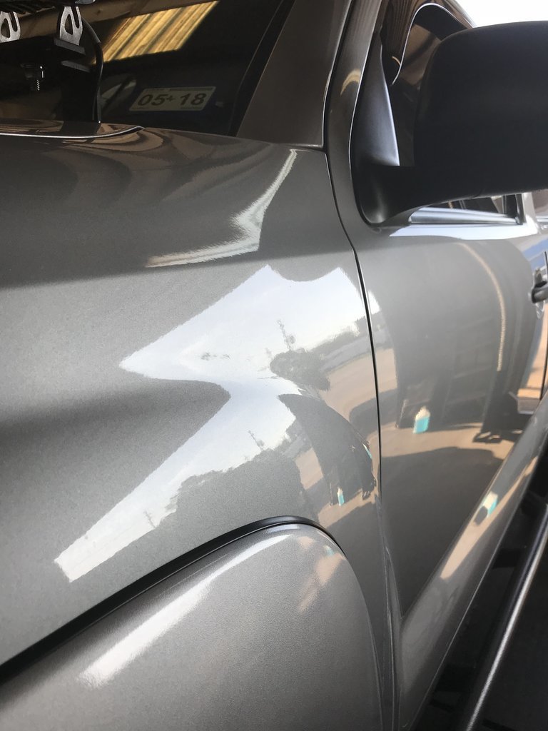

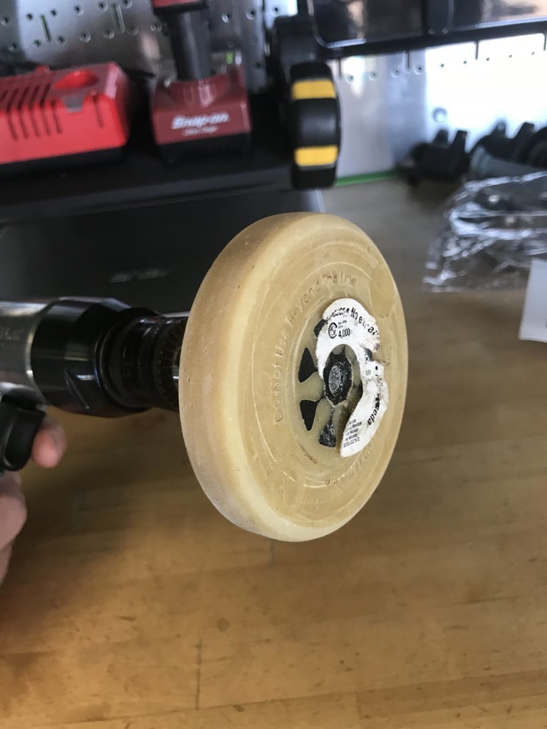

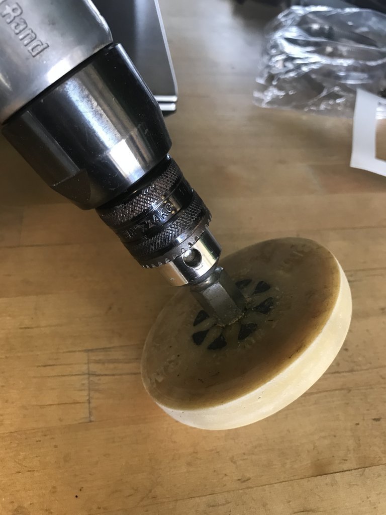

    Lol I used an eraser wheel on a drill (carefully working back and forth as to not sit in one place too long and go through the clear coat), and then hand buffed the areas with 3m compound and microfiber cloth before washing off.
    29FF3553-C576-49B7-9CC2-8B53DD0BE5A0.jpg BB969D45-AACF-4B1F-B01A-4C222B65F4CB.jpg 6B62BE20-796A-42B1-9EDC-D58FDDF333D3.jpg
    Can’t even tell they were there. Did that 2 years ago almost, so the pinstripes have been on for a while before removal.
