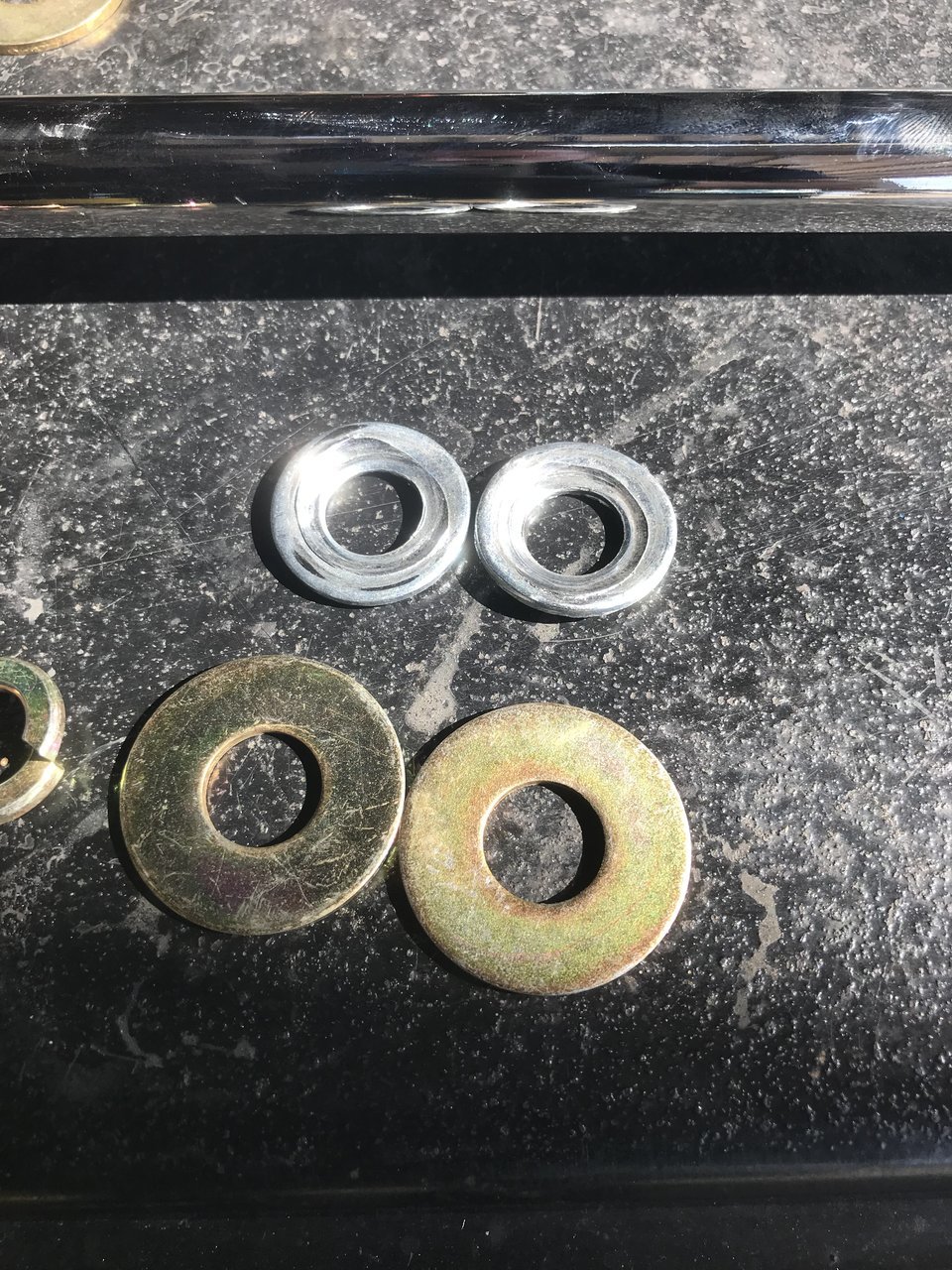

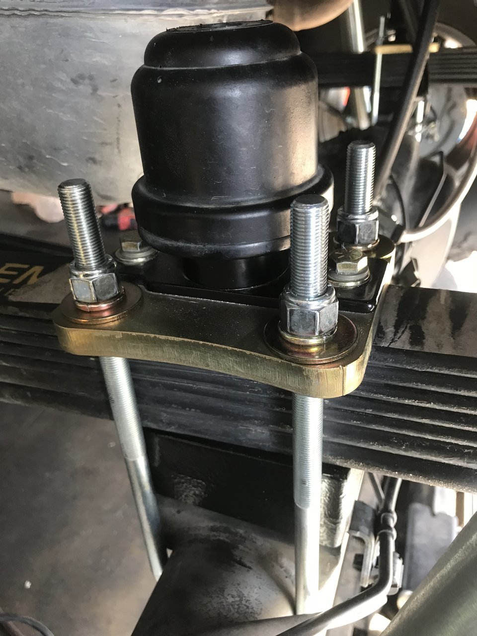

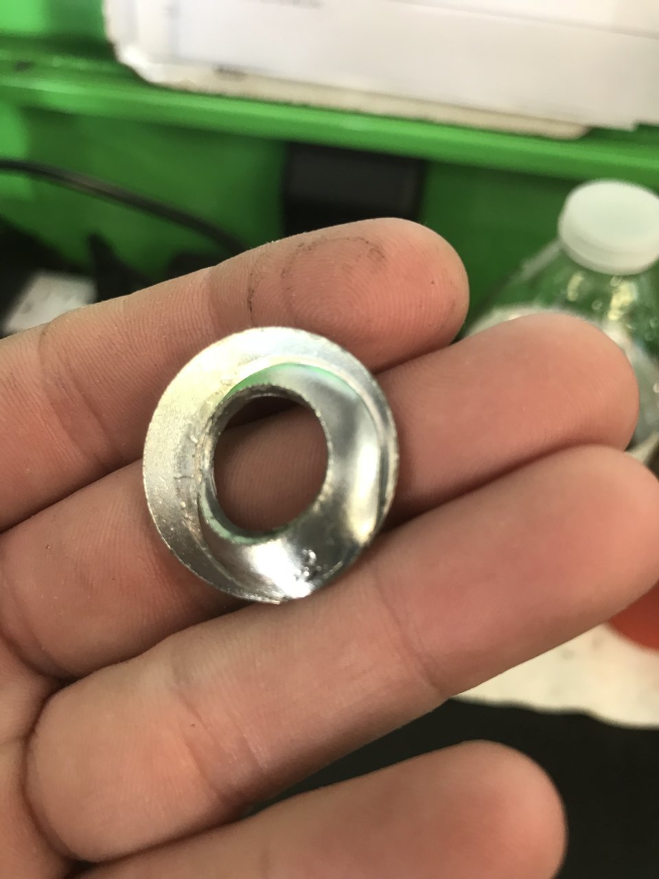

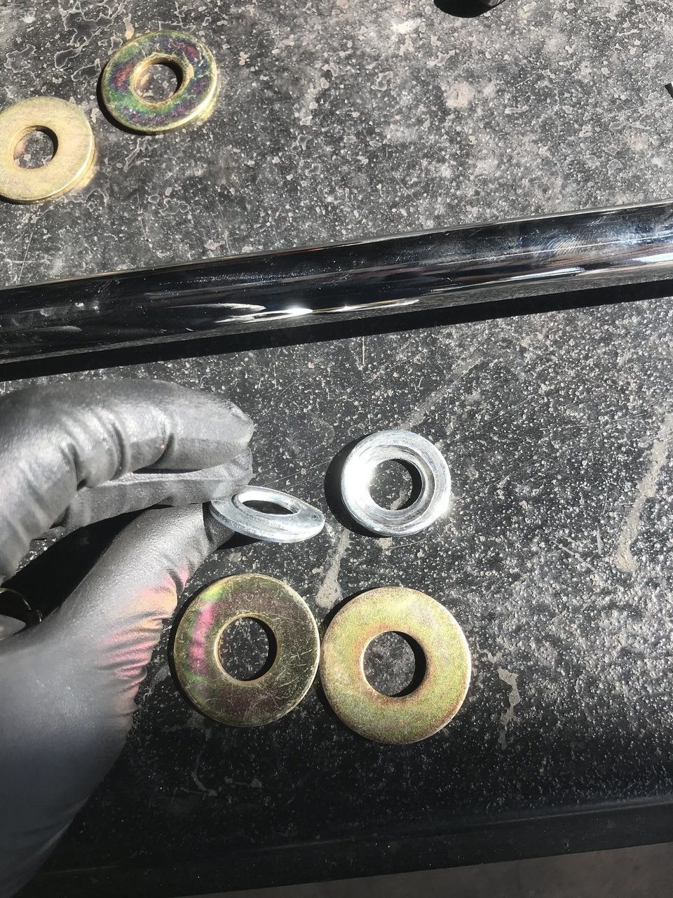

    Changed out the cheap ass grade 5 washers for grade 8. You can see what 100ftlb torque did to them
    Much better now :)

    100 ft lbs? :eek:
    Every thing I've seen says U bolts are only 73 ft lbs.
