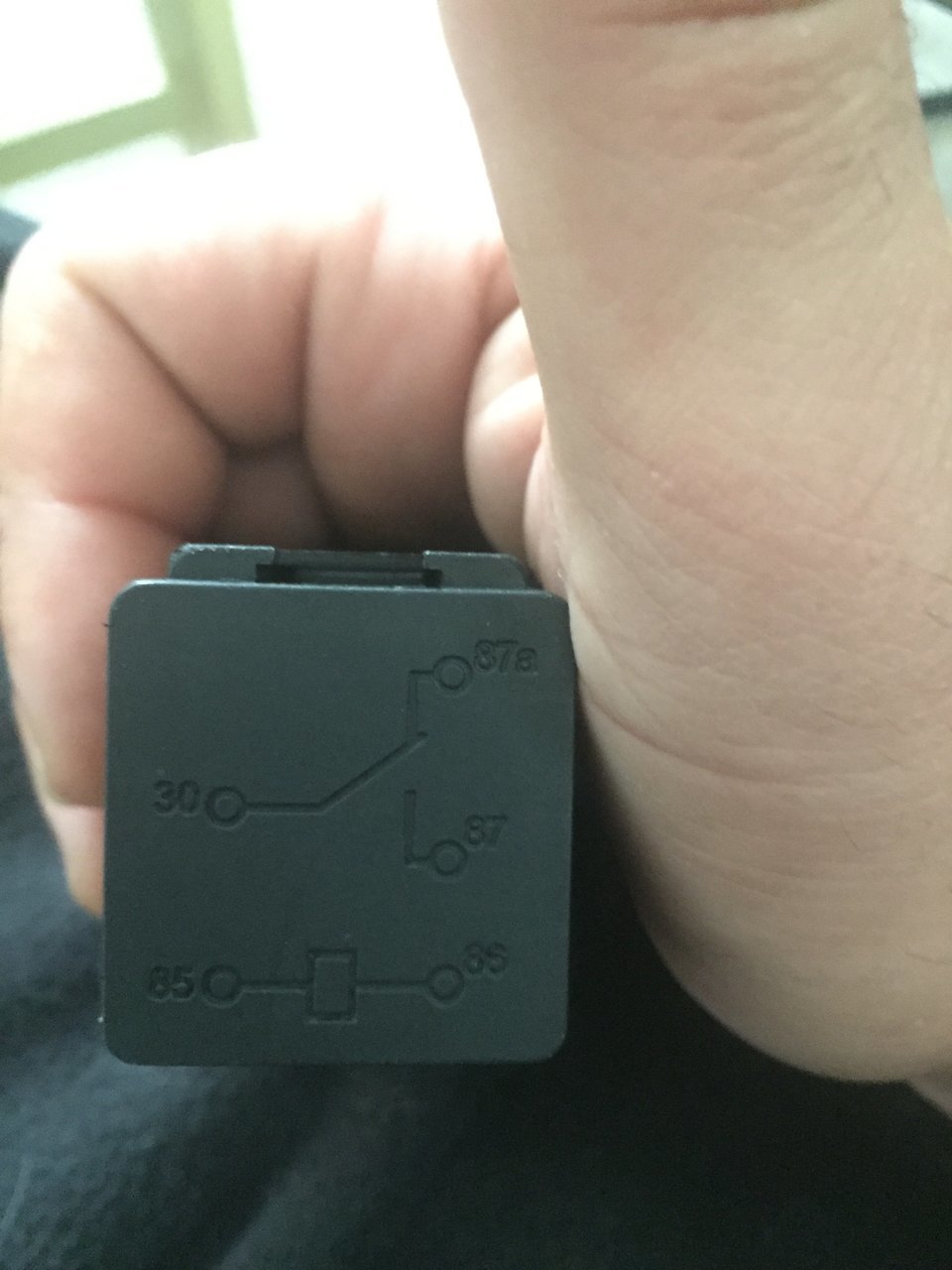

    The rigid relay is more compact and there aren’t the additional ring terminal connections for the switch, as it it is grounded through the relay ground.
    Comparison of the switches/terminals

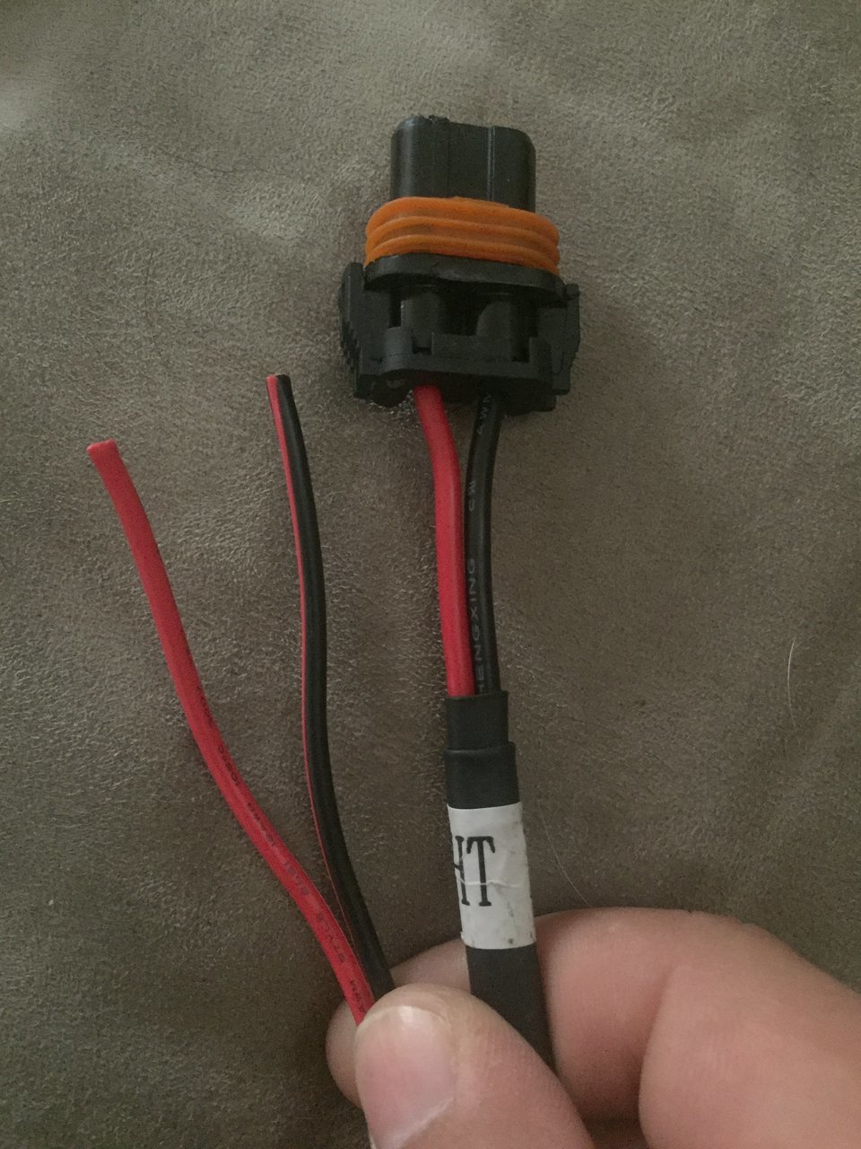

    The light bar connections are different, as the XTorch uses 9006 connections, but I could just clip and solder the light bar 9006 connector to pos/neg wires on the rigid connector. Correct?

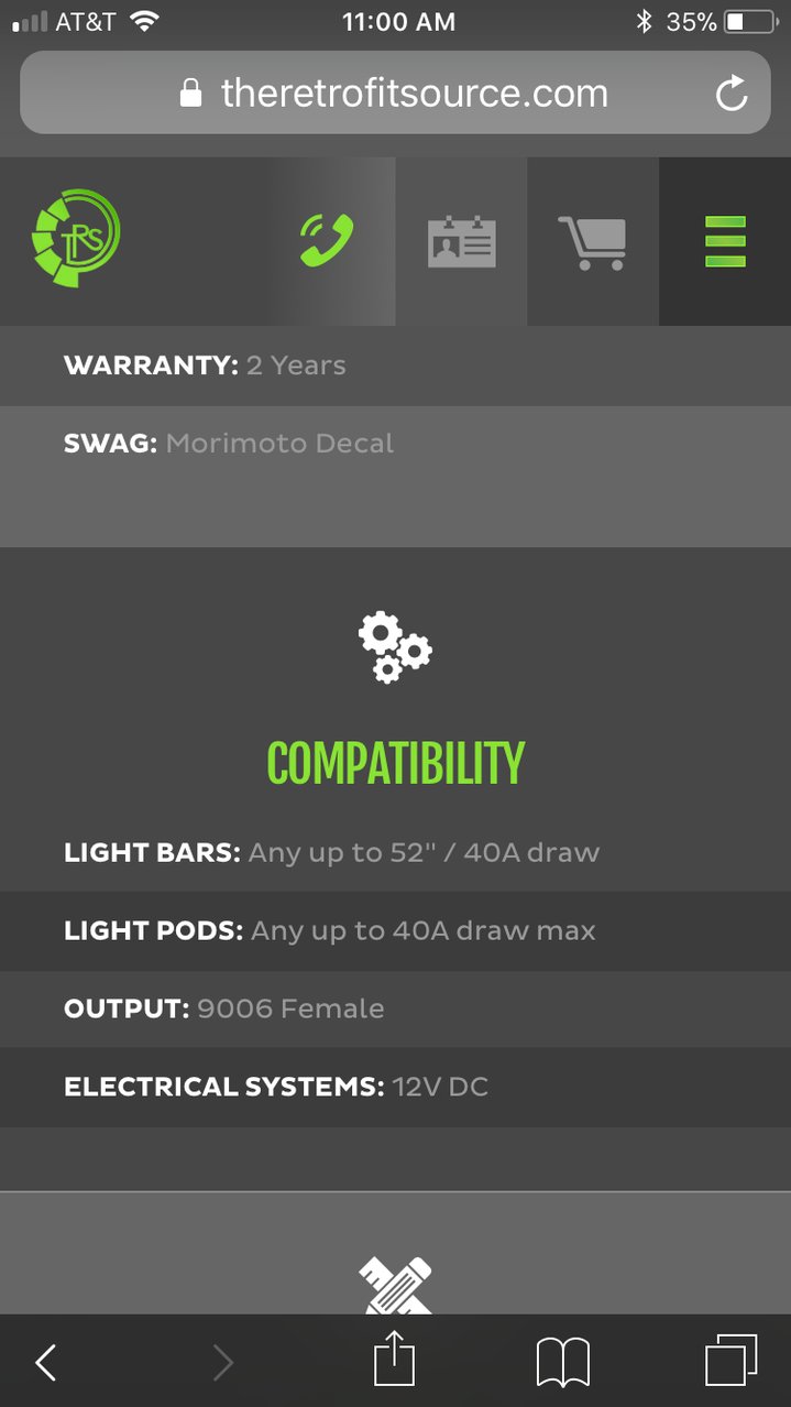

    The TRS is 40a 12v with a 25a in-line fuse.
    TRS Relay
    TRS specs-

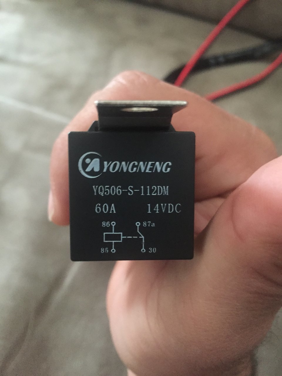

    The rigid says 60a 14vdc with a 15a in-line fuse.
    Rigid Relay
    Is there cause for concern if I use the rigid relay and solder the 9006 connector?
