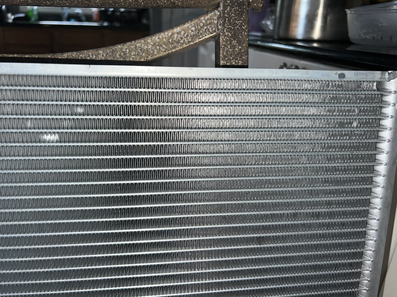

    Hey guys. This is the new UAC condenser from rock auto. This look ok looks like a few of the fins are bent… also, to remove the denso condenser how do you get those black plastic mounts off or do you not?

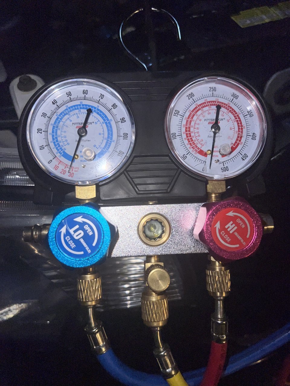

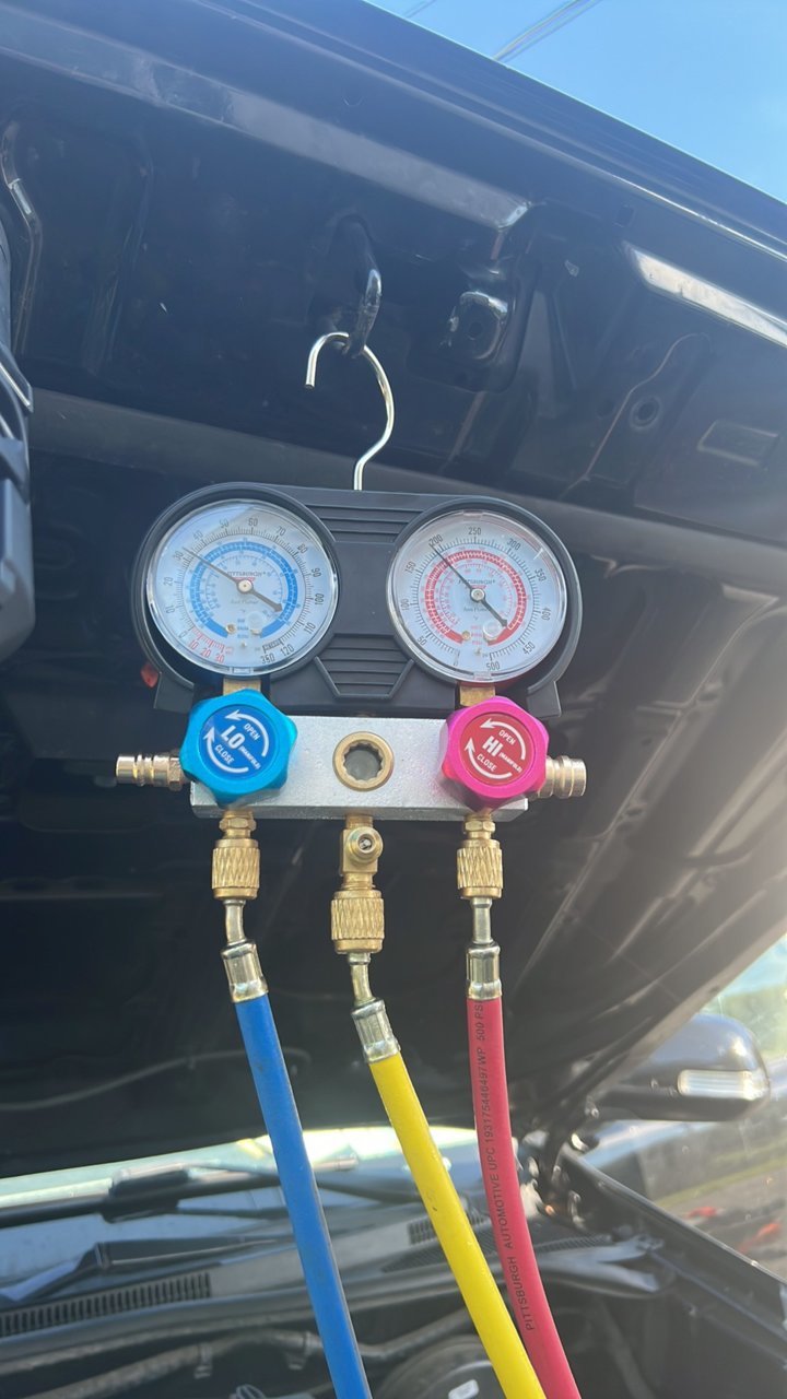

    So I correctly added one 12 oz can to my 2013 Tacoma I heard the compressor kick on its still on and my readings to me seem high for half of a load of refrigerant

    Usually I like to drain the oil that the compressor comes with and put in the same amount of pag. Some prefilled oil is only used for shipment and others may come with the correct oil.
    As for your gauge readings, they don't seem high at all. In 80-90* weather I usually see 35-38psi low, 220-250psi high.
    The more precise way to measure is to weigh the refrigerant bottle and to fill the correct predetermined amount as set by manufacturer into the system.
