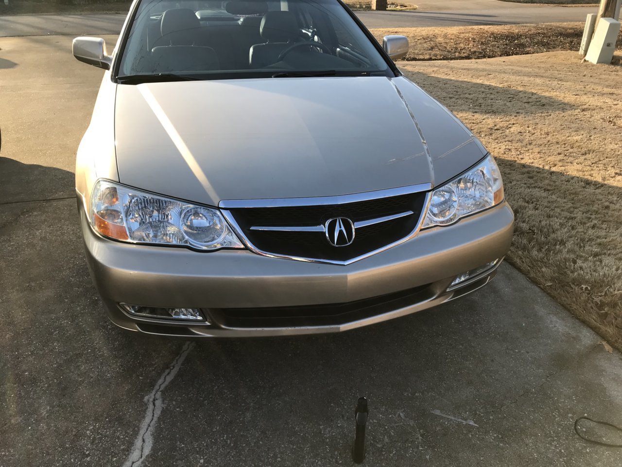

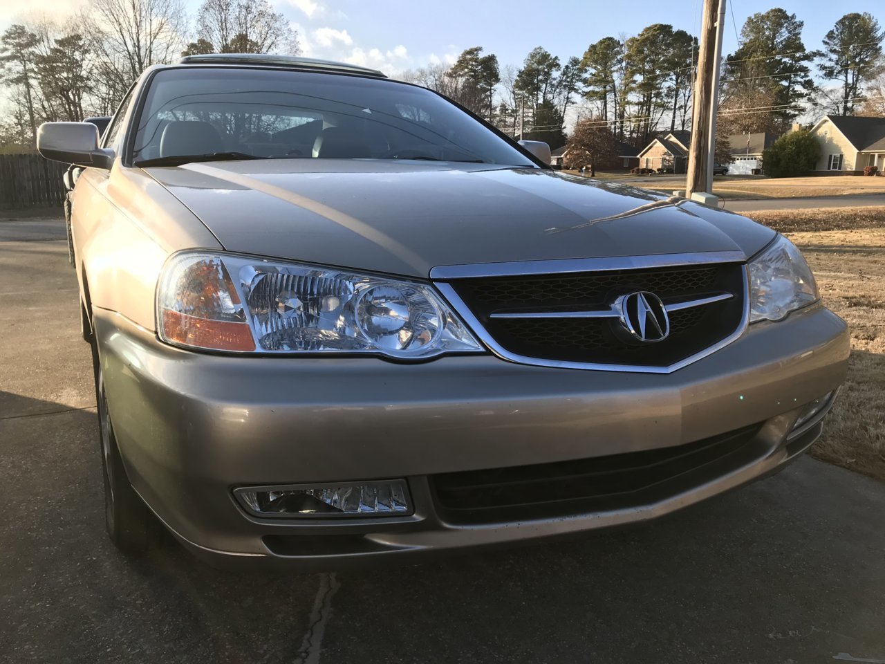

    Agree with everything except for this, which I must say is inconclusive, BUT I sanded/polished the headlights on my mom's Acura TL and then immediately put Lamin-x clear film over the headlights, that was about 6 months ago. So far so good but time will tell.

    Here were the headlights after I restored them. I spent A LOT of time on them.
    Also you're a little too close to the wall to judge cutoff. Standard is 25 feet.

    I know I was too close. I wasn't going for a certified headlight alignment. I'm the same distance in both pics. The relative difference is clear (pun intended, lol)
    My refurbished headlights looked just like that. Super clear, shiny... but the above light beam pattern shows there was no actual performance improvement - just looks...

    interesting. I will have to see what the beam pattern looks like next time I'm visiting. I do not recall any internal cloudiness or excessive glare though. Maybe something else in your headlights was jacked.. I've seen a handful of 1st gen Tacos with headlights that look super derpy when they are on. Not sure what was going on with them
