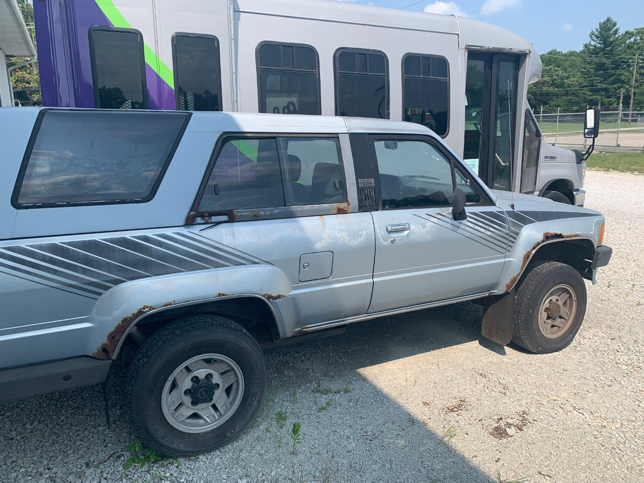

    4Runner is older than that, first gen ran from 84 to 89. I went and looked at an 88 recently that was a bit too far gone. I think the early 4runners were designed by Toyota to re-use the Hilux platform while avoiding the chicken tax. Adding the removable topper and rear seats let them keep making them in Japan but avoid the 25% import tariff. Hilux came first though.
