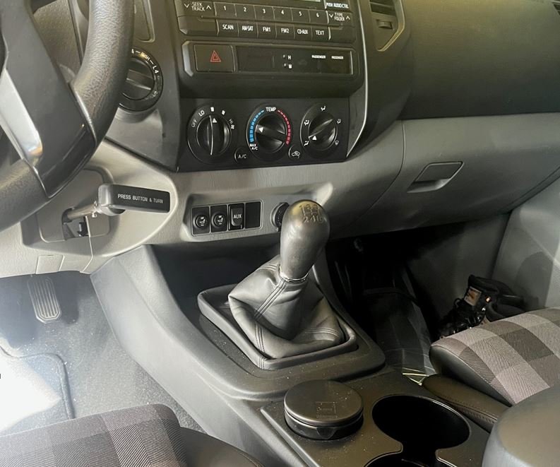

    OP, did you drill the floor for the base of the hand parking brake?

    That is correct. In fact the hand brake on the second gens is below the steering wheel on the right side,not by the console. Personally, I like this more myself as it is still out of the way.

    Yes I did. Drilled and tapped new holes.
