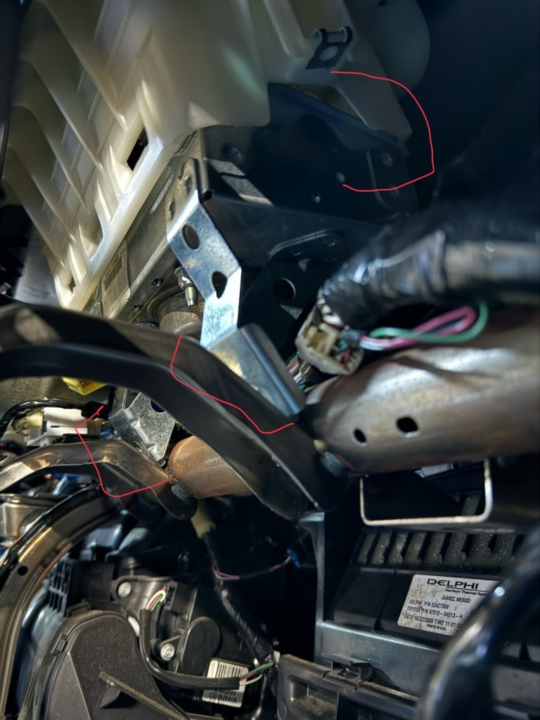

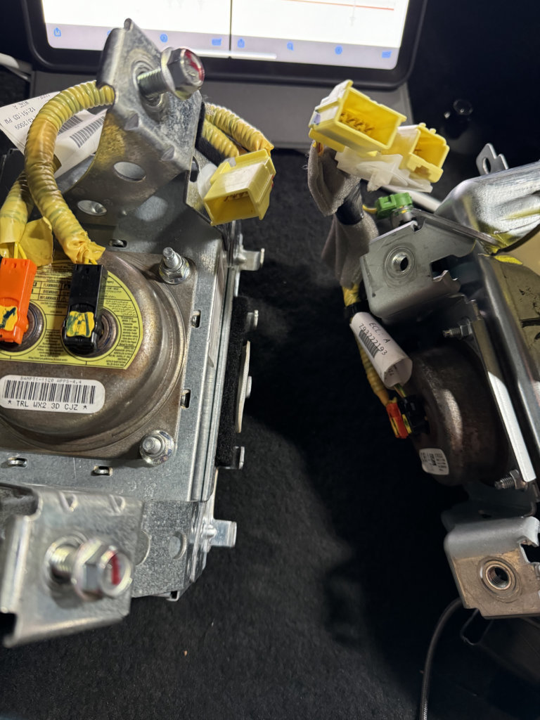

    Still considering which one I'll keep. Theoretically the 3rd gen connector should be able to be repinned to match the 2nd gen harness without any splicing (with the big caveat of not knowing the airbag internals, of course) but seems like the 3rd gen airbag would only be connected to the plastic dash since there's nowhere for it to mount to the reinforcement bar.
    I'm leaning going with the 2nd gen since it would have the metal brackets for at least some support in the event it goes off... Unlikely since I rarely have passengers but there'll at least be something if they decide not to ride in the rear seats
    Testing how it fits with it fully seated in the 3rd gen dash with the modification as OP showed. Wondering if my fit test above without the modification was causing the drastic angle difference

    I believe that the metal brackets that holds it in place would need to be cut off so the glove box can fit.

    I'm using the 2nd gen airbag. I'd rather not add more risk by using the 3rd gen airbag in addition to the altered angle... especially since OP had to bypass the seat airbags in his 3rd gen seats.

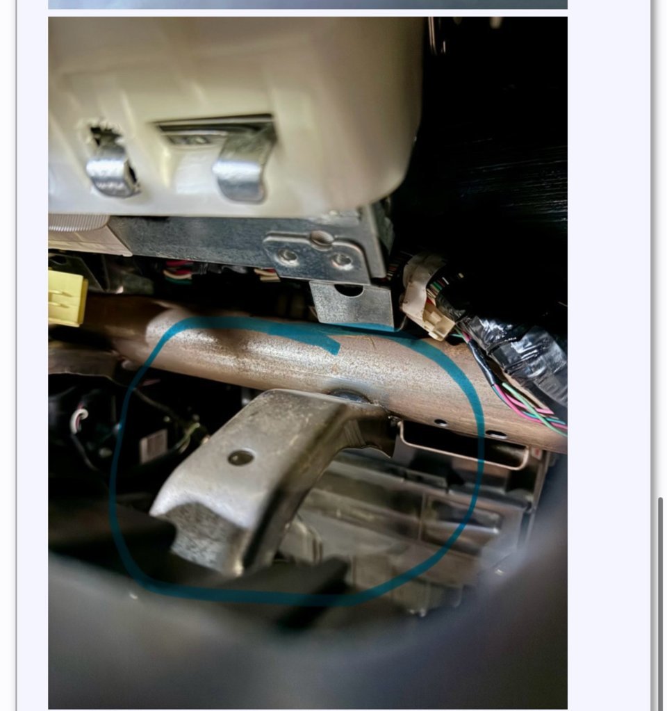

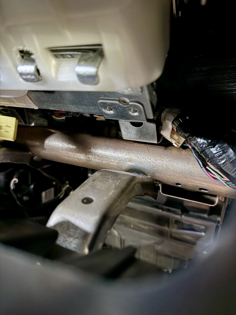

    2nd gen airbag fits after I modified the slot on the 3rd gen dash as OP shows but fits very tight. I needed to pull the wiring harness clips out of the support bar and push it back. The airbag brackets sit right on the support bar so I plan to drill into it to bolt the airbag down
    Do you have pictures? I haven't attempted the glove box at all yet.

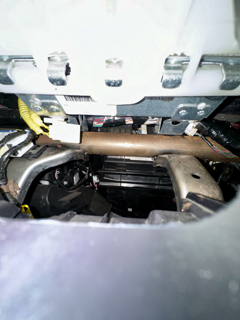

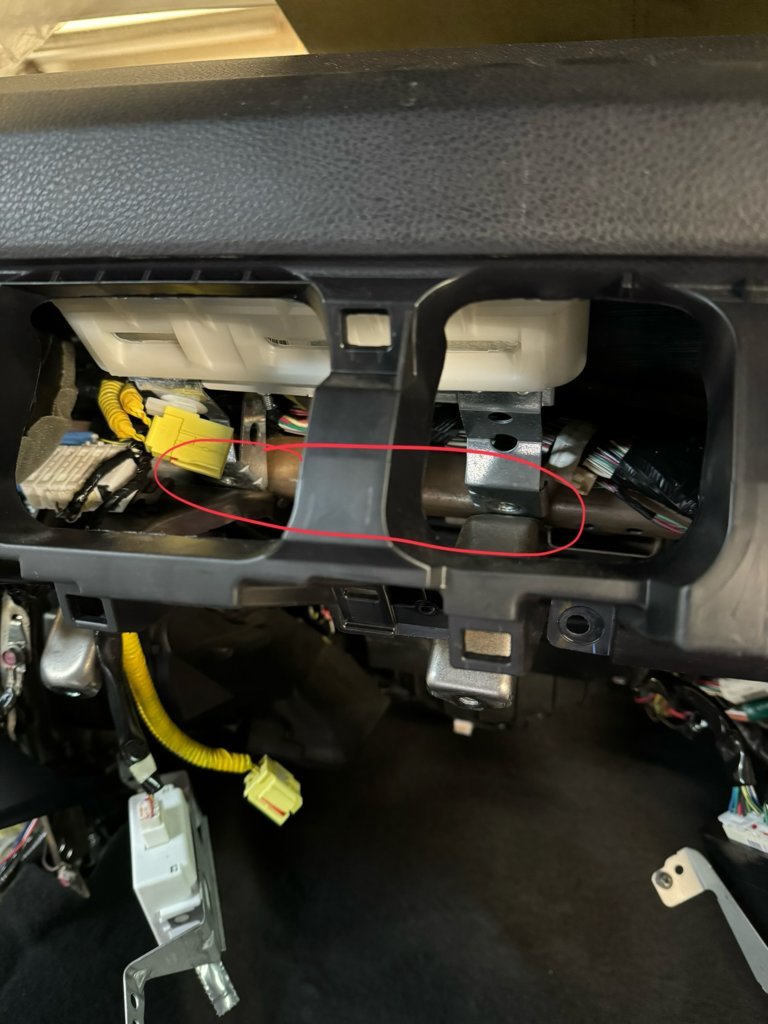

    IMG_8416.jpg Its this bracket that needs to be removed so the glove box can fit

    Yeah I assumed so from how the dash fits and those stick out, was just curious if you already had it done

    I ended up using an air chisel on the welds. Worked great

    to solve this issue I made custom brackets and welded them into the angle they needed to be.
    I know another guy who did the swap just bent the brackets to fit which isn’t the most ideal way of installing it but nevertheless getting it in there…
    As for the plugs there was no need for me to repin since I used the 2nd Gen airbag is what I was saying.
    it also was going to cost me $300 for the passenger side air bag which is more than I paid for the entire interior :rofl::rofl:

    It’s easiest just to cut them off and make new ones for the air bag.
