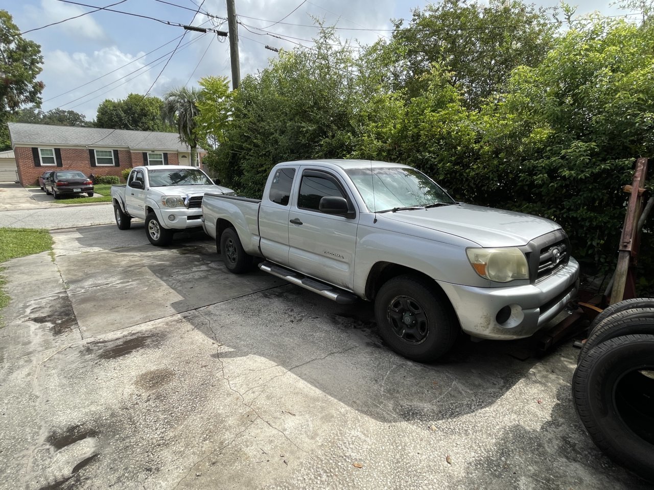

    Tacoma i4 to PreRunner V6
    Has anyone ever did it before ?
    I have a i4 with a trashed engine. 2008
    and I have a really nice 2011 PreRunner that’s a certificate of destruction.
    I’ve already started the swap and about to set the i4 cab on the V6 chassis.
    does anyone know what little things from truck to truck that will need to be swapped over ?
    I’m thinking at least the ecu and maybe the steering wheel and ignition to match the immobilizer.

    Wiring harnesses and some of the electronics will no doubt be different, alot of things changed electrically between 08 and 11.
