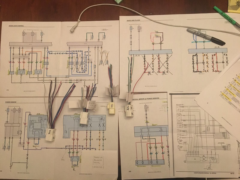

    I bought the door components of an '04 Limited to adapt them to work on my manual doors in my '98. I took both complete door harnesses, and cut off the 2 connector pigtails behind each kick panel to solder wires to. So far, it's involved me staring at wiring schematics and the factory service manual for hours upon hours, and weeks upon weeks trying to figure out what each of the almost 50 wires connect to, and do.
    Since I'm bypassing the integration relay and factory computer modules (since I don't want to re-run the entire length of the truck's factory wiring harness) I'm using a Viper keyless entry system to control the lock actuators, while the integrated circuits present inside the master controller switch and mirror master switch will control their respective assemblies.
    It's a lot of tracing wiring diagrams and schematics, testing the computer module with the parts, and just seeing what would and what would not work. Trial and error basically. If you're good with soldering wiring & components go for it. I might need to fabricate a custom PCB to control the factory lock actuators since they're supposed to be controlled by a separate keyless entry module. It's really just seeing where each switch & signal leads to, and where +/- 12v goes to.
    Here's my progress so far: (huge cluster-f to be honest with you)
    Dalandser and Toyota4x4#3[OP] like this.

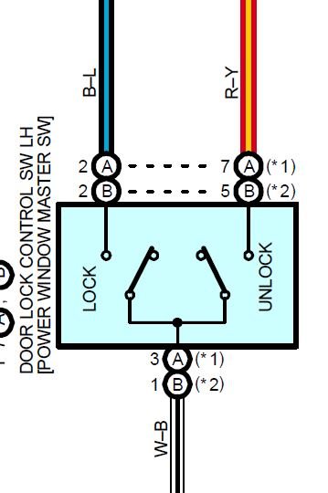

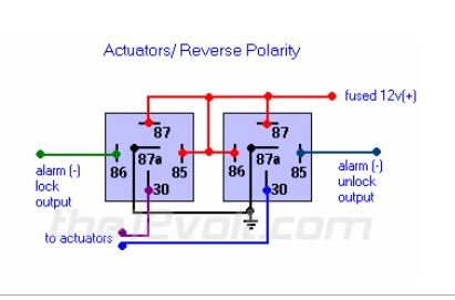

    Door lock uses a ground to either lock or unlock. To 25amp SPDT relays wired like in the picture will control the locks. Just replace the alarm input with door lock switch.inputs.
    GROUND the black and white, run black and blue to one input of relays and red and yellow to the other input.
