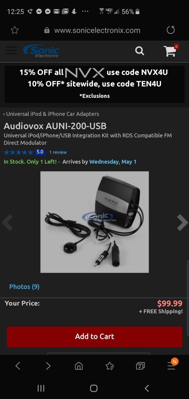

    Factory stereos only have so many inputs to offer. One is the aux Jack which you're having problems with (a common problem on these trucks). Another input COULD be a factory CD changer input, I don't know your exact stereo (I got out of stereo business in 2008) but I seriously doubt it has a factory CD changer input. The only other input on ypur trucks stereo is its stereo antenna. You can use a device like the one pictured to get it to do what you want. It's called an RF Modulator. It turns your iPhones audio signal into a frequency the stereo understands on its antenna input. It's not an ideal set up but it will work. You will have to tune your FM stereo to a specific pre-specified frequency in order to hear the audio coming out of your phone (usually 87.9 or 88.3).

    I figured that it would take a lot for it to work. I'll just replace the aux port and use a Bluetooth to FM thing.

    The way I presented isn't very much work. The other way presented (I think Dustin was his name?) will give you a better outcome but it's more work and not just any shop will do that type of work.
