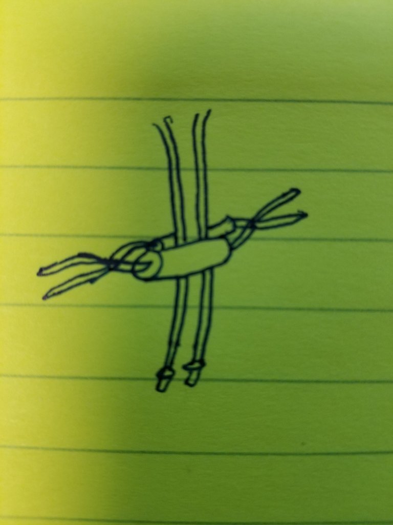

    10mm flare wrench. DOT3 Brake fluid. Super simple. I recommend clamping the stock lines with 2 lengths of steel tube and a couple pairs of vice grips so that the lower lines can be disconnected first and no fluid will run out. Once clamped, disconnect one of the lower connections and immediately connect the new line. Then undo the upper and immediately connect the new line. Repeat for the other line. See cave drawing below:
