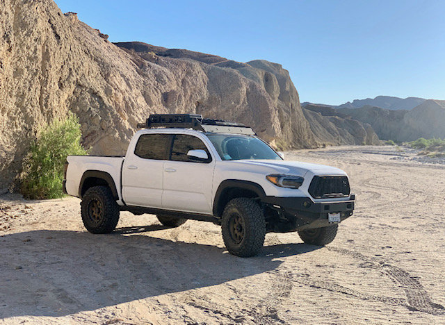

    I am getting ready to pull the trigger on swapping out the 600lb coils on my 2.5 extended travel Kings with adjusters and going up to 650 or 700lb coils. Seems like most people are going to 700lbs, regardless of their setup, but I am not trying to make the on road manners complete garbage.
    I currently have an AGM battery, a steel plate front bumper (140lbs) and some sliders (130lbs) with no other significant weight added towards the front of the truck outside of that-- and no plans to add anything else in the near term.
    I know this is all preference, but since my setup is so common I assume there will be some opinionated answers. Thanks in advance for any info/opinions!IMG_6183.jpg
